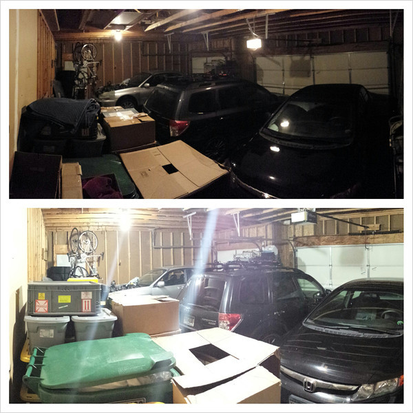

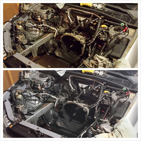

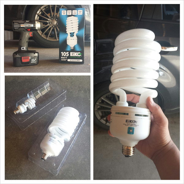

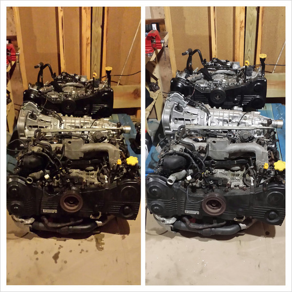

    I got these bulbs yesterday! They are HUGE! I expected big, but they're really big!
    The lights they replaced were actually 15W CFL's. Not sure the color temp, but much more yellow thank these 4100K lights.
    The light output is very strong, and they turn on instantly (faster than the little ones I had).
    Here are some comparison photos of the old lighting vs. the new. These are all just auto camera-phone (GS4) settings, no editing.
    Hard to get an accurate feel of the lighting just from pictures, but it's certainly a noticeable change in the right direction. Should be enough to hold me over until I can get some more fixtures in. Thanks!

    Does the packaging on these give the lumens?
  11. flstffxe
    flstffxe Well-Known Member
    I take they pass the test?
    I said they were big:).
    The little standard size CFL in the EIKO package looks like a baby shoe inside a clown shoe.
    For the price and being a plug and play shop lighting upgrade it is hard to beat. Much less work than hanging fixtures. 4 in a 2 car garage would be fine and 6 in a 3 car garage would make for nice shop lighting.
  12. flstffxe
    Not that I recall seeing it on the package but it is listed on the manufactures website and I have found www.1000bulbs.com to be fairly reliable with info.
    ~6900 lumens
