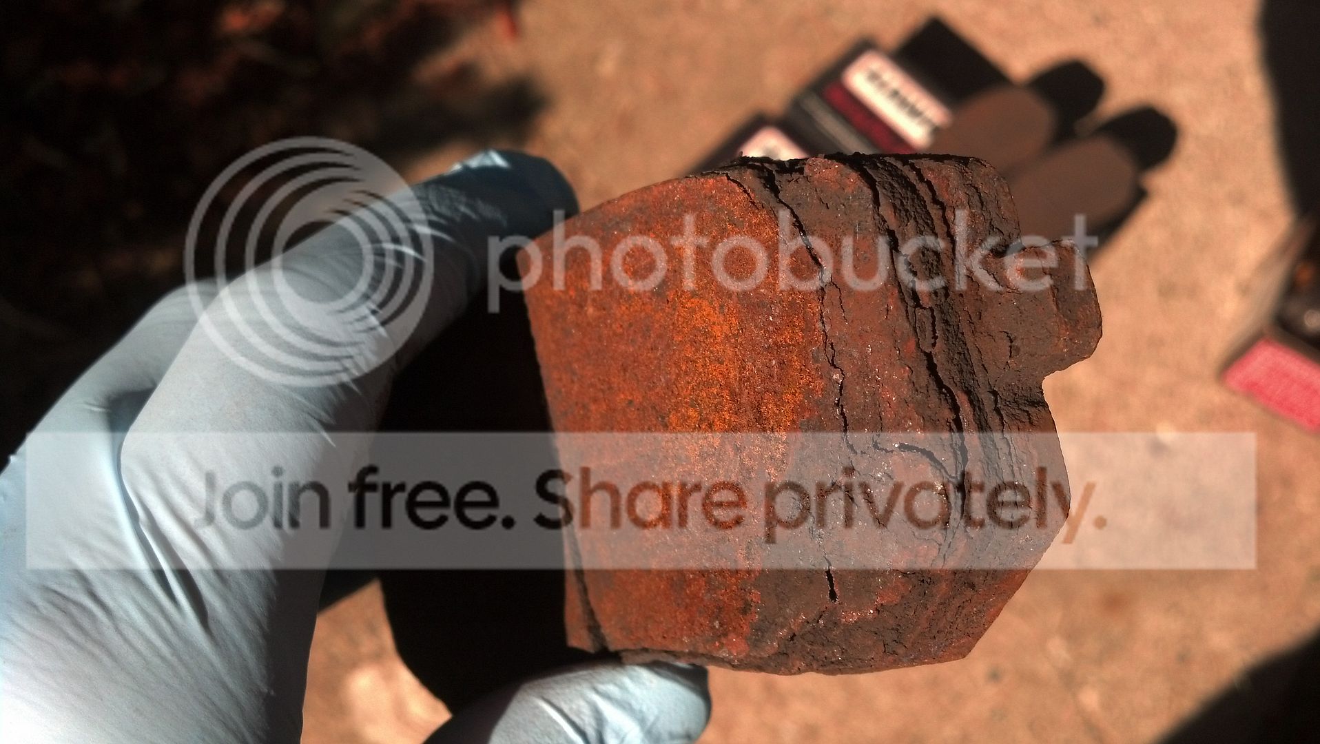

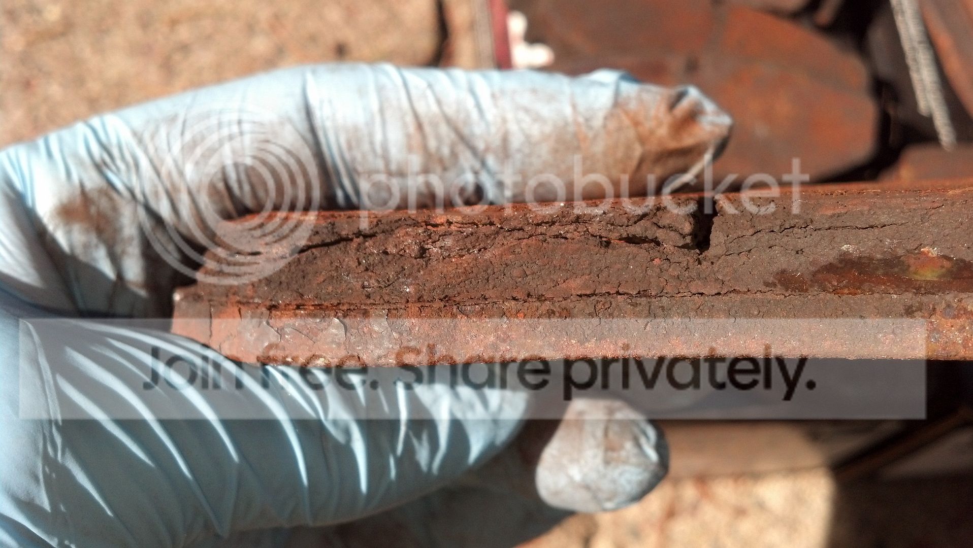

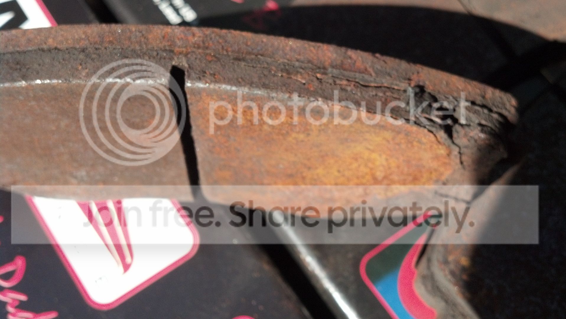

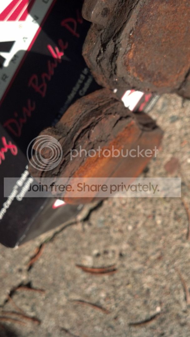

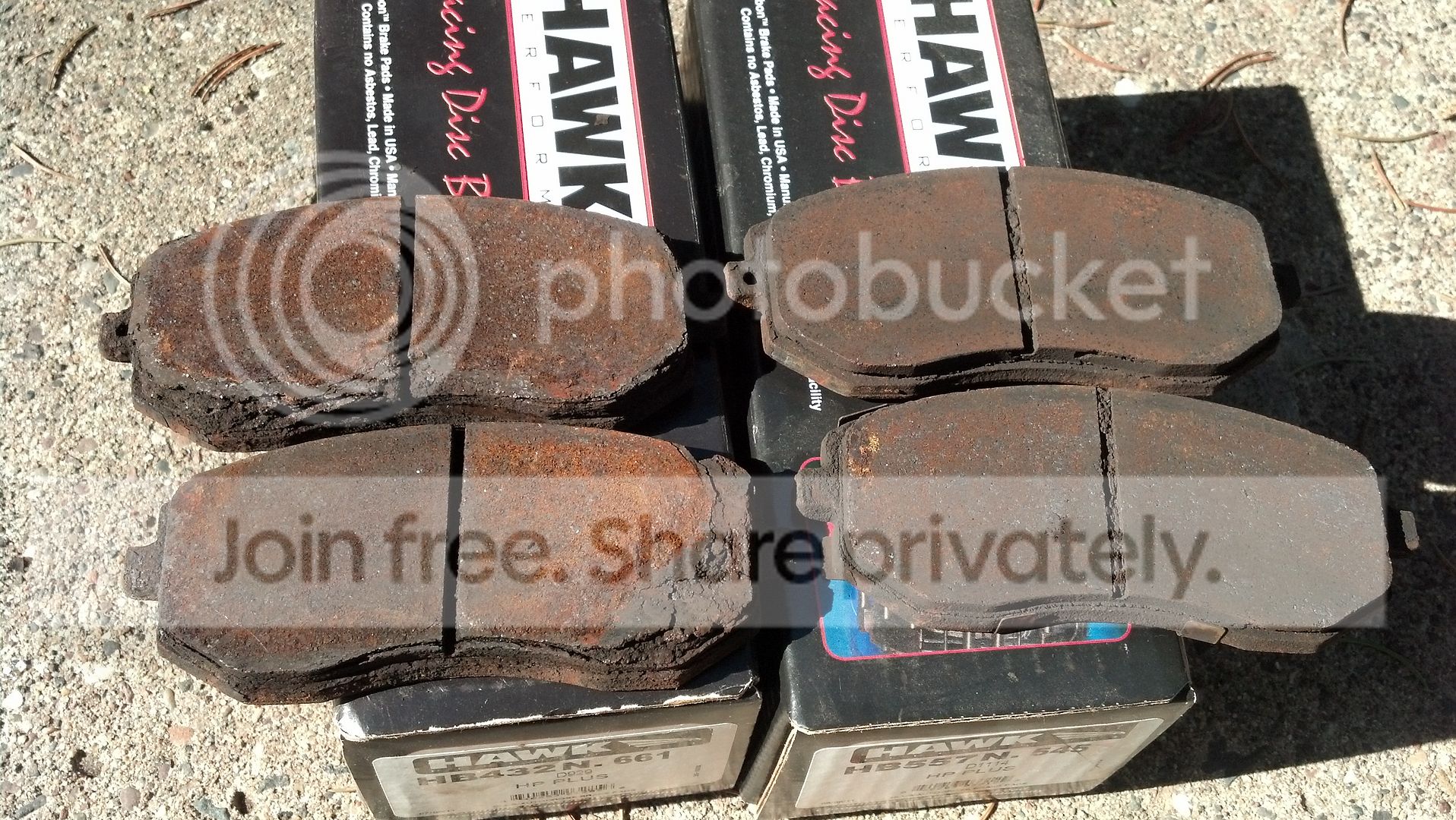

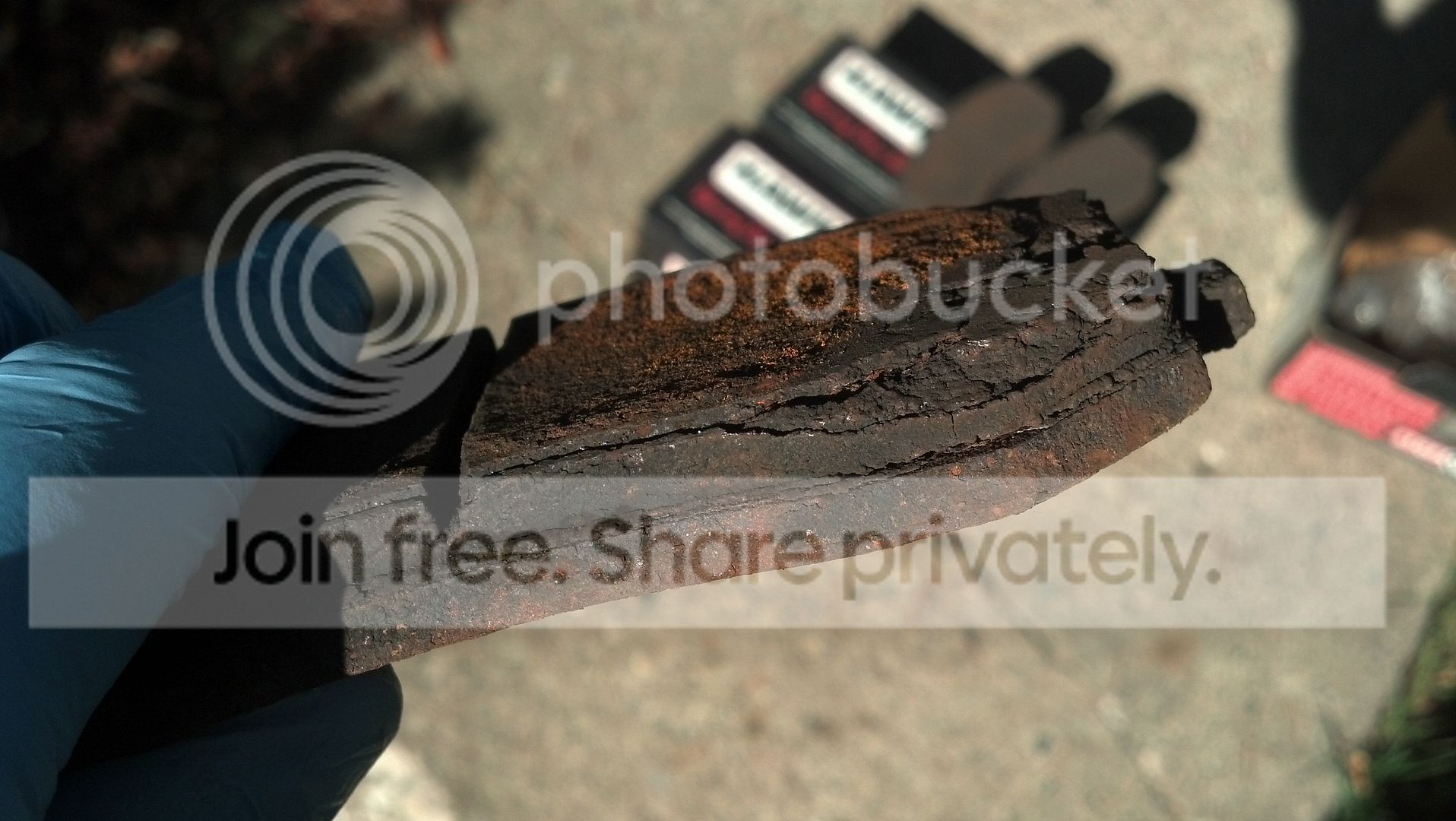

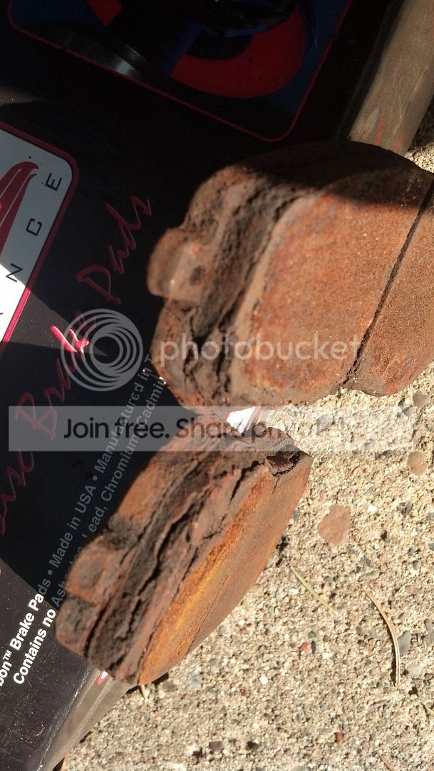

    So to start this off the guys @ Hawk Tech were super cool. I think they went over and above with their customer service. I in no way have a salty taste in my mouth with this company... even with this happening.
    However, I am stuck with these and they will not be replacing them. They wanted to stress that these pads are for the track and not for DD. I figured I would share some pics to show you what I found swapping these out for my street pads. I was going to keep these as my track pads, but it looks like they are getting tossed now. You can tell from the pics that most of the life of these pads is still there. I would say they still have 60% - 70% of their life left.... if not more. It really sucks because I paid retail for these pads.
    Note: They were GREAT track pads. I never got fade when running the road course @ BIR. This includes Chong running my car a few times @ BIR. IDK - I might have to pick up StopTech pads for the track now .... :unsure: .... I do like my streets. So maybe a more aggressive StopTech pad is next and they will only go on at the track.
    Musashi likes this.

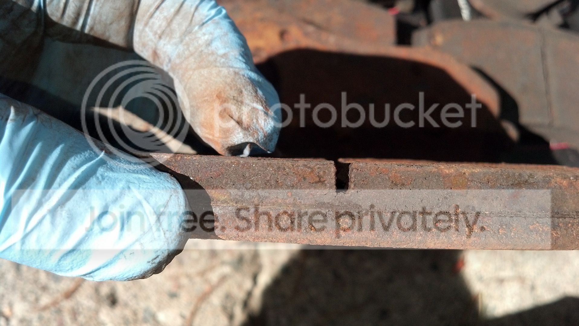

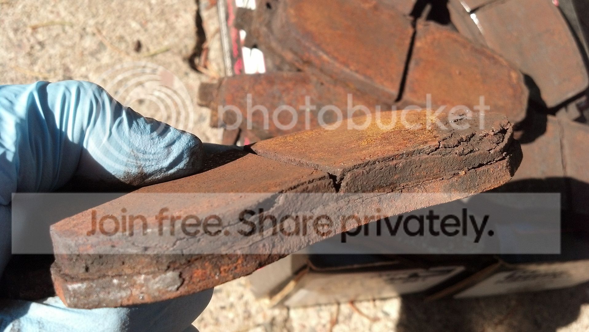

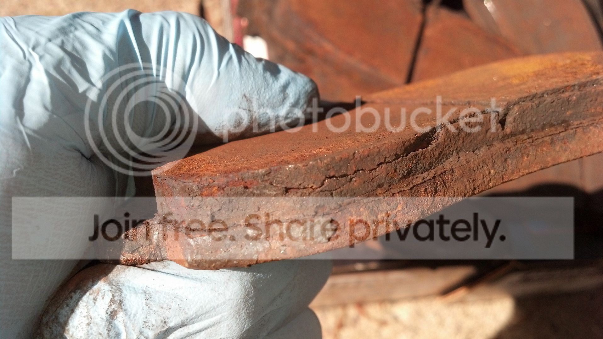

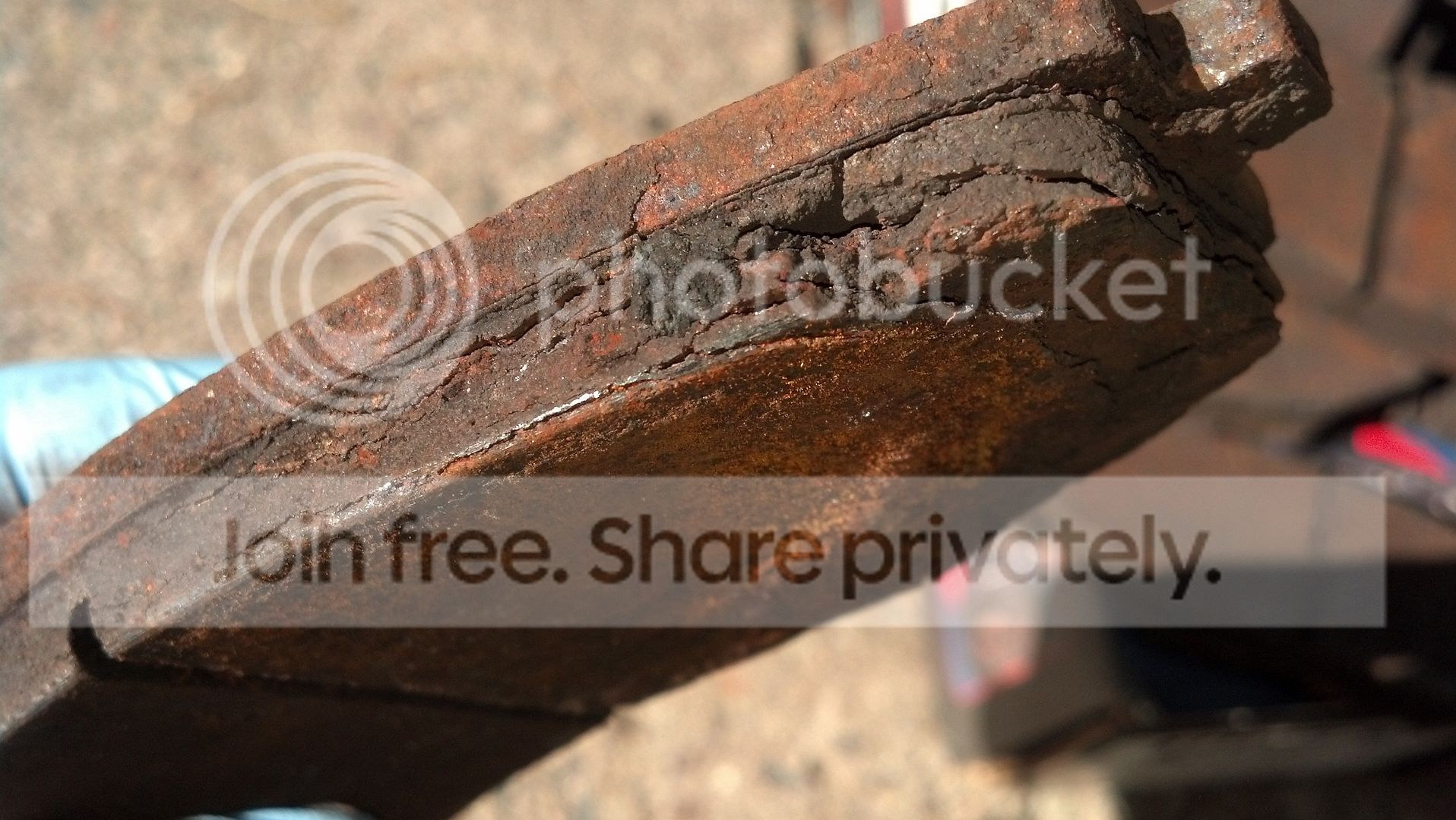

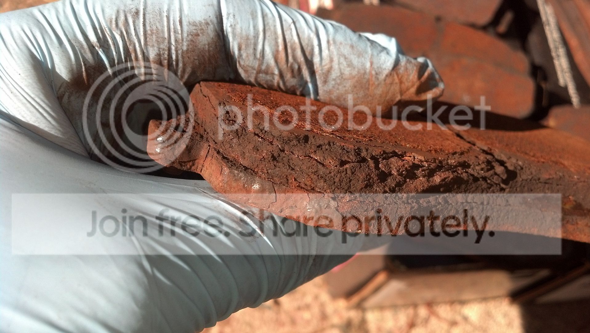

  2. ofspunk7
    The life left...
    Note - each side had a bad pad. I am guessing that the slider pin assisted in this failing. Either way, my Stock Pads had more miles and didn't look like this. I did end up rebuilding my calipers as well when I swapped to my StopTech streets. I noticed when tossing on the new pads that my boots were ripped. However they were still functional when running these HP+ pads.
