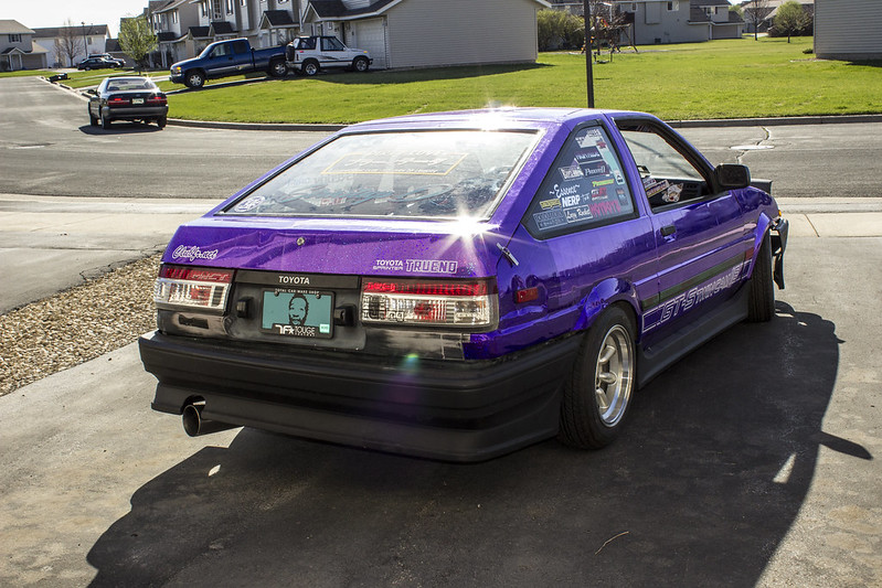

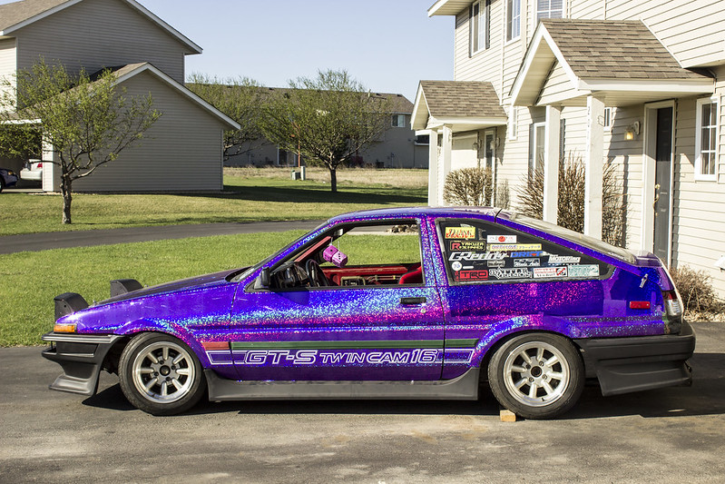

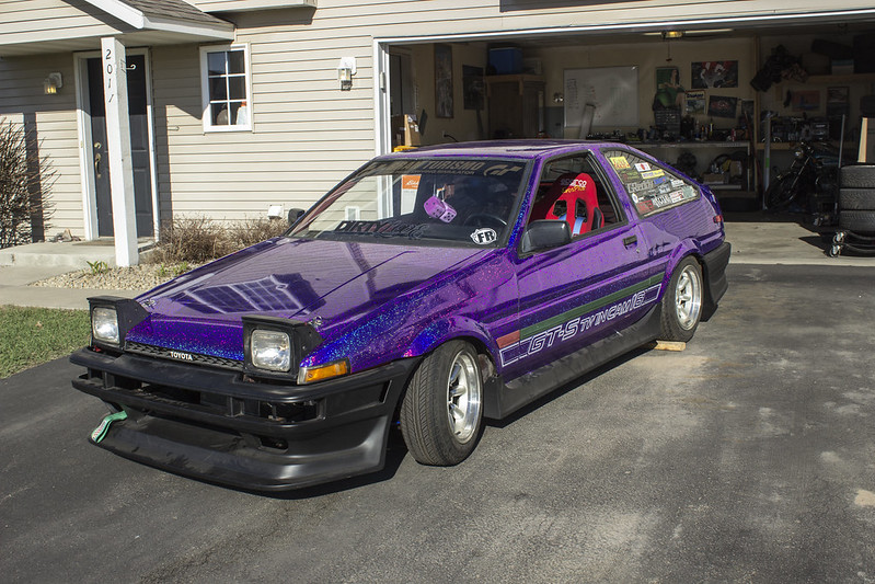

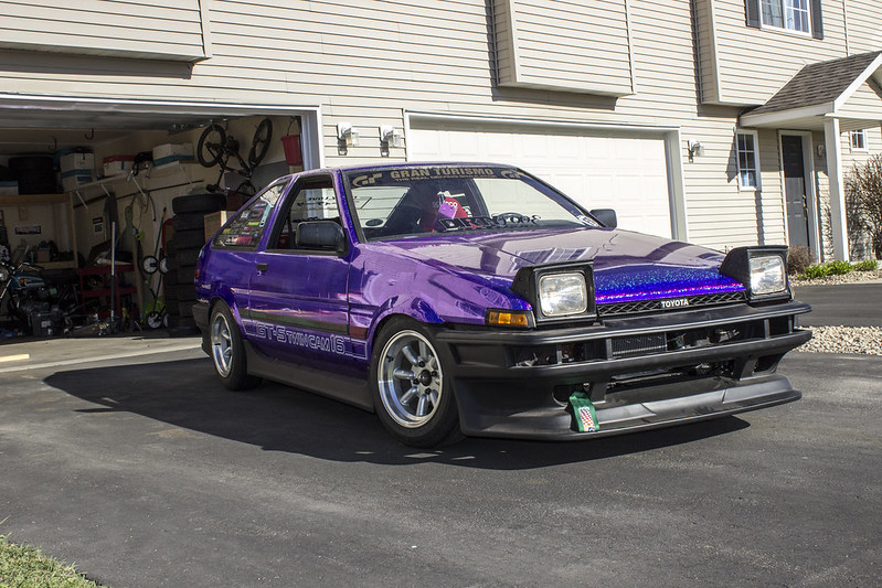

    Well I made a new bash bar, this one I can stand on!
    And now I have all of my aero fitted for the first time

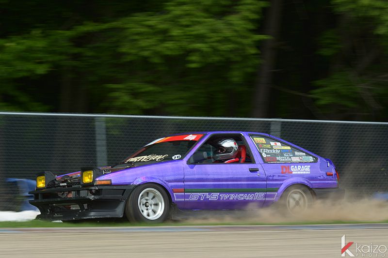

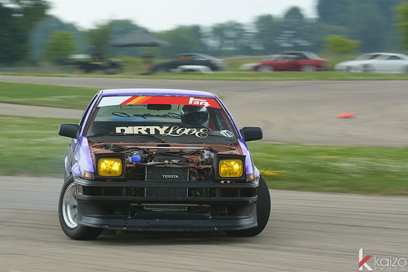

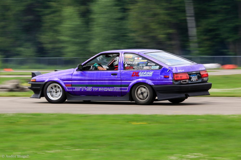

    I drove ClubFR's DD51 at USAir in shawano,WI and, it was RAD!!
    it was so awesome to finally drive the car a bit and stretch its legs! it did take me a while to get back into the grove with the car. for the first half of the day i was on the "doughnut" corse out in the parking lot, but it felt good to relearn some of the basics!
    after lunch i went out to the intermediate track and it was a little rough re learning the track but i had a blast!
    Photos!
    this is the beginner track in the parking lot
    i did have an issue that when the car was at lock it would brake the zipties and i would loose my front bumper :/
    On the i intermediate corse and in the pits
    the next weekend i went to an open track day at elko! it was super tight as i have been to a lot of track days there but i have never driven there!
    at first i was all like!!!
    Then i unloaded the car and got on track! it was awesome! until my fuel pump suddenly stopped working and the car died on me, so i was dead on the track and as i was sitting waiting for a tow off of the track the pump kicked back on, so i loaded the car back up and headed home!
    and then i was all

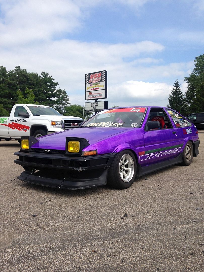

    I made the trek out to Shawano agin for DD53, had a BLAST!
    Other than some oil leaking from the drivers side axel seal it had been running amazing!
