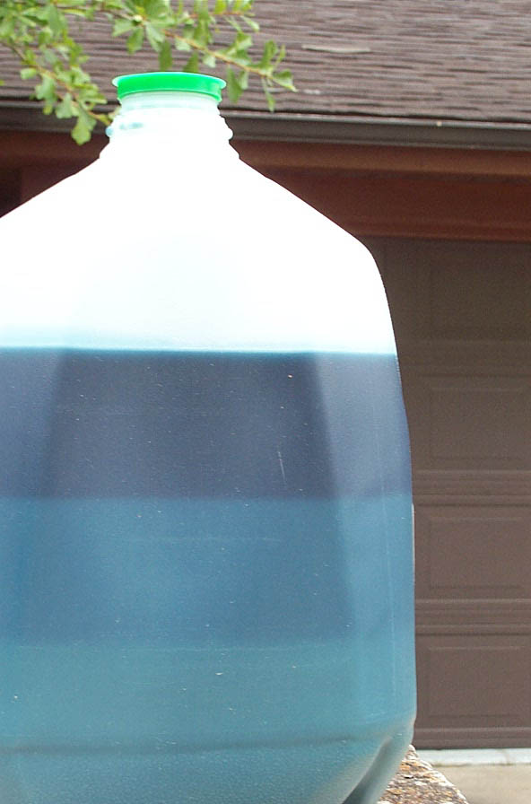

  13. flstffxe
    flstffxe Well-Known Member
    The cocktail separates when stagnant, The fluids do not mix well with each other. Plus if I recall right none of the fluids(possibly one) actually meet Subarus specs for the transmission. Subaru has also in newer(at least '03 up) has began putting a written warning in owners manuals to NOT mix fluids in the transmission.
    The pic is of the cocktail that has separated after sitting for a period of time. Pic from post #1601 from the thread that prezawagon posted.
