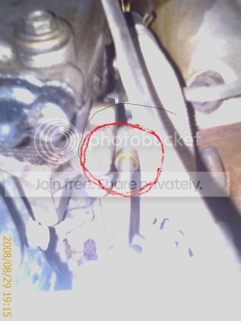

  8. jing123
    jing123 Well-Known Member
    913
  9. jing123
    913
    i think its in that area tat its leakin and sorry for the big pic

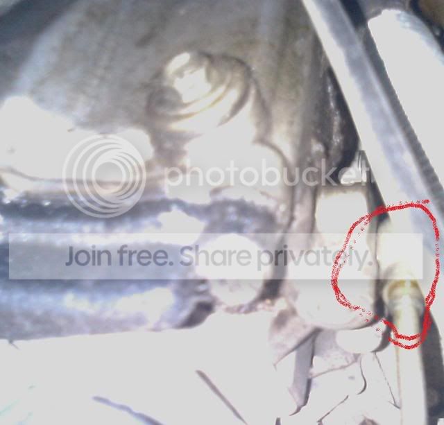

  10. jing123
    913

  13. Scuba Steve
    9,517
    In the Co-Driver Seat
    what year, make, model? 02-03 wrx?
    Looks like the hard Oil line for turbo. The oil originates there and travels up and around and into the turbo. If that's the case it's a super easy fix, just replace the washer...more than likely. (or hardline and hardware)
