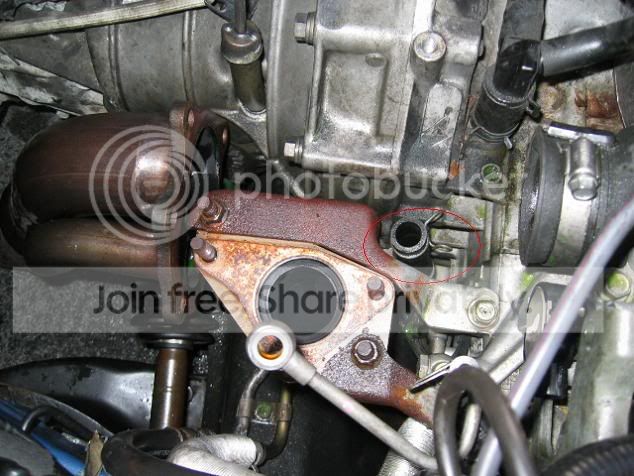

  7. Scuba Steve
    here's a picture with the turbo removed. As mentioned, you DO NOT need to take off the turbo to do this, but removing the downpipe will make life easier.
    and yes....there's no pressure within the line.

  10. Scuba Steve
    bah....car on ramps, get under the car and it can be done. I've done a few. Yes, they can be a PITA...but I've had them on in as little as 30 seconds as well.
    Definitely don't need the turbo out.
  11. Motorhead
    Motorhead Well-Known Member
    Thanks for the input everybody.
    SS, the detailed pictures are very much appreciated.
    Have DP exhaust gasket in hand so ready to work on
    this minor leak.
