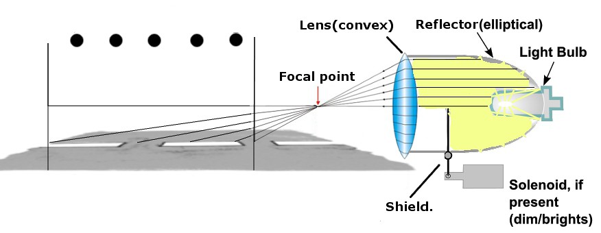

    depends if it has a shield or not. My hella projector foglights have a shield even though they were made for halogen.
    Pull your bulb out, flashlight inside. If it looks like there is a horizontal shield at the bottom so light can only pass through the top then it is suitable for HID's.
    I made this diagram a long time ago to kind of explain to people this projector idea.
    Generally even a halogen projector has a shield in it, however it is not "bi xenon" meaning that it has a solenoid to provide two different(bi) beam patterns.
    In cases where HID's are not standard you'll usually have a low and high beam. The low beam will have a shield and no solenoid and meant for low beam and the reflector in the headlight will be the high beam.
    It really doesn't have a ton to do with if it was made for halogen or not, they are all shaped nearly the same and act the same. It's just if you have a shield in there or not, a functionality standpoint.
    This is the only acceptable set-up for HIDS period. The solenoid to drop the shield is not necessary but the shield is. That just opens the beam for high beam
    From a saftey and cost standpoint it only makes sense to make all projectors suited for low beam like this. It's cheaper and more simple than planning and engineering all these different reflector surfaces to make a DOT approved beam yeah?

  25. pillboy
    3,767
    Thanks for the diagram BaconPancakes. The explanation was very informative.
