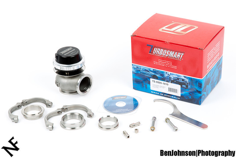

  10. xluben
    Is it a locking nut on there? The normal nut that comes with it is a locking nut and it has a flange on it so it will NOT hold in place within the collar.
    I don't have any real close in pics, but you can kind of make it out in this photo.
    Did you buy the parts new? It seems like someone may have swapped the locking nut with a non-locking version because it's a little easier to install...?
