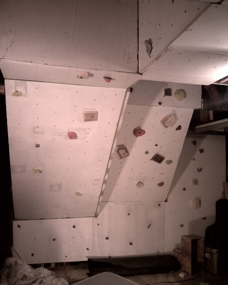

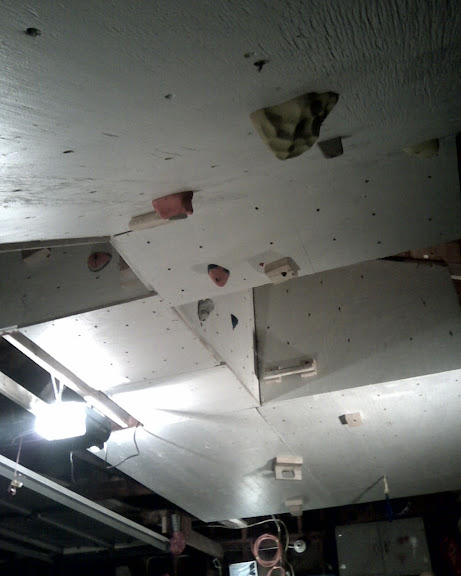

    Anyone live near Chanhassen? I have a bouldering cave in my garage and people are always welcome to stop out and climb a little while people work on cars- I just need a heater for my garage...

    i live in burnsville but thats badass that you have a bouldering cave in your garage...i'm jealous

    not to brag- it has been a lot of work, but it is a ton of fun. This picture is not quite up to date and I have more holds up now. It spans over both cars in the garage :)

    that is crazy mate... I should do that in my 30x40...
