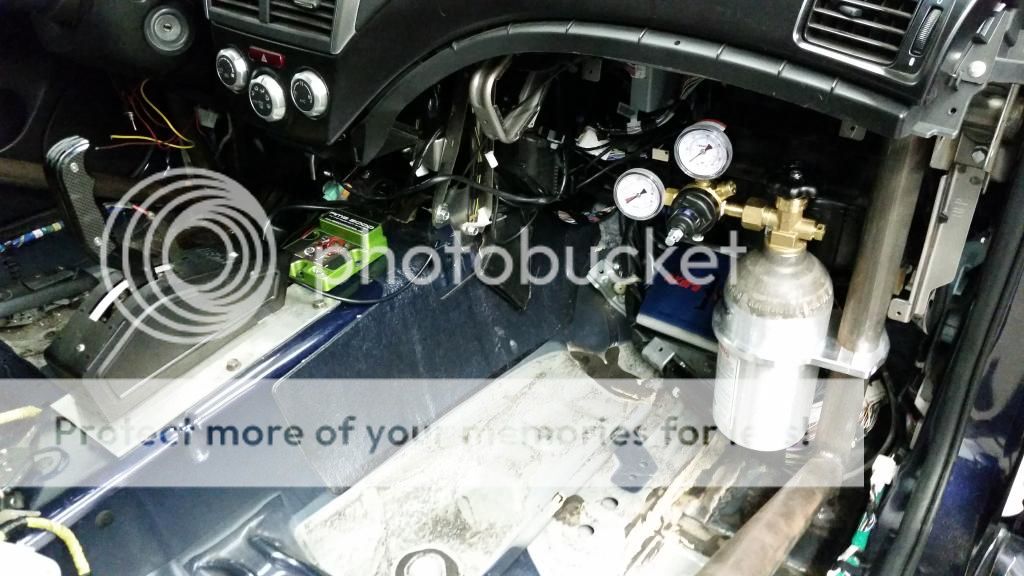

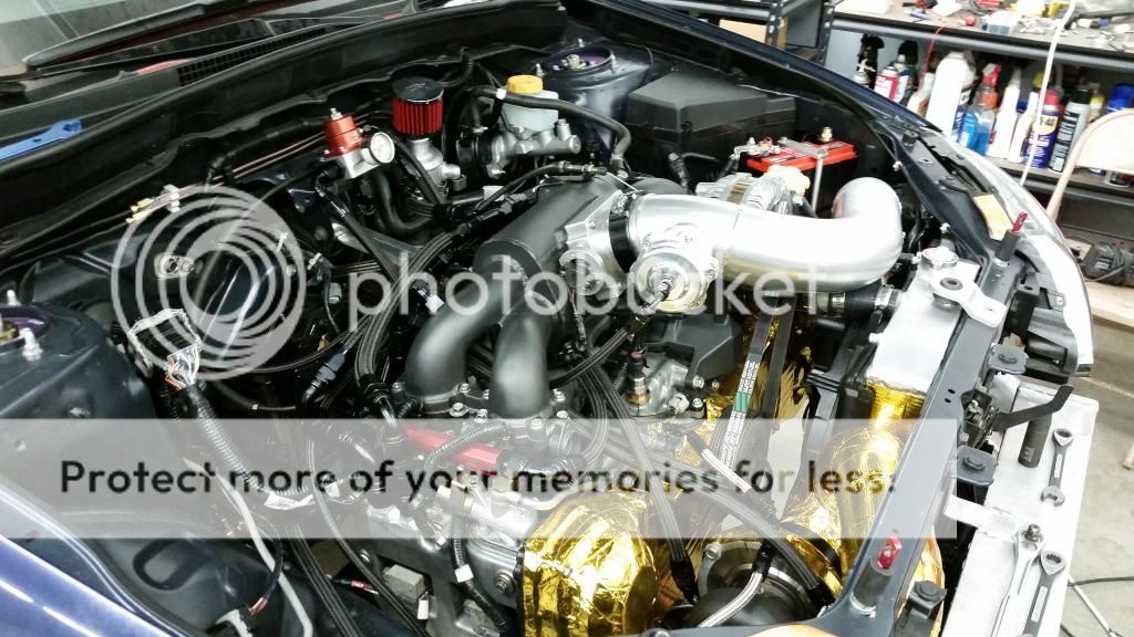

    A little update on the build. We got most of the work done under the hood now. I didn't really know what to expect with using the engine wiring harness from my 2012 with the motor from the 04, but it ended up being pretty easy. Only things I had to replace were the knock sensor and water temp sensor. The connectors for the coils were a little different but I just had to shave a little piece of plastic off them with a dremel, and they clipped right in. We also had to wire up the TPS sensor for the new throttle body, injector pigtails, and since I'll be running speed density through the MAP sensor in the hydra, we got rid of the MAF sensor connector and just kept the 2 air temp signal wires to run to an AEM air temp sensor near the throttle body. We also got all of the fuel, oil, breather and boost lines done, there's just a couple fittings we were missing that we have to throw on still.
    We also wired in a vacuum pump that kicks on whenever the brakes are pressed to add vacuum to the brake booster and help hold the car on the line during the 2 step. We T'd the pump into the brake booster hose between the booster and check valve. We also installed the brake proportioning valve and got the rear brake lines done. Still need to do the fronts lines.
    We also installed the AMS2000 pro boost controller. There are 10 different control strategies you can set it up for, but after talking to NRL they said all the drag guys use a time based input. Since the "pro" model has a built-in accelerometer, we should be able to see traction loss in the logs and adjust the boost accordingly, without the need for any other inputs. For the time based input, we used the brake switch. We also ran it through an arming switch, so it only starts the timed map when you want it to. Basically, I'll just have to get up to the line, get on the 2 step, flip the arming switch so the control sees 12 volts, and as soon as the brake is released the signal will change to ground, and start the boost timer. The wastegate will be regulated with pressurized Co2 through a solenoid we also mounted under the hood.
    That's about it for now. Should be able to start it as soon as we get the rest of the fittings and set up the fuel pump. If all goes well, I should have an update of it running very soon! Thanks to Fobia and Wade Deslauriers for all the help with the wiring and plumbing. No way I could have done it on my own.

    That is all super cool! I didn't even realize you could get that sophisticated with the boost control. I know boost by gear has been around forever but using an accelerometer to dial out wheel spin is sweet.
    Are you only using the vacuum pump for the brake booster? Or are you also adding some vacuum to the crankcase to limit blow by and have the rings seal better?

    Yeah the ams2000 is pretty sweet. You can set it up to control by pretty much any rpm source- driveshaft, wheel, turbo, etc, engine rpm, throttle position, shift input. You can also set up a scramble or reduce button to it, to increase or decrease boost manually.
    The vacuum pump is just for the brake booster. It's actually a factory part for audi and VW. They're mostly used on diesels or other motors that don't make much natural vacuum.

    Too much weight ;) Just a little update since the thread was bumped, got all of the major leaks fixed, might still need to tighten a fitting or two. Since I was taking off the oil pan, I decided to upgrade to a killer b pan and pickup. Fobia uses a killer b pan on his long block mock-up for his turbo kits, so fitment was perfect. It also fit well with the tssfab front subframe. Since I had the header off, I thought I'd take a picture of it.
    I was actually just at Fobias house the other day and he had a few turbo kits laying around waiting to ship, and he was working on an evo kit for another RS motors drag car. All of his stuff is top quality, but I love seeing the custom work.
    As for my car, next order of business is boost leak test before the dyno. After a lot of looking around, I ended up piecing a tester together out pvc. I call it the J5500, from J5 Industries (TM)
    I hooked up the pressure tester tonight, and it was immediately evident that I had some leaks at the intake pipe clamp joints. Most likely I damaged a few of the o-rings, not being careful enough sliding the metal sleeves on and off. Im trying to get some vibrant o-rings ordered asap, which are a bit thicker. More updates soon.
