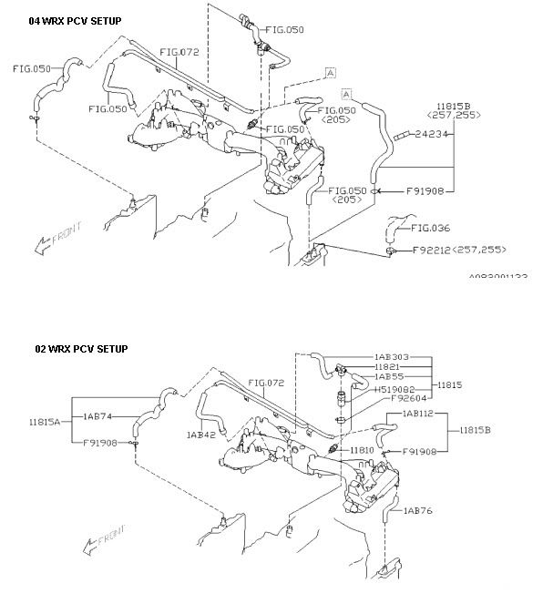

  13. Bielke55
    No... Whats in red is on your car. And is NOT a PCV Valve. From the link with the wrong info you posted.
    See here... 02 WRXs have a PCV Vavle. Its a 11810AA000 its the old style PCV. The number you had from the internets is only for N/A Models Ej251 and EJ253

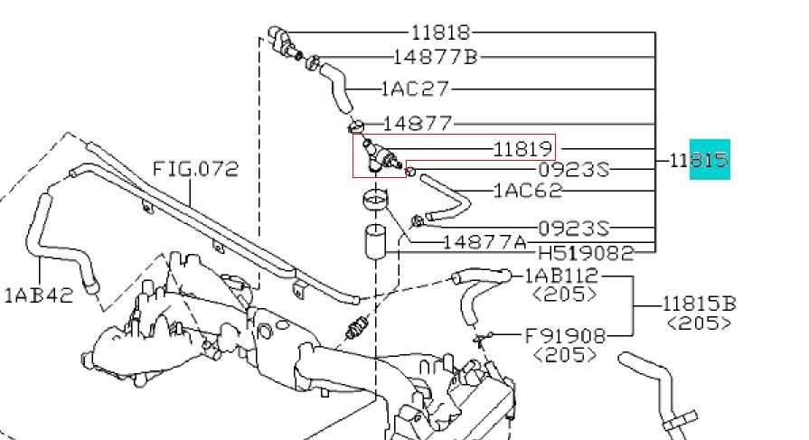

  15. Kevin
    Kevin Well-Known Member
    Arguing aside.... what is that part then?
    the one i took off my car, is made of plastic... looks just like the one in the pic u posted. the top of it and the bottom are plastic openings that go straight through, Yes. however on the side of it there is a metal nipple that connects to a vacuum line that goes to the intake manifold. there is a check valve in there, which lets air though into the manifold(venting crank case preasure) but not backward (from the manifold to the crank case) if there was no check valve in there then i would be pressurizing my crank case every time i am under boost.
  16. AWDimprezaL
    Un screw it, its just a nipple, the plastic part is the check valve.
    phi11 likes this.

    The part number you posted IS A PCV VALVE YES, WITH A CHECK VALVE INSIDE IT NOT LIKE THE NIPPLE THAT IS ON YOUR CAR, for an N/A car not yours, THE PLASTIC PART YOU ARE LOOKING AT IS THE CHECK VALVE.
    phi11 likes this.
  21. readymix
    Oh for the love of god. There IS a PCV valve on your car, BUT, it isn't the part you told him, it's the entire assembly. The nipple that sticks out of it is just that, a nipple. Doesn't matter what it is made of, it is an empty straight through nipple that screws into the assembly. The assembly does NOT need to be replaced, NOR does the nipple as part of ANY maintenance interval for your car. On older N/A cars, the "Nipple" had an integrated valve in it....
    Like this: http://images.google.com/imgres?imgurl=http://www.subaruwrxparts.com/shop/pc/catalog/pcvvalve_1456_general.jpg&imgrefurl=http://www.subaruwrxparts.com/shop/pc/viewPrd.asp%3Fidcategory%3D71%26idproduct%3D2115&usg=__6iAVOktDCH6xAFqMNzjZbDM5Bt0=&h=150&w=200&sz=5&hl=en&start=42&tbnid=2leNOHYUFQU1fM:&tbnh=78&tbnw=104&prev=/images%3Fq%3DPCV%2Bvalve%2BWRX%26gbv%3D2%26ndsp%3D21%26hl%3Den%26safe%3Doff%26sa%3DN%26start%3D21
    You do not put that on an 04 WRX. It goes on N/A 2.5L motors that have a PCV replacement cycle.
    The part referenced in the catalog for your car is simply a metal (or plastic) straight through hose barb fitting. You could probably find it at a hardware store.

  27. readymix
    No, I didn't say that. Shut up and stop over-reacting. This isn't some conspiracy or double-speak, so stop being a drama queen about it. I can almost picture you throwing your hands in the air and waving them about as you run circles around your desk.
    There isn't a PCV valve on your system. Yes there is a Positive Crankcase Ventilation System installed on your car, it just isn't an item that you replace or service as it was intended to be a zero-service item. There isn't a replaceable valve anymore, you have to replace the entire T shaped sub-assembly...and that is done for repairs only, it isn't a service item. So yes, there is some sort of valving system involved in venting crankcase air, but there isn't a PCV VALVE to replace. It is an assembly.
