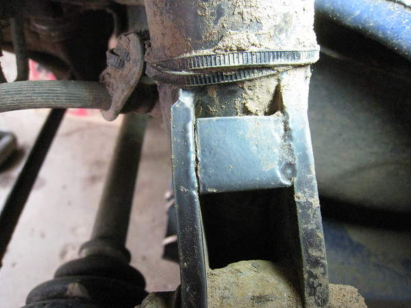

    cracking struts is awesome
    fml

    luckily it looks like an easy fix.
  4. sniper1rfa
    sniper1rfa New Member
    Remember that it's chromoly or something - your welder won't touch that.
  5. Scuba Steve
    looks bent too...:eek3:
  6. carl
    easy fix for someone else I should have said

    they are run by a few teams who compete nationally and by many other regional teams - they've been put through much harder paces than what we've done. i think it was just a weak weld. all the others are fine

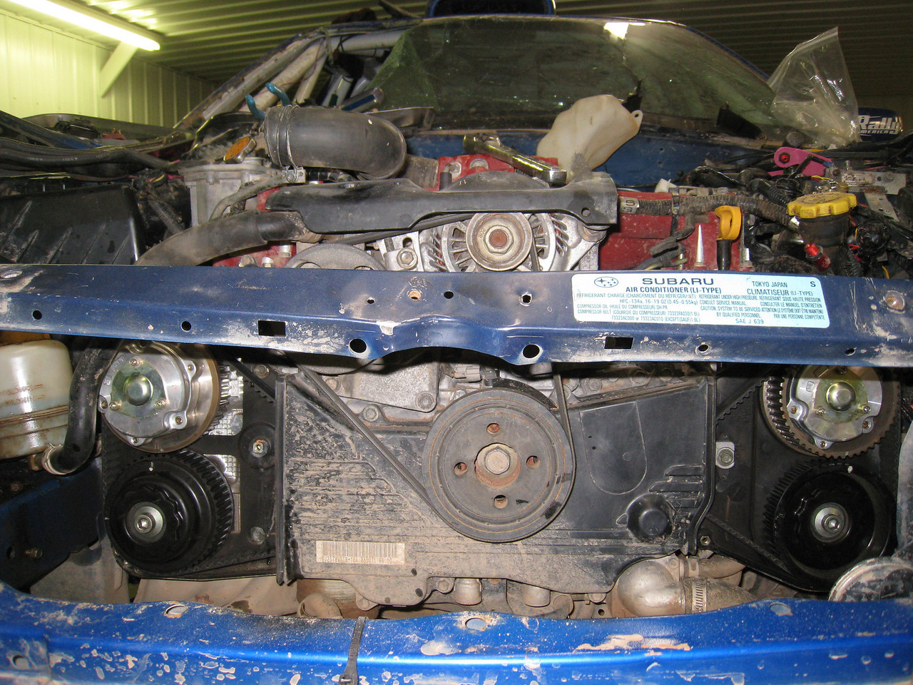

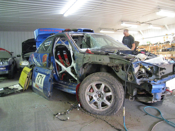

    so everyone knows we rolled it a whole bunch
    repairs have begun
    timing looks to have jumped a bit. hopefully no engine damage - it wasn't making bad sounds when we turned it off so fingers crossed

  16. carl

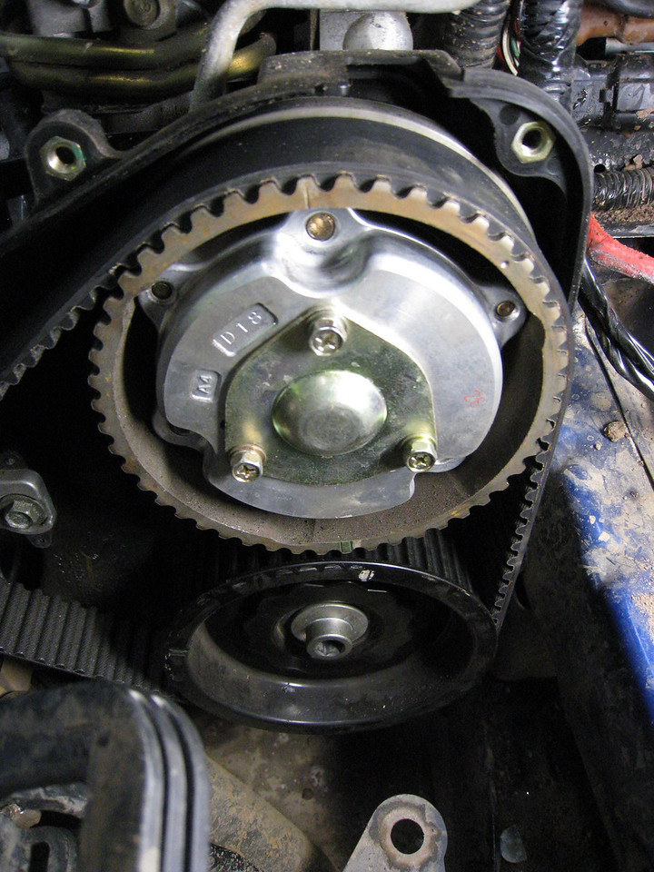

    could use a hand with someone experienced doing t-belts. i think it might be a lost cause though. spoke to bikerboy and whiskers and it's likely with the position the cam gears are in that we bent the valves and possibly worse. need to re-time it and do a leak-down. none of the ziptie crew have done much in the way of t-belts. if anyone is free tonight or tomorrow please pm me
  17. carl
    not quite right
  18. Vector
    Vector Rally Organizer
    416
    The front end damage looks about like what I have to deal with on Sentra #2. As far as scope goes. Yours looks a lot messier, but the actual damaged area is about the same.

    Alright, I've never rolled a car or really even crashed one (other than hitting that damn deer), but how did the timing belt jump a notch when you rolled? That seems like the last thing that would happen in a roll into a swamp.
  28. carl
    it jumped about 6 teeth only on the exhaust cam of the driver side.
    rolling a car is very violent and the tensioner can slip.
    a huge thanks to chux who came down from duluth to work on it tonight - between him, dave, tall dan and myself we got the engine re-timed, the windshield out, a bunch of stuff unbent, the interior cleaned, roof scoop removed and found out that the driver's frame rail is indeed bent. it bent at the spot that was already damaged from gravity park - it pushed it toward the engine maybe 3/4". luckily all before the crossmember so we're ignoring it
    the engine started and idled beautifully after we retimed it so it looks like we didn't bend any valves

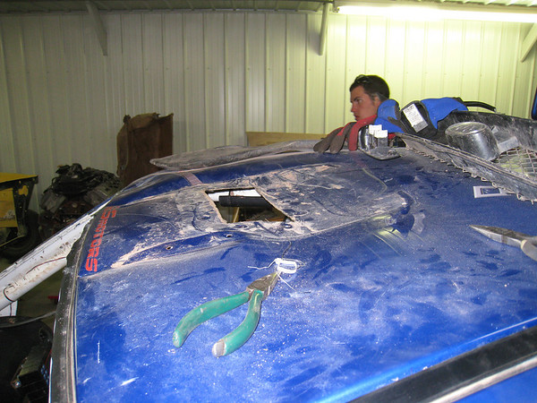

    this used to be a ball of sheetmetal
    dented roof is dented
    still looks like a rally car
    almost cleaned out

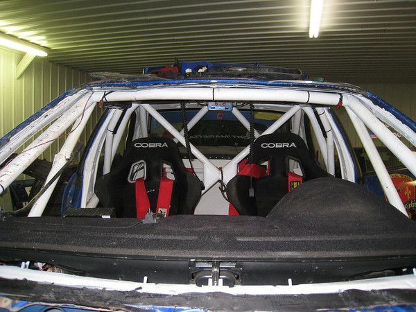

  29. piddster

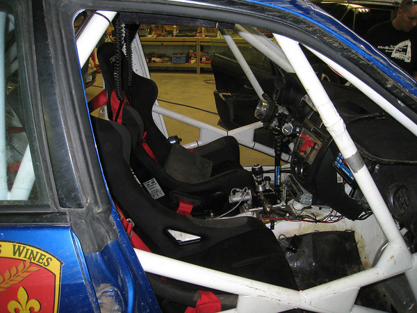

    Its hard to tell from the pics, but how did the cage fare? The rest looks fairly workable.
    Are you going to put on a new roof skin? If so a carbon skin might save you time, and a lot of it. Panel Bond is quick and easy, and will not come off even if you roll it again.

    I think a carbon roof might not be legal. The cage does look good and Grahm clearly did a good job of keeping it tight to the shell which means less deformation.
  32. Chux
    1,492
    the cage wasn't even touched. the unibody took 100% of the impact, with only a little damage (lots of cosmetic stuff....obviously, but structurally, it's awesome).
    the roof will be replaced. which is why we removed the scoop. oddly enough, the fiberglass (?) scoop took a direct hit, only got a little crack, but put a perfect scoop-shaped dent in the entire roof. just crazy!
    we definitely got lucky. looking at the pictures, that cam was further off than I remembered, probably more like 8-10 teeth. but like Carl said, we set it, and it fired right up and idled smoothly. no radiator installed, so we didn't run it long, or rev it.....but things are looking up.
    we visually inspected all the suspension, and it all looks great, except the strut that had the failed weld. Boomer re-welded that spot, but now the other side of the bracket is cracked, and the whole thing is fairly bent. hard to say if it was a poorly-made strut, or if it's a result of the fact that that corner took the brunt of the impact. either way, we'll be re-re-welding it for a spare (will fit either side!), and getting a new one before Ojibwe.

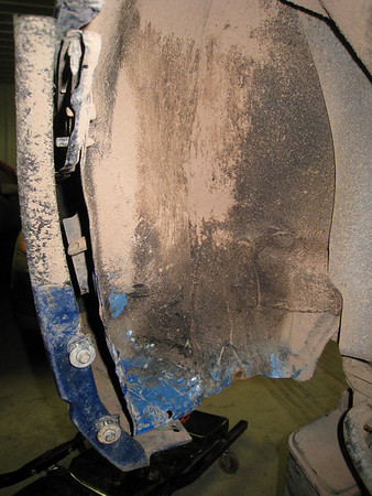

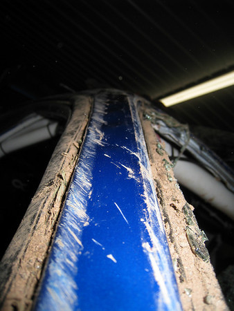

    awesome, the ****ing engine did shift. chances are the whole cradle/crossmember is off. i can only pray for busted engine mounts
  38. Deride
    I have multiple sets of stock engine mounts I'd sell for five bucks a set if you need them.
  39. piddster
    Bummer. How did you figure it out? Tape measure comparing sides?
  40. carl
    the ****storm of a noise when we loaded and unloaded it off the trailer. then finding the nice shiny wear marks on the dirty dirty axle
    if we blew the mounts it's getting group n. if we shifted the crossmember it's getting a bfh and loctite :laugh:

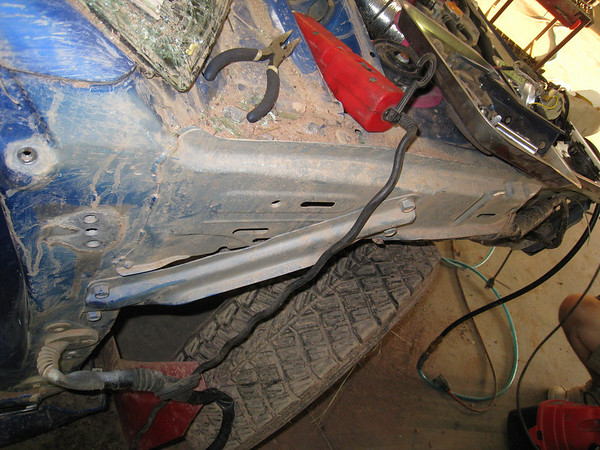

  41. piddster
    I would start measuring things to find out what actually did bend. Also, irregularities in the frame rails are good indications. My old car had a nice dimple in the frame rail right in front of the crossmember from nailing a culvert at 30 mph, lol.
  42. carl
    well the frame was already bent and it appears to have bent more - but it looks to be at the crease from the original impact, which is 100% in front of the crossmember
  43. piddster
    That sounds like trouble if the motor actually moved.
  44. Chux
    1,492
    what was the axle rubbing on? I can't picture how the engine could have shifted enough to cause rubbing without be obviously not in the engine bay anymore :eek:
  45. carl
    i hasn't moved much - just enough that the axle will touch the crossmember under heavy suspension compression. if the car is level you can't tell, only going up and down the trailer did we hear that something was rubbing. the left side of the motor seems to be pushed back toward the firewall a small amount, the edge of the timing cover is a bit closer to the frame rail than a stock car (maybe .5") but the rail is also bent slighlty
