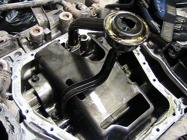

    woot, oil pickup was in great condition. engine in general is in extremely good condition.
    We did a leakdown and these were the #'s cold:
    Cyl 1…4% Cyl 2…2.5% Cyl 3…3% Cyl 4…2%

  15. piddster
    I guess I've never actually seen the newer oil pickup brace. No wonder they crack and break. The old ones don't rigidly attach to the pickup.

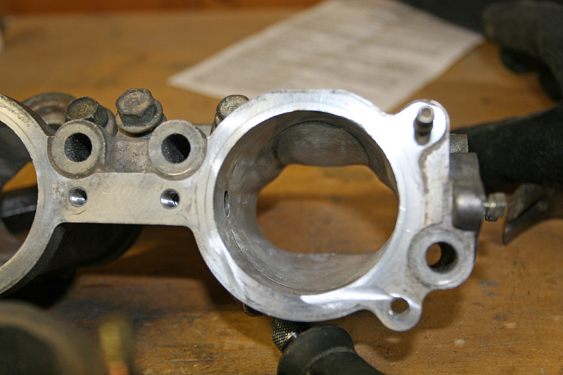

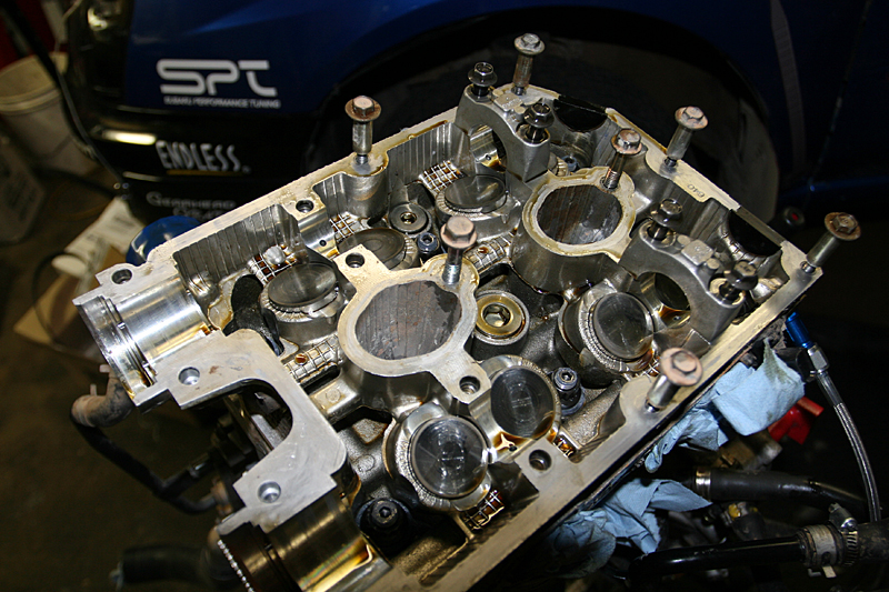

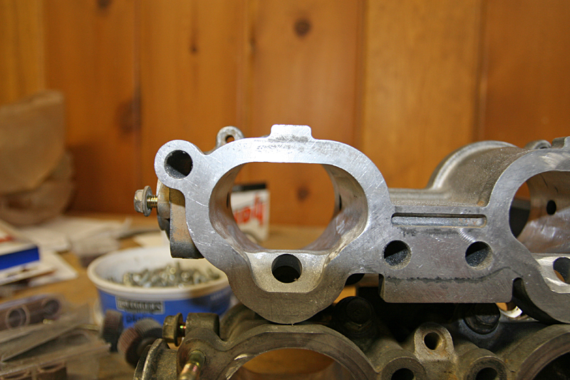

    deleting some TGVs

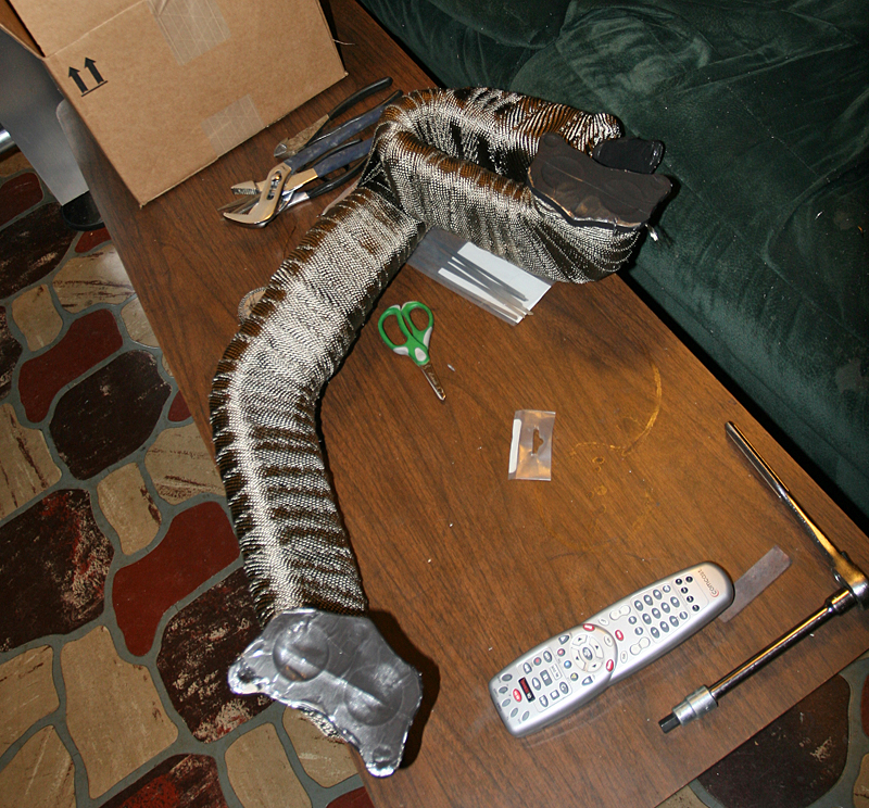

    maddad header wrapped in DEI titanium wrap (this stuff is much nicer than the old fiberglass crap - way easier to work and doesn't get you all itchy.)

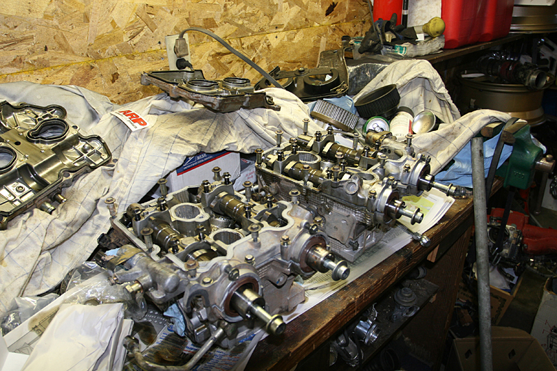

    look ma, no heads!

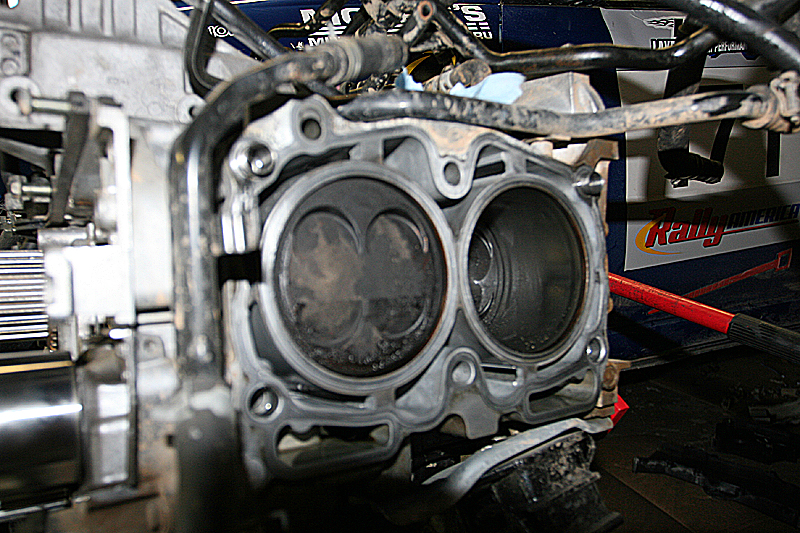

    what 11:1 pistons look like
    one side done with cometic hg and ARP studs
    gonna go do the other side after dinner. I can't finish them completely since I need a few gaskets. My ACT prolite flywheel showed up today (ImportImage ftw!!) so I've got pretty much all I need aside from the gaskets (3 bolt manifold to up-pipe, water crossover pipe, half moons for the heads) and turbo restrictor

    how much is it to do the TGV deletes?
  21. Chux
    1,492
    got a dremel (or similar rotary tool)? Free.
    actually. it'd still probably be cheaper to buy a dremel than have them deleted.

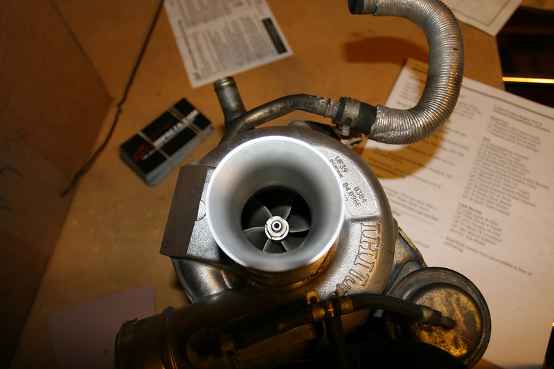

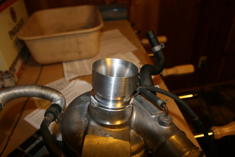

  24. carl

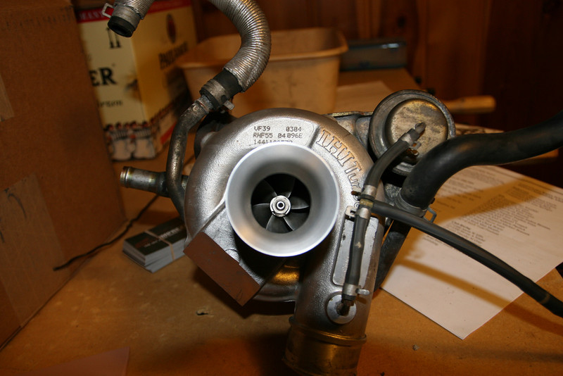

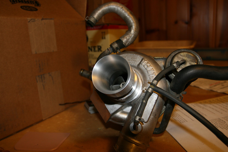

    turbo restrictor
  25. WillC
    WillC Well-Known Member
    looking good bud!!!!!
  26. Shibbs
    Since you're only gonna be running about 6 or 7 psi, why not just go MBC or no boost controller?
  27. carl
    we may be running as much as 20 psi on race gas ;)
  28. Scuba Steve
    looks great, can't wait!!:cool:
  29. snbrd4evr
    snbrd4evr Well-Known Member
    Either can I! Woot! Rally!!! :)
  30. goodhart
    goodhart Well-Known Member
    I'm guessing the restrictor must be a requirement for the class you run in?
  31. Chux
    1,492
    no. we decided that the biggest problem with the VF39, is the air inlet was too large. it really needed to be toned down a bit ;) :p
    yea. IIRC all turbo cars have to run one.
  32. carl
    all turbo awd cars must run restrictors. 32mm for pgt, 34mm for sp and open

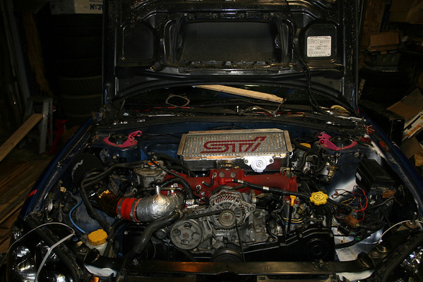

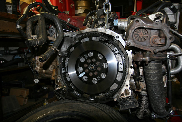

  34. carl

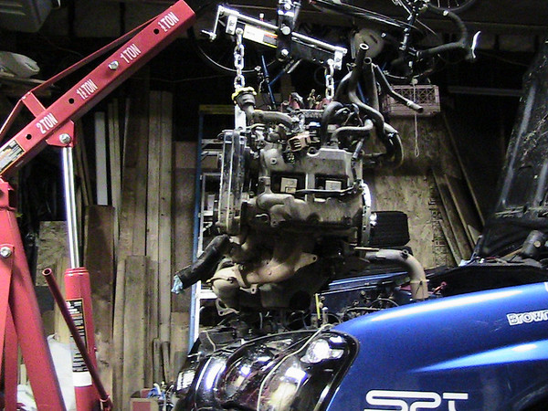

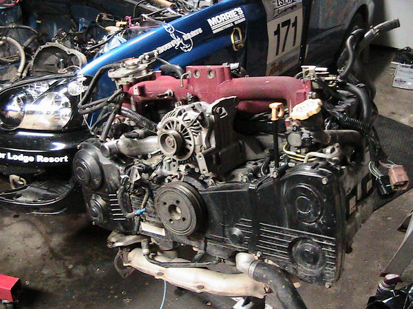

    lightweight flywheel
    Dave, Tall Dan and I put the engine in twice today (the shield that goes under the flywheel/clutch got bent up between the trans and motor so we had to pull it back off to straighten it).
    Then my dad and I pull it and installed it again after i realized part of the clutch release bearing wasn't installed properly. A big thanks to Matt (bikerboy) for hooking us up with a throw-out bearing!!
    The good news is she runs! fired up on the first try (didn't run it long since no coolant was in the engine and I didn't even have the downpipe on. We also are throwing a ton of codes (tgv's, o2, evap for sure - maybe more lol)

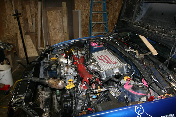

  42. carl

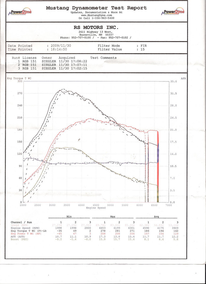

    Ron at RS Motors tuned the car today. This is what we got - 208whp, 281wtq. We aren't holding much boost - either the wastegate or a boost leak so there's maybe a bit more in the car but this is more than enough for sno*drift. notice peak torque at 3250 rpm. It's odd to drive since it makes huge tq right away (and gets there quick with the 11lb flywheel) and then hits a wall as the revs climb.
  43. Scuba Steve
    :yumyum: new power = :cool:
    :yumyum: new power + sno*drift = :eek:hnoes:
    :laugh:
    i can't wait!!!!!!:biggrin:
  44. carl
    Ron did a great job tuning the car for driveability and reliability. For the short while I drove it tonight I was very impressed with the car's response. That useable power combined with the new diffs and the ability to re-map the programmable dccd (I bought my own GEMS controller and software so I can edit the dccd maps) should give us some very good results this year. We'll have to look into why we aren't holding more than 16psi and maybe re-tune before 100aw (I also want to get a new cat, ours might be partially plugged).
  45. Chux
    1,492
    could the fall in boost pressure just be due to CFM limitations from the restrictor?
