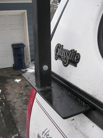

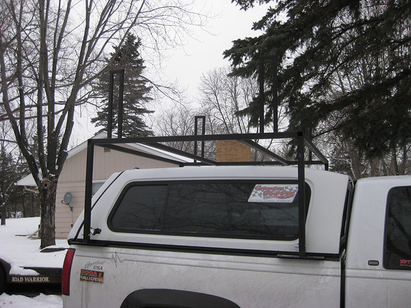

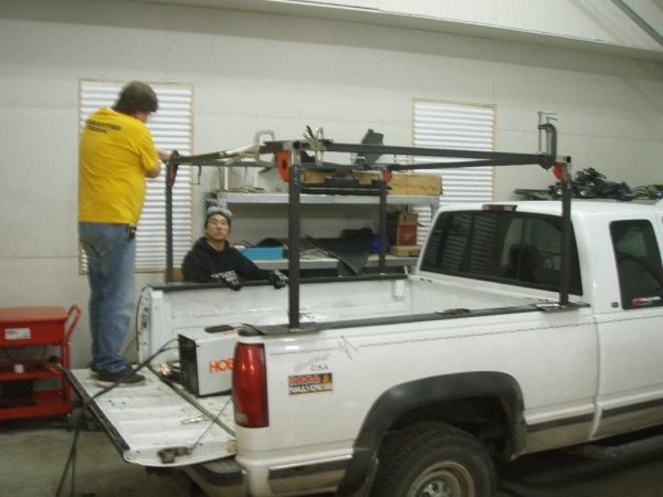

    well this isn't really work on the car but it is rally related. Over the weekend a tire rack for the service truck was constructed. A huge thanks to Matt (mlgez) for letting me use his awesome garage since I can't fit the truck into mine lol). Also thanks to Matt's friend Bob and Tall Dan for assisting in the construction

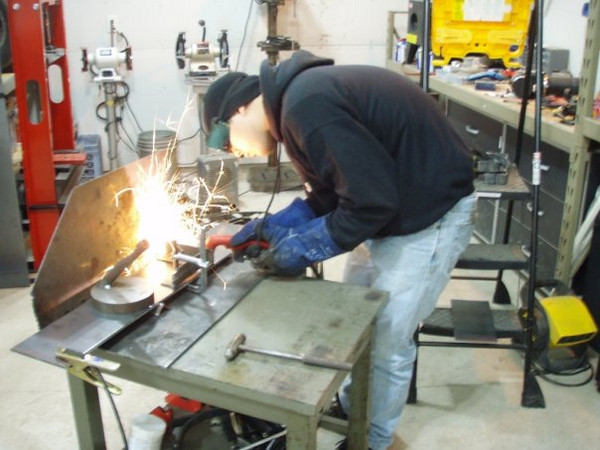

    me plasma cutting off a piece of 1/4" plate for the base

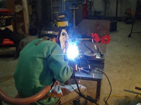

    Matt welding a tube onto a baseplate

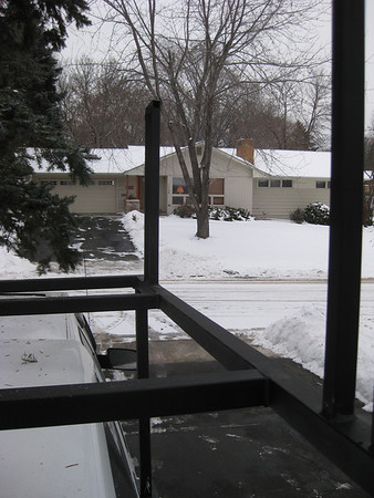

    The overall frame clamped together to get welded

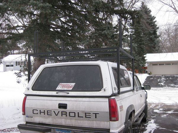

    The baseplates are 12"x6"x1/4" steel plates. They have studs welded to them and drop through the truck's bed rails. 8"x2"x1/4" backing plates go on the other side. There is a 1.25"x1.25"x6" post welded to the plates that the frame drops onto (so it can be removed easily).
    there are 2 rows for wheels, each row can hold 6. The tires sit in between two parallel bars. A tube is inserted down the hubs of the wheels and locks between the tall uprights pictured
    It is more than strong enough to hold 12 wheels and gives us a good option to add sideboxes to it later for even more storage - not bad for $150 worth of metal and a weekend's work! I might add some gussets later just to make it a little more rigid.

    mlgez Well-Known Member
    LOL, that was discussed at some point last night. Looks good finished Carl. I had a good time working on it last night. Wish I could have helped today too but company for an early Christmas. Glad everything worked out and the shop was adequate.
  31. Dynapar
    Awesome tire rack! I like the design, very functional and simple. You gotta post pics of it all loaded up now.
