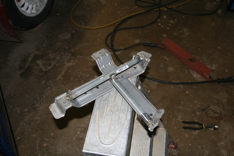

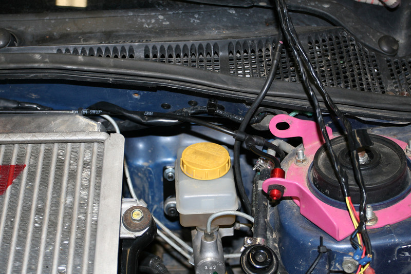

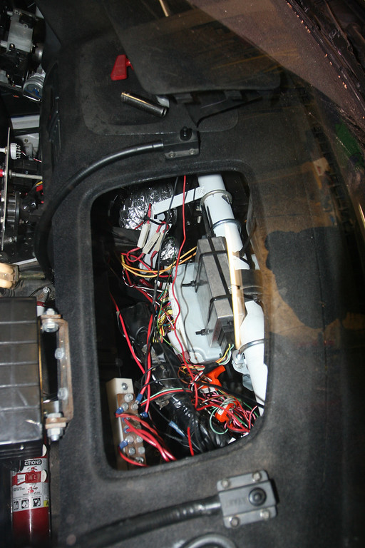

    no more brake booster (it is actually easy to brake, it just takes some getting used to)
    relocated ecu and GEMS controller
    reinforcing the bracket that normally holds the ecu.

    so what's the purpose of taking off the booster?
  17. carl
    7,981
    we gotta gooooo
    consistent brake pedal feel. since we do a ton of left foot braking the pedal feel will change depending on what the gas pedal is doing. subaru sells a booster delete for their group n cars

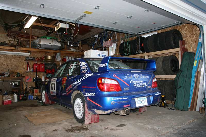

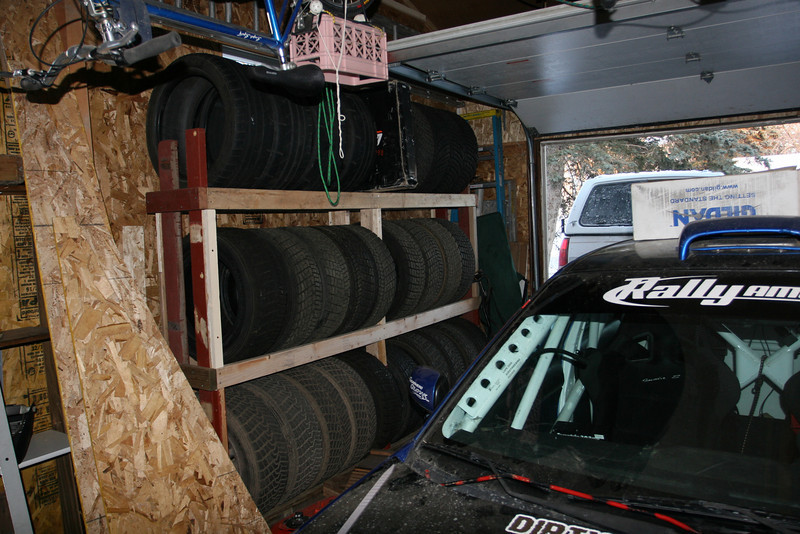

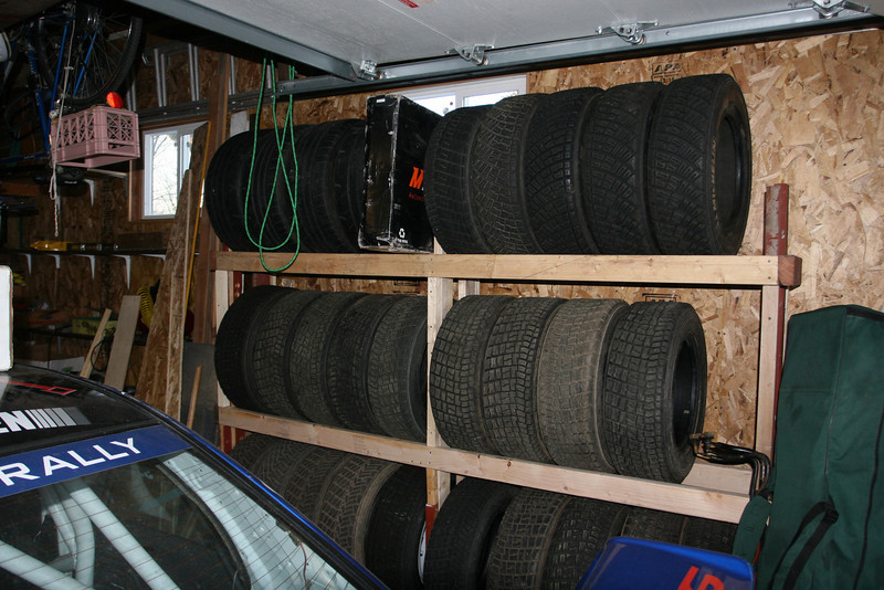

    we gotta gooooo
    got tires?
    not pictured are another set of sno*drift tires plus sno*drift spares and another full set of wheels/tires I'm buying off Dan
    rally rally rally!

    you need a pretty expensive tire machine to do rally tires. One of our sponsors does the tires for us

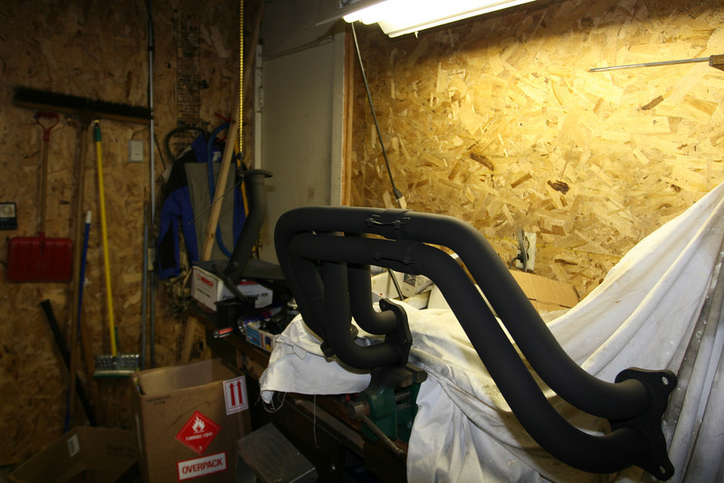

    New manifold and up-pipe after being sprayed with high temp coating

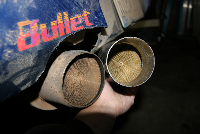

    I also picked up a new cat to replace our old one. The old one was a random tech 3" highflow. The new one is a random tech 3" race high flow which is considerably better.
    Martin and I helped Whisker's adjust the exhaust system by removing the flange at the downpipe to midpipe and by adding the new cat - we put this one farther under the car and got rid of the rear muffler section.

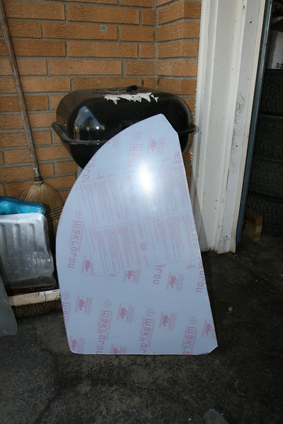

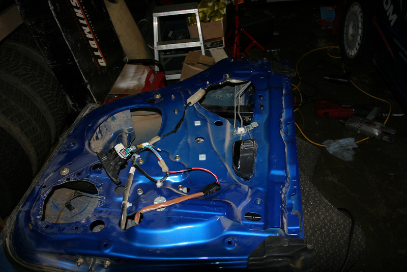

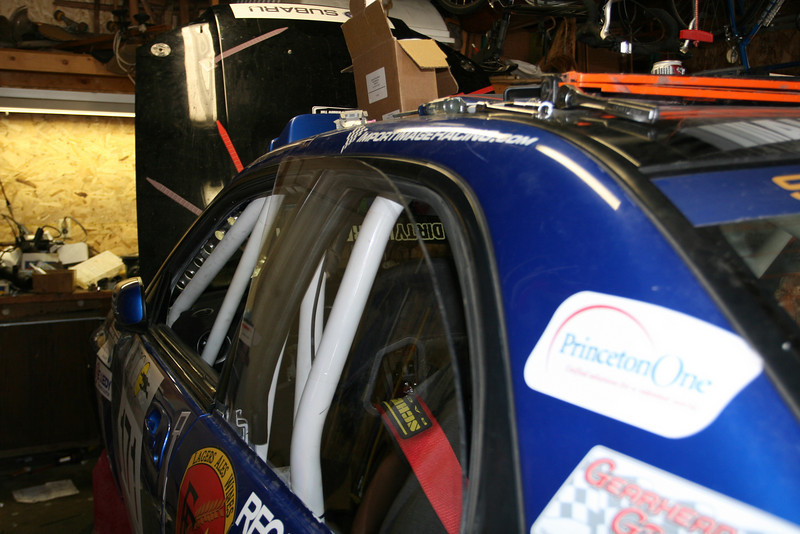

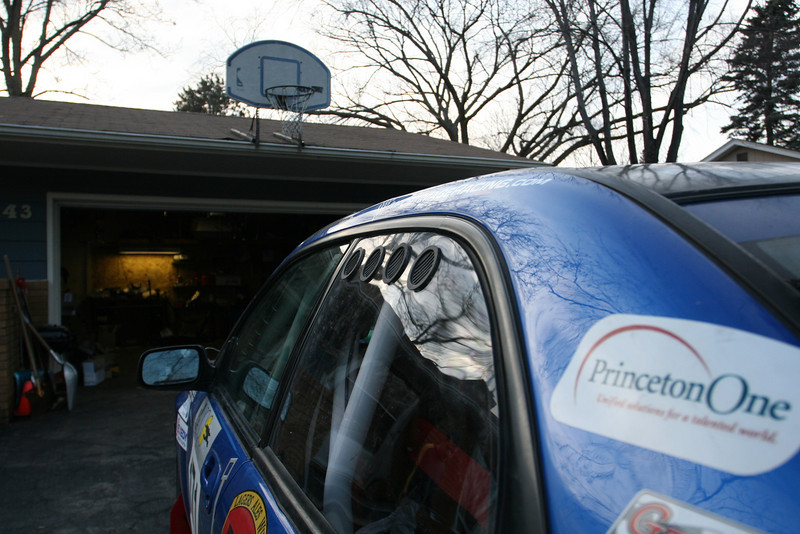

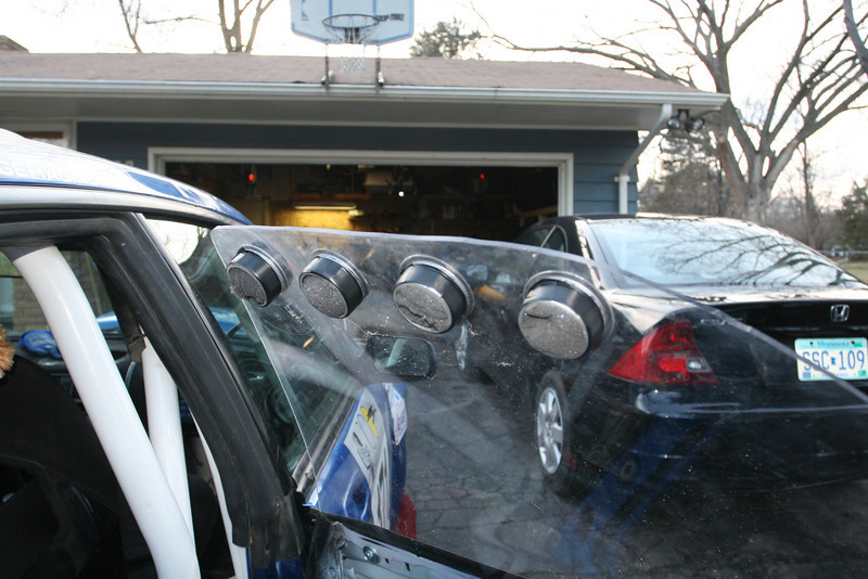

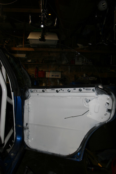

    We also began to put the car on a diet. The rear doors were gutted and lexan windows were fabricated. We saved 28 pounds per door doing this.
    full door
    gutted door

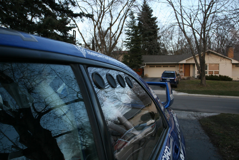

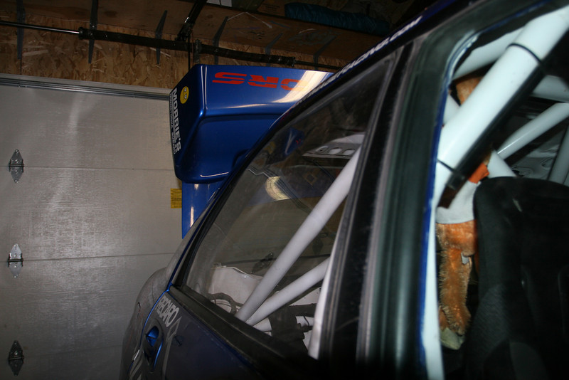

    I traced the windows on to cardboard and then from the cardboard to the lexan
    The lexan windows don't quite fit right in straight form. The require thermal forming to get them to fit.
    after forming
    we also put in air vents evo style
