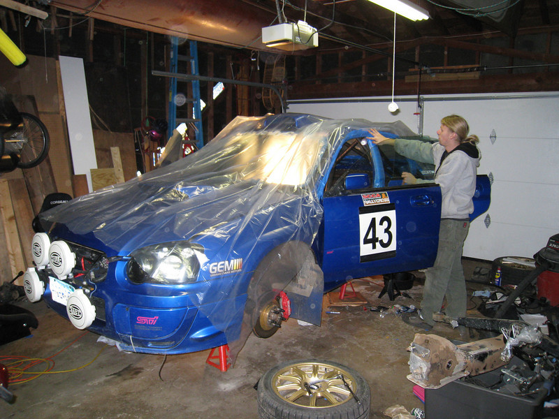

    here's the update for today:

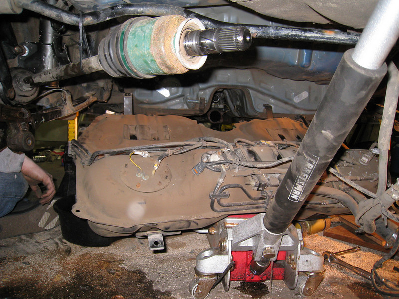

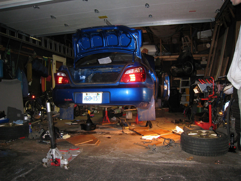

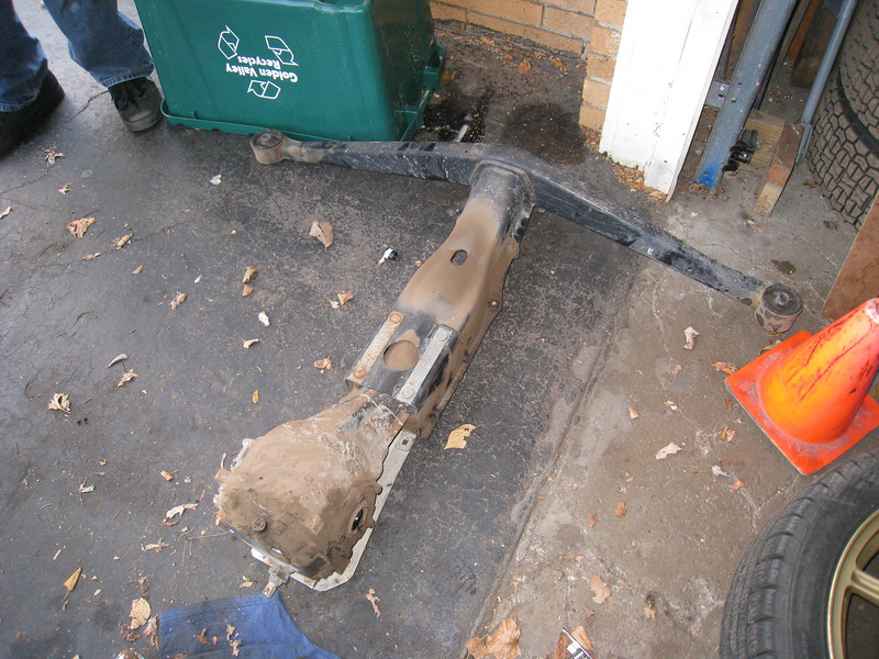

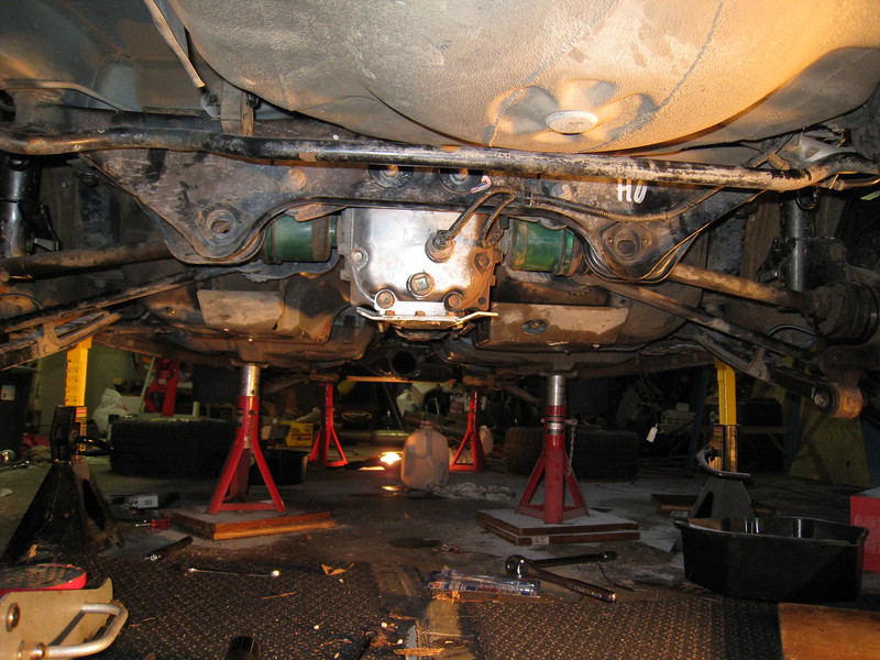

    Andrew and Nick came over to help, we started by finishing dropping the diff/crossmember to free the gas tank. I need to buy new bolts - the long ones that go through the rear lateral arms. I also need new endlinks and maybe rear lateral arms lol.
    diff out
    the objective - get the tank out
    messy garage is messy

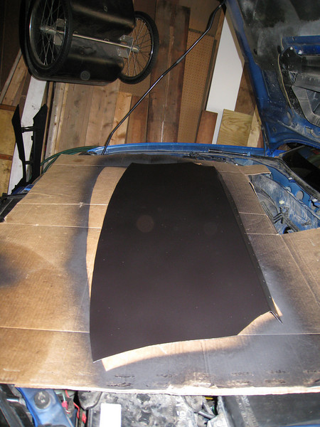

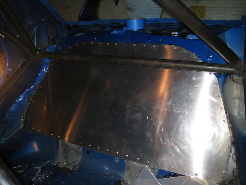

    painted my rear decklid block off plate flat black so it won't reflect (it wasn't painted in the engine bay lol, it was just sitting there to dry
    we finished riveting the pass thru block off plate with the tank out of the car
    masking off the windows for paint
    she's pretty much ready for painting tomorrow. think 10 cans is enough to do the interior?

    Wow, you were busy today. That gas tank was a real pain, eh? Good progress though.
  9. carl
    to say the least - and it was only needed to clean up some holes from when they were doing the cage (pointy metal by gas tank is bad) and to finish riveting the block off plate! the amount of work we had to do makes me feel as if I should replace it with a fuel cell, to help justify removing it lol. problem is, FIA FT-3 fuel bladders are not cheap

    eh, i don't think putting the tank in will be too difficult. All the emissions crap is in one big pile - I only had to disconnect the filler neck and vapor recirc hose from the tank. Charcoal canister stuff got disconnected when you pulled the fuel lines.
    plus, put the canister back in place and everything should line up.

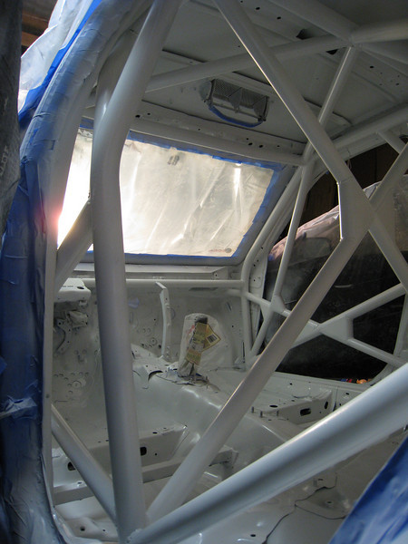

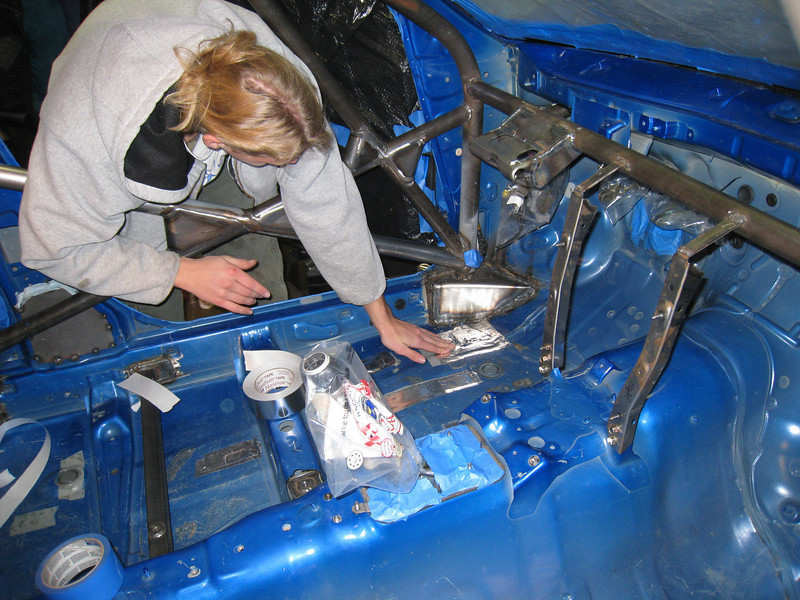

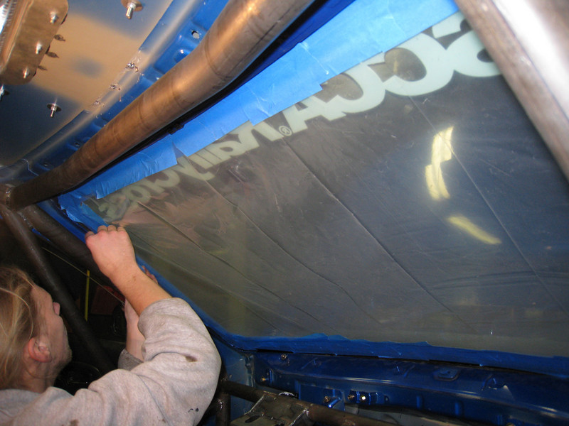

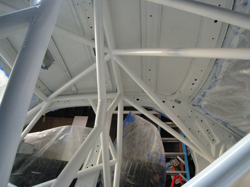

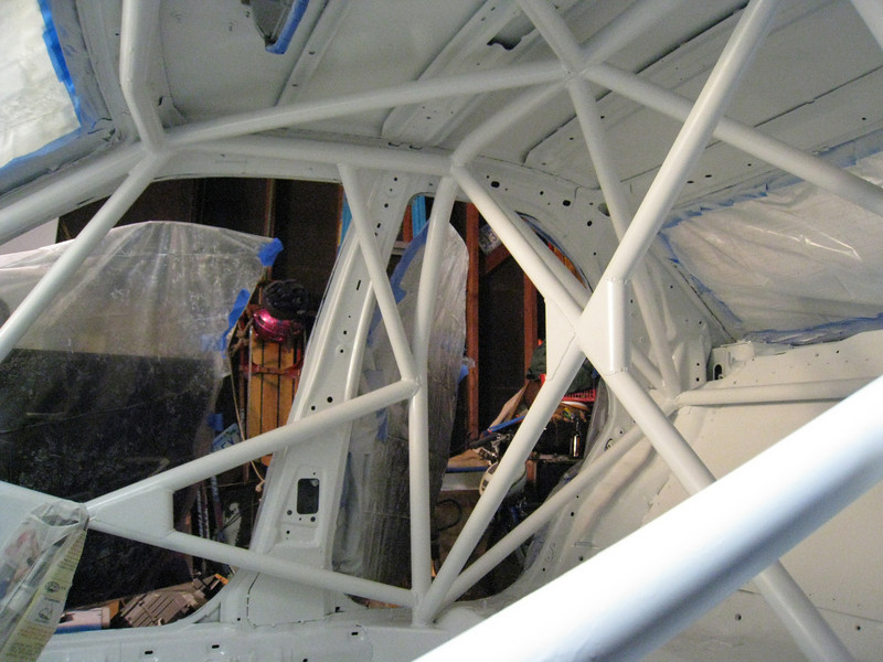

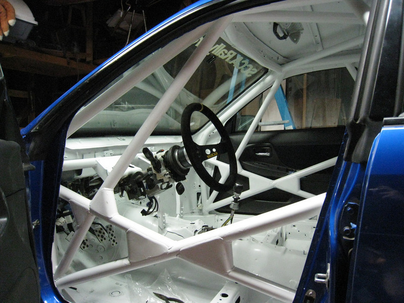

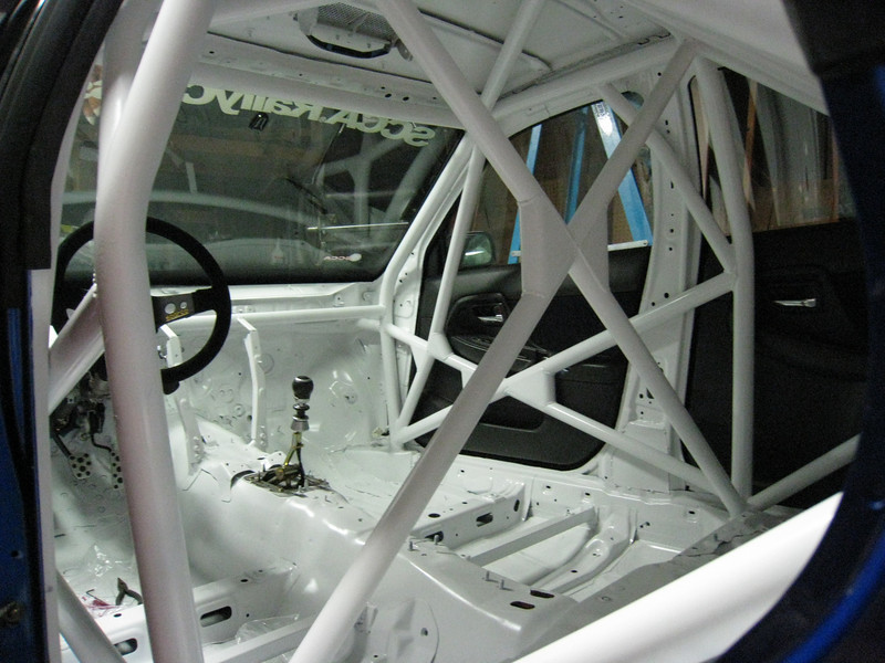

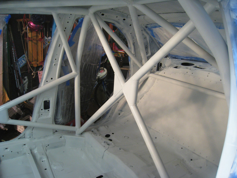

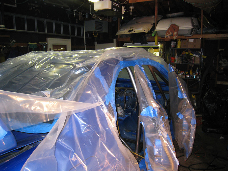

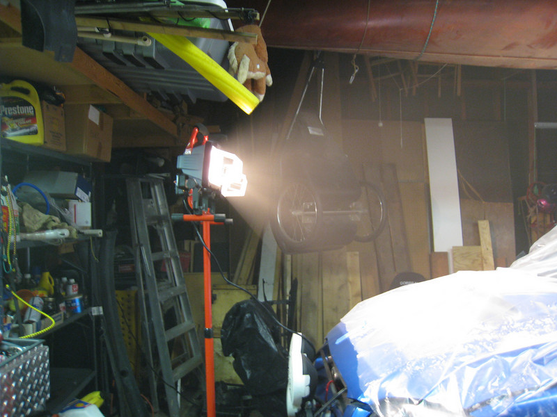

    well looking at the garage today I decided there is probably more of my car sitting on the floor than there is actually attached! anyway, andrew and I had a busy day of huffing paint fumes in the name of rust protection/badass rally interior
    everything taped off finally
    applying aluminum tape to cover holes/plugs (where all the old stock aluminum tape was - which they apparently apply before the car is painted as well)
    primer down
    ahh, delicious fumes! (thankfully we both had respirators - thanks mark for bringing out a second one and checking out the project)
    done

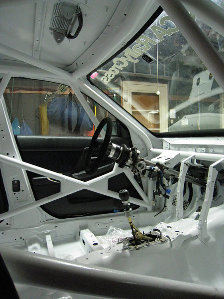

    anyway, onto the update!
    andrew and I rocked that thing tonight - got the tank, crossmember, diff, driveshaft, pedals, and steering column installed. also thanks to emily for coming over and feeding us pumpkin bars!
