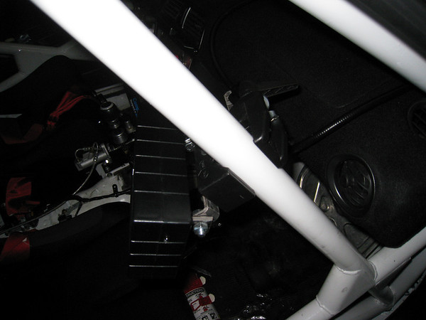

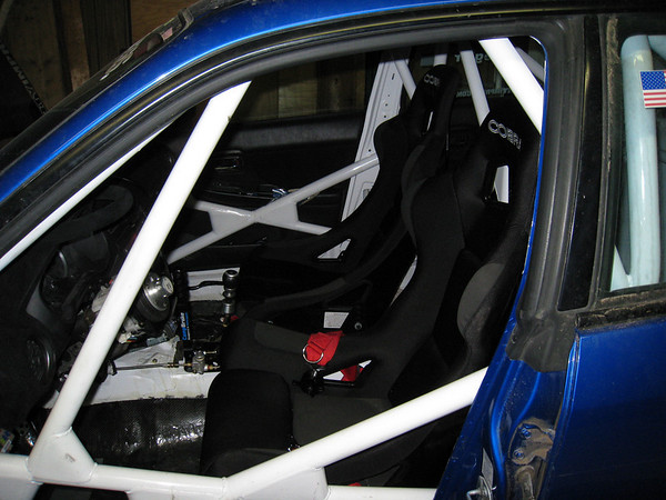

    There's no turning back now pal, its all or nothing!!! What did you come up with for an inside camera to help catch some of the action, did I miss this topic? I'll have to stopby again something to get a second look at the updated.
  2. TSTRBOY2004
    so do you have grab bars on the roof rails...
    you know for hanging out the window taking pics of YO-self
  3. Vector
    Vector Rally Organizer
    416
    Yes, that's what I understand too. Didn't notice what side it was on in the pic, just that it was mounted in front of the seat.
  4. Threshld1
    Threshld1 Well-Known Member
    Passenger side should be fine. Thats where CPD1 + 2 have their mounted in the cool Prodrive CF floor tray with built in straps.

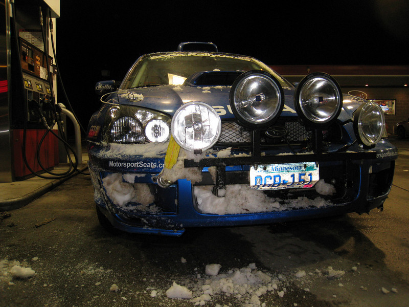

    This thing was dead sexy in the snow today.

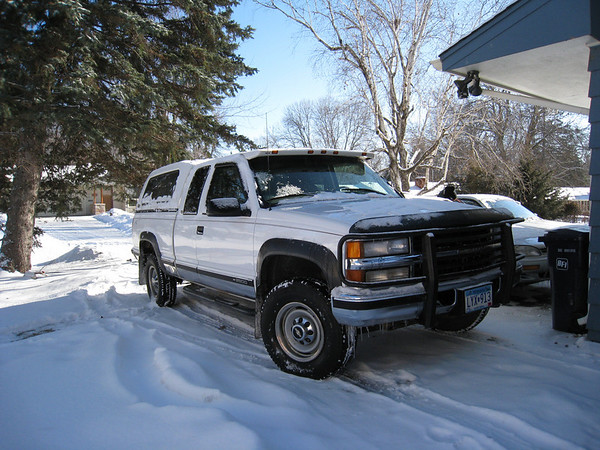

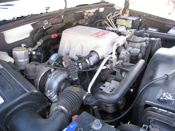

    got a truck - 97 k2500, 6.5L turbo diesel

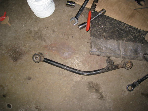

    custom bent lateral arm

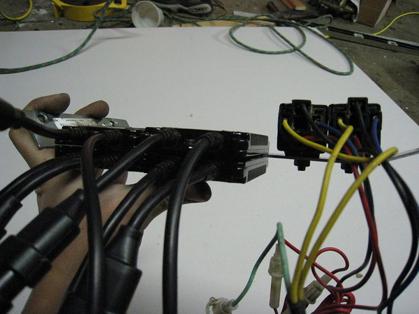

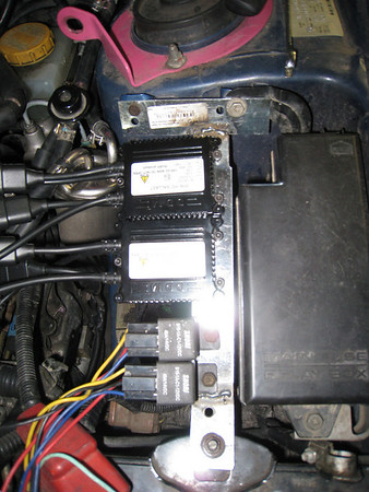

    made a bracket to hold my HID ballasts and relays for the hella 4000 and 700's. still have to wire them up. the 4000's should have ok cutoff, I kind of doubt the 700's will have any cutoff. I'll probably have to make a secondary reflector I can adjust to focus them.

  15. piddster
    Oh, and what kind of relays are those? I used a similar one under the hood for my radiator fans and it rusted to hell internally in about six months.

  17. carl
    the ones that came with the hella lights originally.

    The relay I used wasn't weather rated, and I'd imagine the ones that came in the Hella kit would be.

    yea these are the same relays that i've been using for the past year so they should be ok

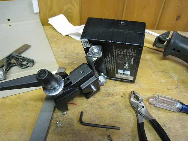

    "fixed" front bumper

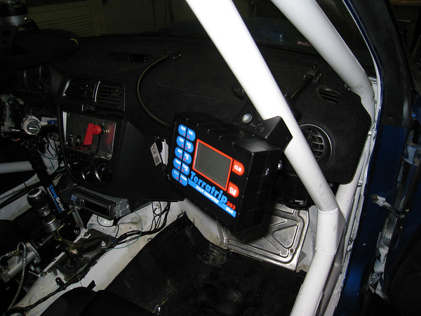

    Andrew and I needed to mount my terratrip so we went off to the camera store, bought a bar clamp for studio lighting as the base. Then we bent up some brackets.
    tomorrow I need to wire it up, add some D rings in the trunk for my spare tire tie downs and put the exhaust back on

    newb question whats the terratrip do?
  37. carl
    basically a very precise odometer with some other related features (time, speed). route instructions are associated with a mileage and you use the terratrip to tell when you're at a given instruction

    Essentially. Each instruction in the routebook is marked with a milage in 1/100 of a mile from the stage start checkpoint, and by using the ODO you can keep track of where you are.
    Some navigators work almost entirely off the incremental milage between the instructions, while some use the overall. Both have pluses and minuses.
    When running on stage notes, the ODO is a lot less important as long as things are going well, but can be critical to get back on if the codriver gets lost in the notes.
    In a TSD rally it's critical to know how far you've gone and in what period of time, as the goal (typically) is to reach the next checkpoint as close as possible to a pre-determined time, based on the speeds you've been given.

    Another key point of the rally odo is you can recalibrate its mileage output to match the odo that the course instructions are made from. Every car and tire rolling diameter will give you a different measurement for a distance on an odometer. Having the ability to run a odometer check at the start of an event and then change your rally odo so your mileages to match the instructions is huge.
