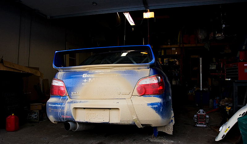

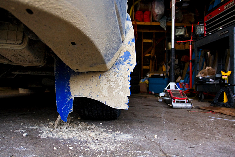

    still dirty from the road rally
    I'm kind of rough on mudflaps

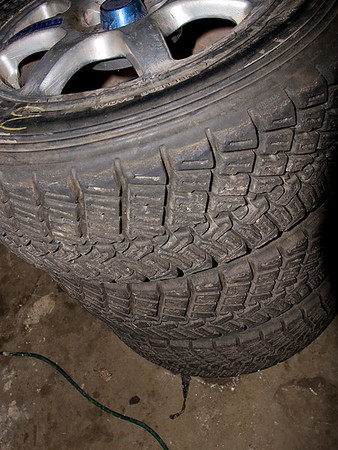

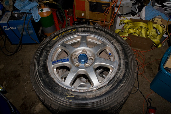

    picked up some more rally wheels and tires!

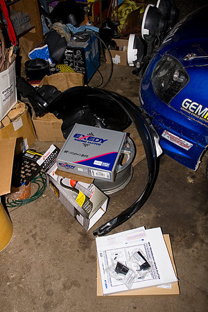

    exedy stage 2, fenderliner, t-belt, engine gasket kit waiting for a big install in the next few weeks (once the custom Wisecos arrive)

    You are going to love those KM6's.
  21. carl
    i need to find a 4th, i only got 3 lol

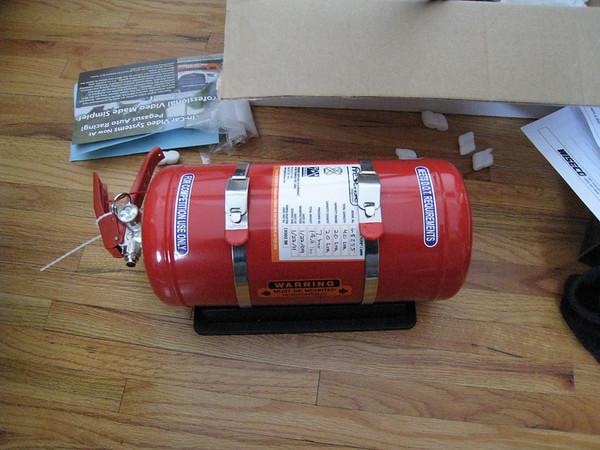

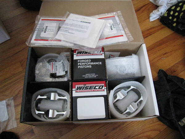

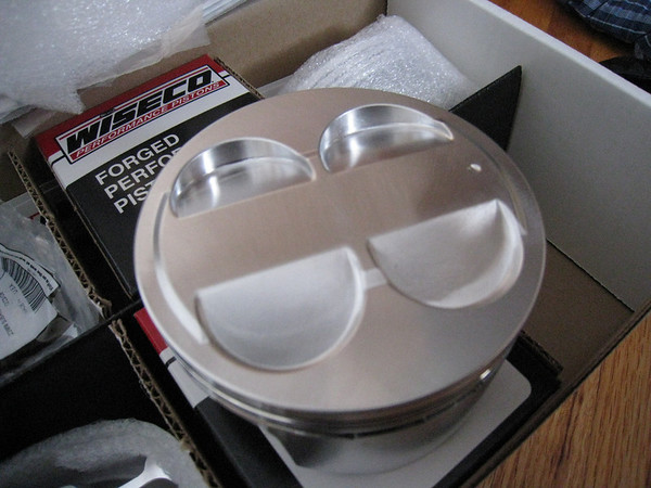

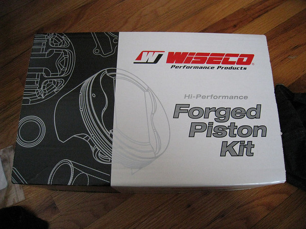

    hopefully we never have to use this!

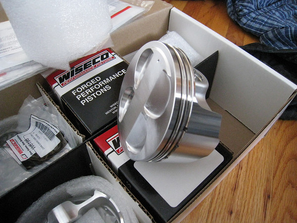

    oh boy, lowest sti hp/tq here we come!

    Man, those wheels get passed around more than (insert derogatory promiscuous reference here).
    I think they've been on at least 6 cars.

    High compression ftw! Very shiny bits. When is the car going up to graham?

  28. piddster
    Interesting that the pistons didn't come with coated skirts, since all their off-the-shelf pistons seem to have it.
  29. carl
    coating was an option. we opted against it due to the fact that the engine is so mild and will only be run for several hundred miles before being rebuilt for next year

    How much was that fire extinguisher? I'd like to get a man-sized one for my car as opposed to the weeny 2.5lb units.

    Carl,
    When I'm healthy again, I'm going to make some more flaps. If you break one of mine, I'll be impressed... I hope to be in the garage if not by this weekend, next week for sure.
  32. carl
    I already have new material sitting in my room. these ones are the material sold by rally-lights. I will be mounting them outside the fenders with L brackets instead of in the fenders. I'm also making some underbody flaps to try and keep some dirt out of the rear wheels
  33. carl
    I have the truck mudflaps you use for yours sitting in my garage as well - I'll be using that for a gas tank shield. That stuff wouldn't break, it would rip my bumper/fender off instead lol (why I stick with flaps that sit on the rubber side of the polymer family instead of the plastic side)

  35. carl
    sorry, didn't see that post lol
    the onboard system we are using (comes with 2 mechanical actuators and 6 nozzles) is from pegasus racing and cost $300 (4L and cheaper than other systems because it uses a steel tank instead of aluminum). We also have a handheld extinguisher on board
  36. piddster
    I have one of the cheap 2.5 lb BC extinguishers, but it was cheap and I don't think it is the most reliable. The instructions express that over 150 degrees is bad for it, which is easy to surpass in the summer heat.
    I'm just looking for a decent handheld unit that won't break the bank.
  37. carl
    yea that one is a fixed mount system. pull the release and foam everywhere lol
    edit, you could technically use it as a handheld. 4L is a bit unwieldy but a good capacity
  38. piddster
    I've read conflicting information about what type to buy. Some say dry chemical extinguishers corrode parts. The CO2 ones sound good but are about twice the price, and then there is the Halotron or whatever.
  39. Gridlocked
    Make sure you take your extinguishers out after the rally and let them sit in a way other than how they are mounted in your car. Shake them up every once in a while as well. If they sit too long in the same way, the junk inside doesn't work after a while.
  40. ScandiaWRX
    Now that's entertainment! Carl beating you in M4? Pull the extinguisher release when he isnt' looking and let the fun begin :)
    I heard tell of the one in Block's car going off at the Parc Expose at a rally last year (STPR?) Made a mess of Alex's codriver bag but only wrecked a couple pages in his route book.
    Amy
  41. sniper1rfa
    sniper1rfa New Member
    Yes, they do. Badly.
    I have a set of allen keys with all the black oxide stripped off from a drychem extinguisher. Nasty stuff.
    Halotron is a good multipurpose auto handheld, but the foaming stuff carl has is better.
  42. piddster
    How about CO2? That shouldn't corrode anything.
  43. carl
    shouldn't
  44. sniper1rfa
    Won't put out any fires, either.
