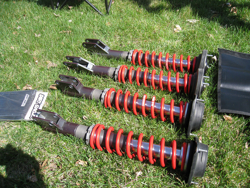

    finally the allwheelsdriven coilovers arrived
    it's based on a 40mm bilstein. 250lb/in h&r front springs, 200lb/in h&r rears. group n tophats

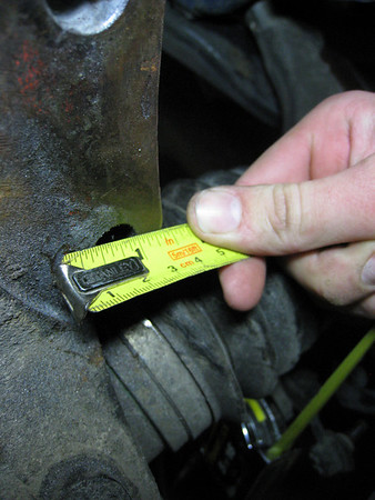

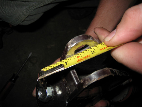

    the rears went on nicely but the fronts not so much. first of all the powdercoating had to be sanded down because it wouldn't squeeze over the knuckle. Then we found the gussets were about 1/8 - 1/4" too long and interfered with the top and bottom of the knuckle.

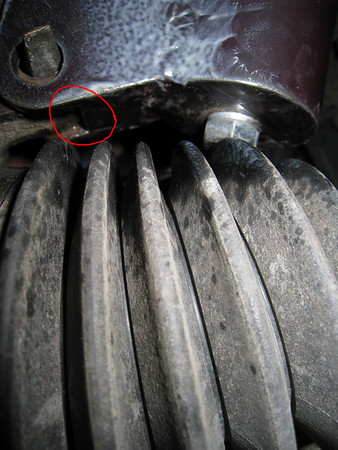

  8. greg donovan
    it looks like the bottom nut for the strut is also going to rub on the CV boot.
    i am surprised that the design is so wrong. that is a real bummer.
  9. carl
    strut is tilted downward because it wouldn't fully go onto the knuckle. there will be plenty of clearance when the thing is properly installed (later tonight)

    the fronts weren't test fit on their mock-up knuckle before shipping

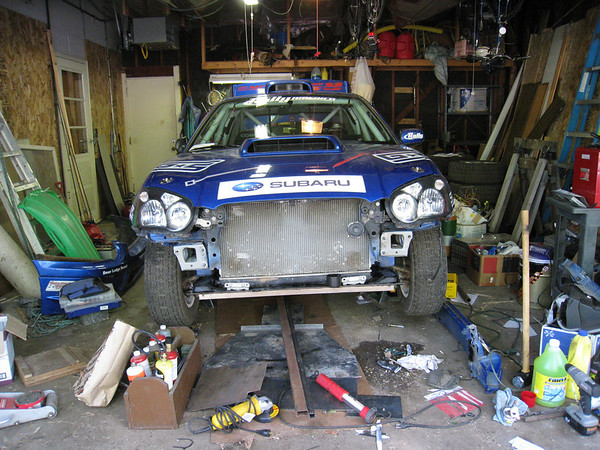

  31. carl

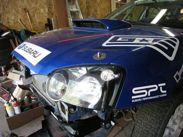

    repairs have begun
    (if you hadn't seen, we crashed it at gravity park - there was lots of this stuff going on)
    the car ended up lopsided (this pic looks slightly worse than it really is as the pic itself is slanted)

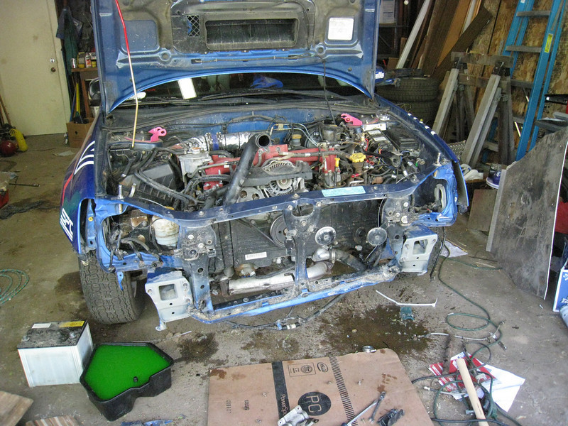

    we started by cutting of the bent front half of the subframe, removing the bumper beam, headlights and radiator to get an idea of where the largest bends were
    we then cut off the lower half of the frame horns, the lower radiator suppor and part of the headlight mount
    after a lot of hammering, bending and so on you can see the headlights are about even but the fronts of the frame rails are still off by about 1". this is slightly deceptive because the passenger's side is bent down and the driver's side is bent up (meaning they are each only about .5" off from proper alignment). for our purposes right now this is close enough. we are doing a quick and dirty fix for Nemadji Trail 2 - once we complete that rally we have over a month of downtime to do a more complete repair. for now the stock bumper beam has been modified enough to be re-mounted, we have another stock subframe and we will make a temporary radiator/skidplate mount that will bolt to the front of the frame. the permanent solution will involve more cutting, and creating a tubular front end (as well as gussetting and boxing sections of the stock frame rails)

    once we cut off the really bent stuff we started to make some headway. we tried tugging on it and making some jacking plates and chains yesterday but there was just too much twisted metal that was in the way to get anything accomplished

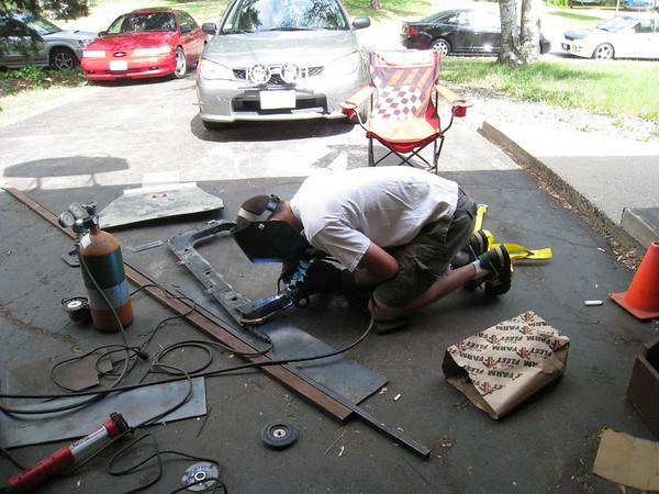

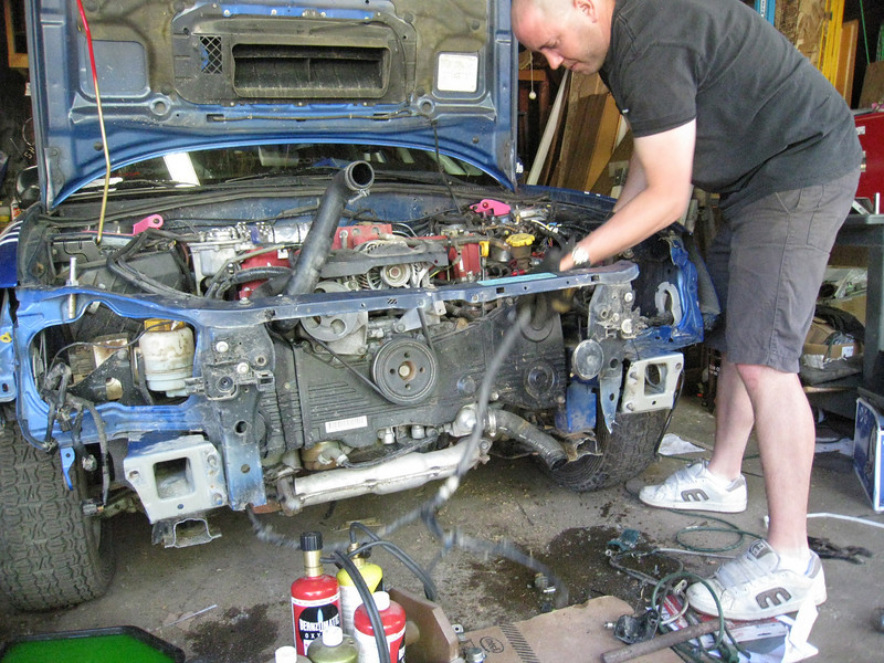

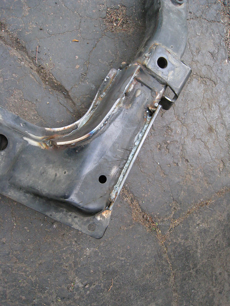

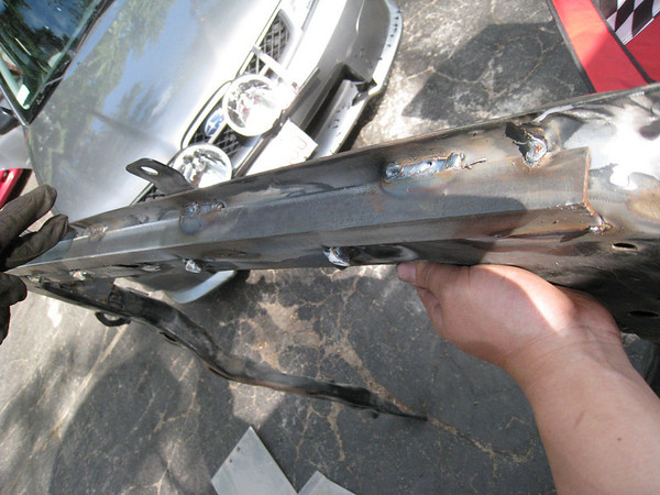

  43. carl
    dan welding supports onto our "new" subframe courtesy of dave
    we added reinforcements to all the spots that bent last time
    partially boxed ends of subframe
    L channel added to front of subframe
    headlight mount reattached
    it's starting to line back up
