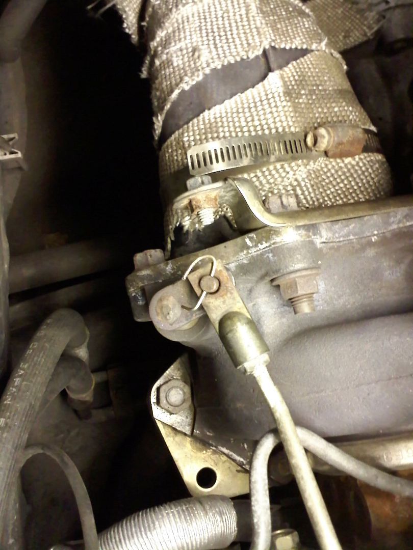

OKIES, I thought VERY HARD to try and figure out WHY my perfectly good working turbo that was JUST BOOSTING 20psi all of a sudden stopped working. If a turbo that was failing stopped working, you'd see symptoms already, you'd hear weird noises. I was testing it and going WOT through the rev band.....it HIT 14psi from 6000-7500rpms. It'd ONLY start to build boost once you got to 4500rpms and up. The turbo started to come back ALIVE!!!!! The NOISES where NORMAL turbo noises where it started to spool it'd make a nice whistling sound. THEN the thought came in mind that the little clip that was holding my wastegate arm onto the flapper was worn out the last time I checked it. BING!!!!! BING!!!!! BING!!!!! I got some light and looked through the little gap of my modded stock heat shield. I then took off my heat shield and voila!!!! The arm was WIDE OPEN!!!! I found a little piece of metal from my tool chest and stuck it in. muahahahahahah BEHOLD!!!! BOOST AGAIN!!!!!! it's nice to see 20psi again!!!! BUT I will still have this setup in mind. Sorry if I dissapointed you guys.
How lucky was that to have a hole small enough to stick a wire thru to hold it in place. Boy this season has both of us experiencing the same boost issues. LOL
yes, boost issues..... Nuke said did I think of your boost issue when I was thinking of mine. ahahah That didn't come in mind. But on man I love my turbo's response with my JDM style wastegate setup.
