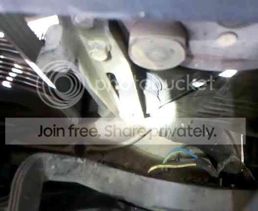

    basically it screams constantly, slightly more when engine is cold, but still obnoxious because you can hear it from the driver seat at stop lights etc. and out side of the car as well.
    cell vid, should be able to hear the noise, what i am wondering is what is the name for that pulley? or would this be the ac compressor? does one fail more frequently?
    -Dan
  2. Bielke55
    That is your AC Tensioner Pulley. We have those in stock. Just becareful when taking it apart that you dont snap the pulley holder arm.
  3. turbo_turtle
    Yes, the A/C idler pulley is what it sounds like. Not sure if you've done your timing belt and all those pulleys, but it could be one of those pulleys/bearings behind the timing belt cover. The A/C idler pulley is made of cheesy plastic and can easily break, it doesn't use ball bearings... just a solid bearing.
    Untighten the pulley nut first, then back off the adjuster a lot, then you can see how much wobble/play it has. There is normally a small amount of play even when the pulley nut is tightened. You can try running the engine without the pulley (for a short amount of time) and see if the noise goes away. Napa carries that pulley, but it is crap compared to a OEM replacement. Also, check to see if the pulley is rubbing against the timing belt cover.

    I had the problem that turbo mentioned about the pulley rubbing on the timing belt cover.
  5. tangledupinblu
    9,058
    What Bielke said talldan! My pulley went out this spring. It's the bearings sounding like hell. Cheap fix after a quick stop at Tonka parts.;)

    problem fixed, didnt buy a subaru part because they only sell American cars here. also did the belts cause they were not ideal looking
