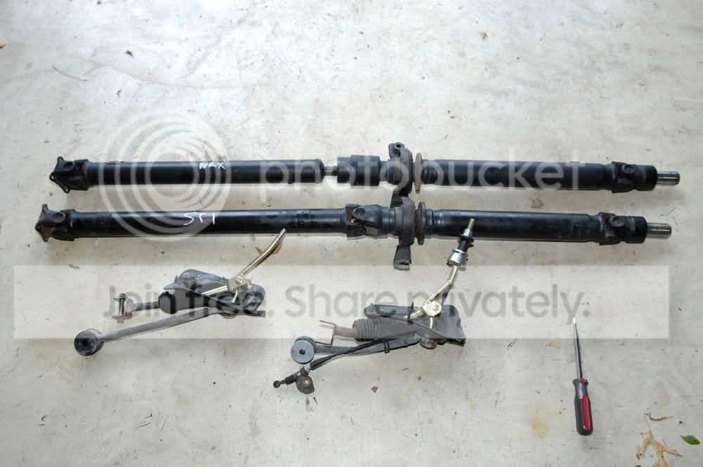

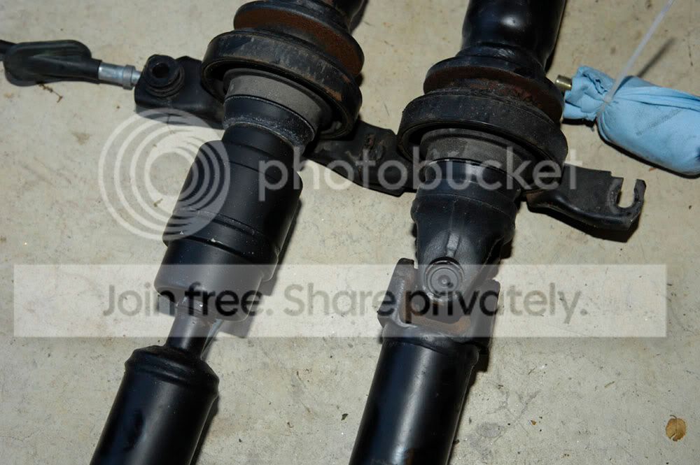

    I have a wrx one laying in the garage if you want to borrow it and compare.

    hmmm....hard to tell from that pic. looks like a CV-type, so no flange in the middle.
    found some measurements in the FSMs. looks like all 5MT front driveshafts (EA and EJ) are about 25", +/- ~1/2". measured from the center of the u-joints. So even if I could put the EA82 bracket on an EJ shaft, it probably wouldn't solve the problem.

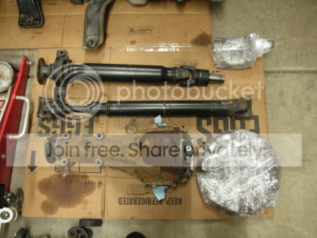

    Chux I left you a VM. I checked out my 4EAT driveshaft today and it is a 2 piece unit. I think it was 57.5-58" long from end to end. Here is a big picture of my 4EAT driveshaft w/ a tape next to it for reference.
  16. Chux
    1,507
    yea, got your message, Thanks! I don't think it's quite right. close....but not close enough. I think if someone local had one, I'd try it. but in the interest of getting this car done as quickly as I can.....I'm just going to have my spare modified.
