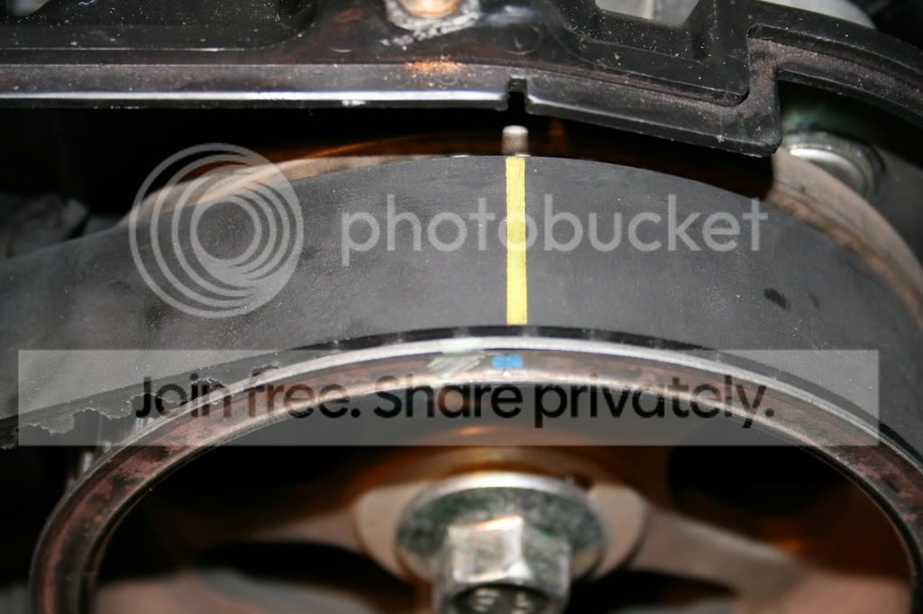

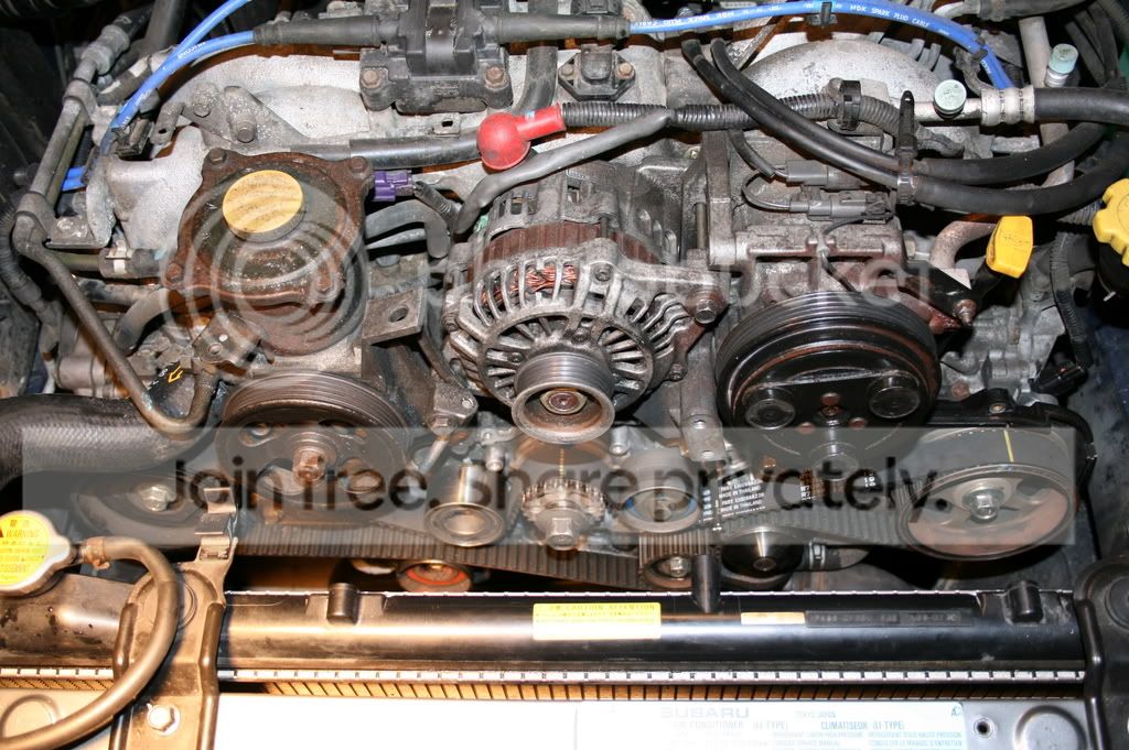

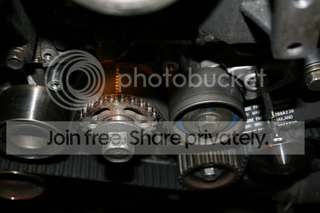

    Hey guys/gals! I'm replacing my timing belt and im to the point where im about to put the new one on, and pray i dont f up my engine.
    would anyone like to come check up on my work to assure i've done it correctly?
    Your help would be greatly appreciated!
    Did i mention that i have plenty of beer?
    Thanks!

    take a pic of it when your done and we will tell you if its correct

  4. Snowbum
    Snowbum Well-Known Member
  5. Snowbum
    Does that look right?
  6. fobiawrx
    fobiawrx Fabiola
    make sure it lines up with the other came gear and you should be good to go. with a ratchet on the crank pulley bold turn the motor over twice and see if the marks line up again. if they do then you are good to go.

    sweet thanx dude, ohh and it lines up :)
