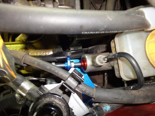

    Projects are fun but when it's your daily it can get a little hairy...
    Driving home from work the other day my clutch pedal smashes to the floor and won't come back up. Well that sucks, I just replaced the master and slave cylinders last month, what happened? So I limped it home and took a peak.
    First off, that's a terrible weld whoever did that. Second, the right hand stud is broke off and the master cyl pulled it through the firewall.
    A junk yard trip and $20 later and I've got myself a pedal assembly out of an 06. (And some nice floor mats)
    After pulling the old assembly it was worse than I thought.
    So, as you can see both studs were broke off, one of which looks like someone threw some hot metal at it and called it good... It's a wonder it lasted as long as it did considering that every time I pushed the pedal the master cylinder was pulling and flexing the firewall and eventually resulted in bad things happening.
    So, I cut a couple little "brackets" out of some scrap steel (one for the inside and two on the outside) to sammich it all together. A temporary fix (hopefully if I have time to tackle it later) but it'll do.
    After wrestling the "new" pedal assembly in and getting it all hooked up, I had my wife depress the clutch pedal while I watched in the engine bay. Little to no flex, whew.
    Okay, so I realized this issue must have been going on since I bought the car because now with the new pedal assembly in, a new master/slave and newerish clutch it feels like a brand new used car. Pedal response is awesome and now I have to get re-used to driving it.
    Through some research I learned that aftermarket brackets are specifically made for the clutch master cylinder to keep it from flexing the firewall. I believe the issue being remedied is the tack welds on the inside of the firewall come loose with repeated use? Either way the same would work for my application as well. They are spendy though at $135 from Rallitek

    GrimmSpeed makes a master cylinder brace if you were unaware. Nice piece too!
  33. idget
    There's this style as well.
  34. JaloP
    JaloP Well-Known Member
    209
    Is that for the brake cyl though?
    I was unaware :unsure: heh... I keep being reminded that this whole car modification/maintenance thing is still fairly new to me.
