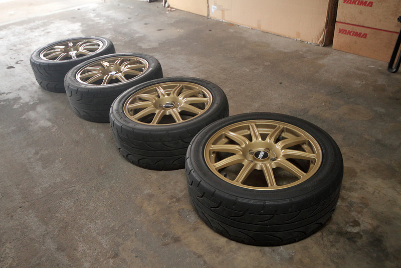

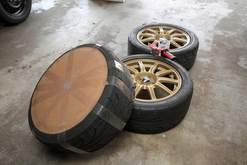

  32. xluben
    I have a DOT/SNELL 2011 helmet, but I'm not sure if it is FIA approved. I also have 235 series Star Specs on STI BBS wheels that are a lot lighter than the stock ones. I am planning on installing new pads/SS lines/fluid before next summer, possibly bigger brakes down the road. I don't really know what to look for in terms of harnesses, but I do know that the normal seat belt wasn't really cutting it when I was at the track last summer. I am definitely planning on doing more track time. I hope I can find a good instructor to teach me how to drive...

  37. happyfeet
    happyfeet Member
    thank Ben for giving them to me!:bounce:
  38. Musashi
    What is it with Subaru guys and using small rubber? :rolleyes:
  39. xluben
    255's coming soon. Decided not to go wider to save weight. Hopefully that pans out.
