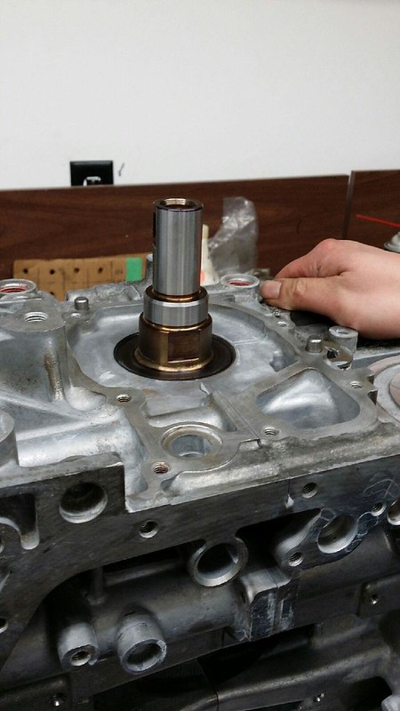

    Some parts came into NF today:
    Not at NF, but will be going in as well:

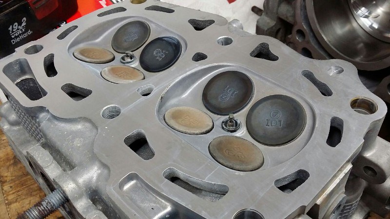

    E85 is still up in the air, but will more likely happen this summer when I have an income and not in school anymore.
    Heads were in good shape. So those'll stay how they are.
