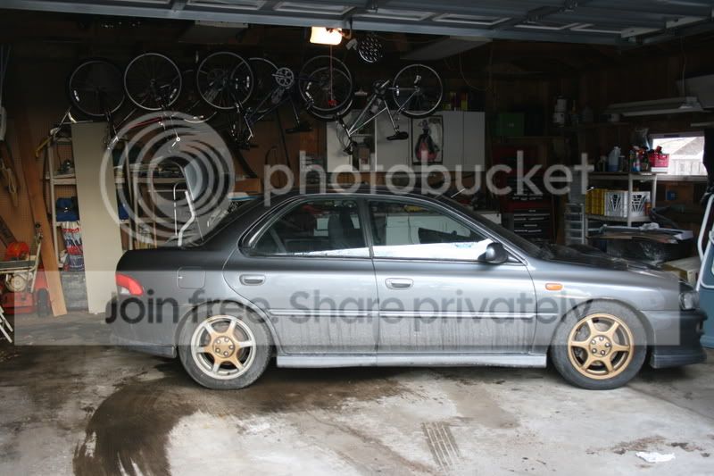

    should have posted these when i made the thread. but here are some pics from the night

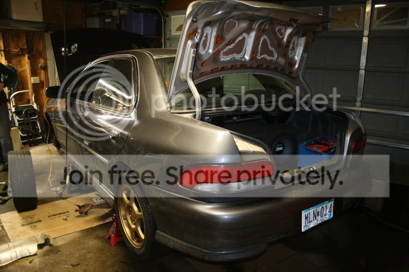

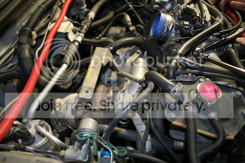

    its starting to look like we are actually doing anything

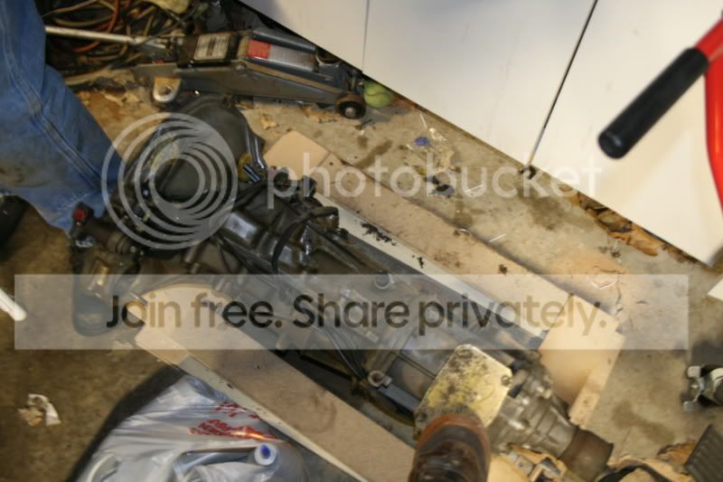

    the new Tranny. WHOOOOOOOOOHOOO!

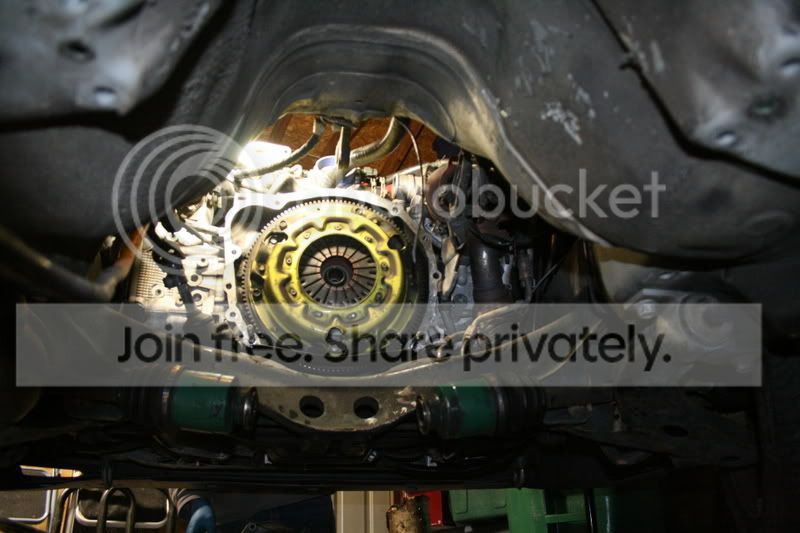

    finally got the tranny out....half way point and it felt good. look at that nice clutch mmmmmm
