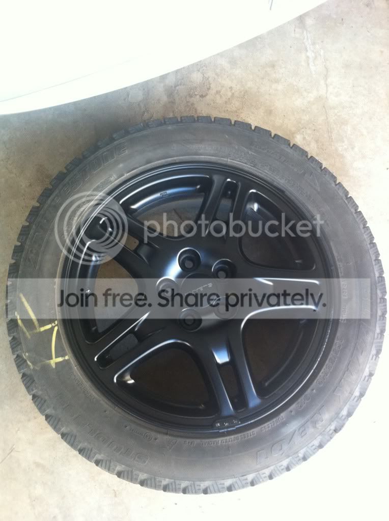

    2002WrX Well-Known Member
    I just did mine last week, scuffed em down with 3m pads, one layer of nason self etching primer and one layer of plastikote hot rod black(flat black)
