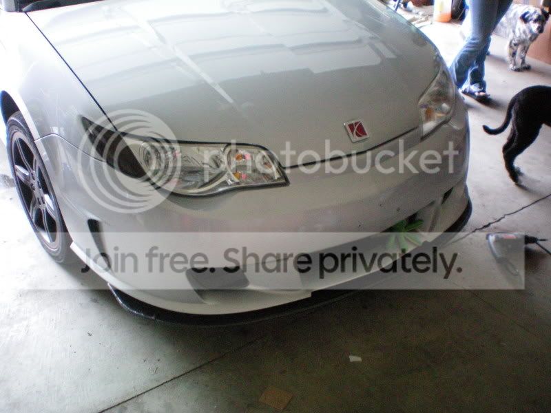

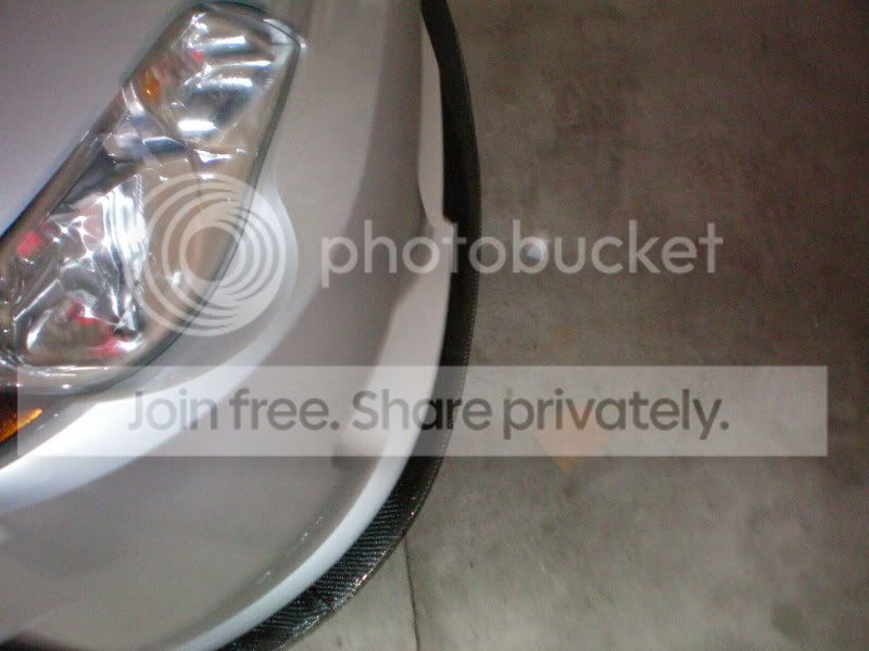

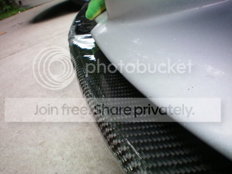

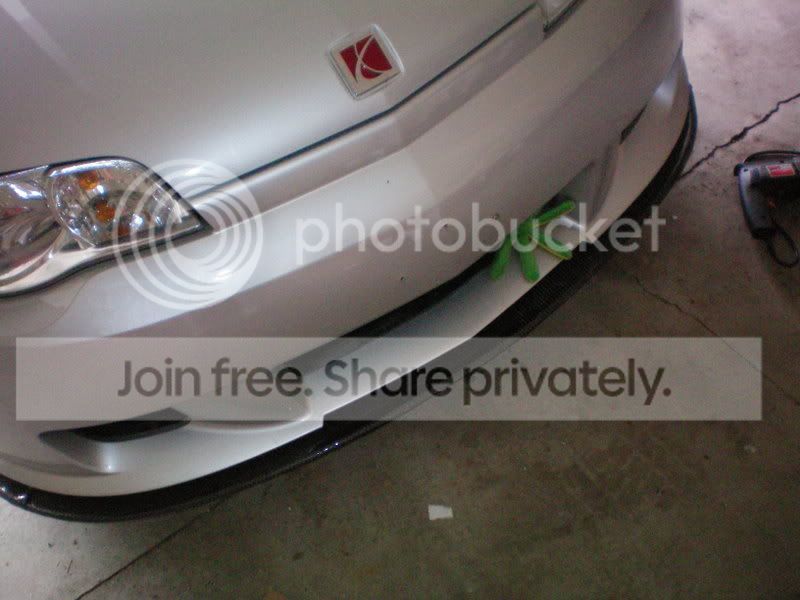

    so my friend decided this weekend that he was going to make a front lip for his car, because there are not too many aftermarket things made for it.
    made a mold out of stiff styrofoam, molded it to the shape he wanted then layed the cf over it.
    it turned out pretty good for doing it on the garage floor lol.
    so then with some leftover scraps i made a license plate delete cover thing lol
    cut the shape out of cardboard and then layed the cf over it.

    looks really wavy, good for a diy though

    Looks pretty good though, are you using a mold or free hand, either way not bad. I am considering getting some of that work done myself.
  5. piddster
    Not bad for a wet layup. Its really hard to get it even without vacuum bagging it.

    yes very hard! especially when you dont have a very stiff form to stretch it across.
    still debating weather i like it or not, i will have to wait and see what it looks like out in the sun, might just replace it with some aluminium. but they were just some scraps so i figured i would give it a try
