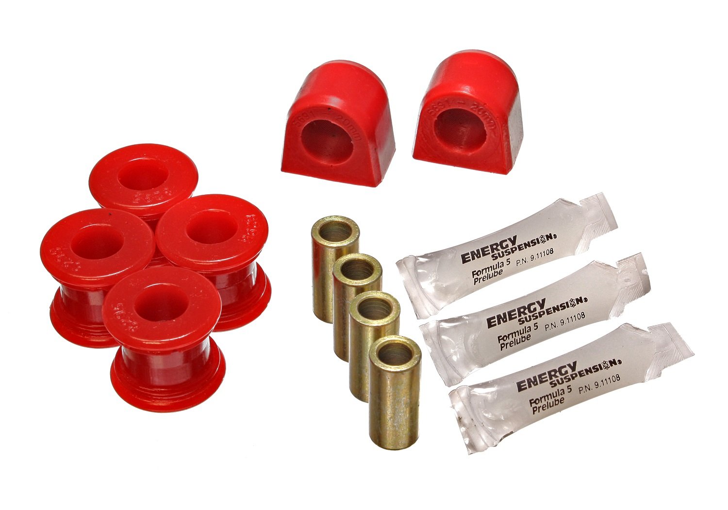

    Mine are the same as these but black. They're the 4 similar ones, with new sleeves. That big ass outer lip on each end has to get shoved through an opening small enough to be tight around the center area. It was pretty interesting last night. Finally gave up about 9:45.

    Aaaah ok, now I understand! So I'm guessing you removed the old bushings from the endlinks? I could see how it would be tough to insert the new ones. A press might help, but I'm not 100% sure.
    In my opinion, I think you would be fine cutting them in half and sandwiching them in there. I've used split bushings like that in the past with no issues, and I don't think the case would be any different for the end links.

    Put the bushings in boiling water for a few minutes, they'll become much more pliable, and then dry them off quickly, and press them into the endlinks, which you want to liberally coat with lube beforehand. Don't put anything through the center hole of the bushing, because you want the poly to be able to squish down into that void. A couple of pieces of some hard plastic or metal, one on either side and into the vise.
    And in case it's not clear, don't put the metal center sleeve in until after the poly piece is in place.

    Well, actually was a dry, rather chilly evening out there. I ended up slicing them in half with a utility knife. Was able to push each side into its little locking groove. Pressed the sleeves in place in the vice. Rest of the install went rather well. Will hopefully have good news tomorrow after the commute to work and back.
