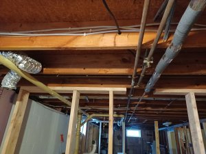

  16. euro
    euro Well-Known Member
    1,069
    20220403_163410.jpg 20220403_163436.jpg 20220403_163608.jpg Office, laundry room and bathroom have partial walls. Plumber comes out in a few weeks to bust out concrete to install the grinder and drains before we finish framing.
    Lean-to on the shed is after or during that to store the dune buggy.
  17. pillboy
    3,725
    What are you putting in for a ceiling? With all the mechanicals, I just couldn't bring myself to drywall over it and did a suspended ceiling.

  19. euro
    1,069
    The supply and waste pipes are pretty ruined from multiple moves of the laundry room from past owners and some BS plumbing they did to add the basement bathroom. Later this year We'll be ripping it all out and moving the water heater to a new utility closet with a pex water supply manifold so there won't be any pipes in the way to run normal drywall with a small electro/mechanical tunnel from the laundry room to the bathroom utility closet.
    Should have about 50 feet less of water supply runs in the house and about 30 feet less of waste runs after getting the plumbing completed.

  21. predavore
    predavore Well-Known Member
    700
    Get rid of those strap taps. Those aren't code anymore.
  22. euro
    1,069
    It's all going. 100% new pvc drains and copper supply is bring replaced with pex.
    predavore likes this.
  23. predavore
    700
    I ran new runs back to accessible valves. My fridge has a shut off valve under the sink. I don't want to pull a fridge to shut off a valve.
