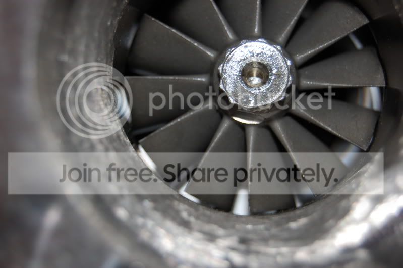

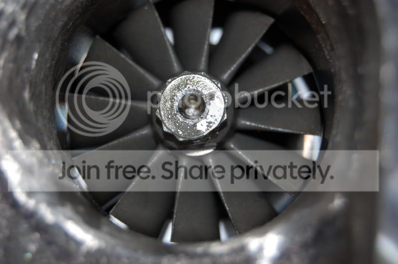

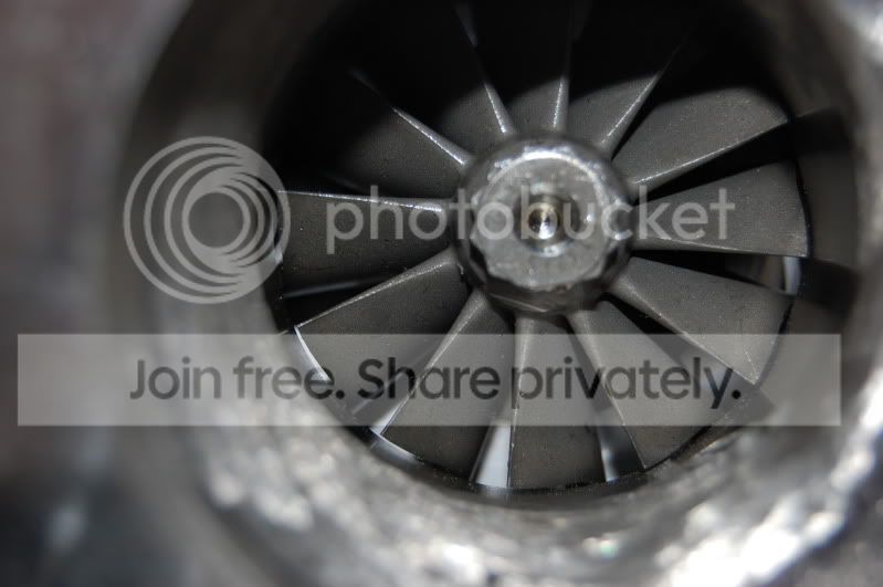

    I recently just purchased a turbo that came PnP'd. Upon further inspection it looks as though ther person that did it knick'd the shaft on the hotside, the fins look fine and untouched, but there is a bit missing from the cap I guess you would call it on the shaft. I am wondering if this will effect anything at all?

    There are sometimes bits taken out of the "cap" as you describe it to balance it.... Pics would help muchly.

    The turbo probably has the "notch" on the shaft becuase that's how most companies balance the turbo. Who did the PnP work?

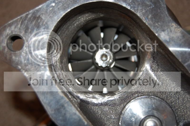

    Here are the Pics

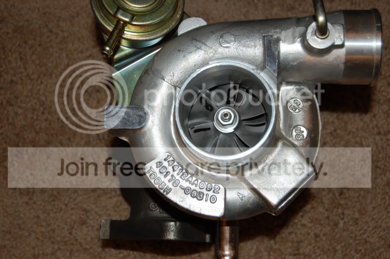

    Not that it will make a difference but this is the turbo its on.

    That is from balancing. If it was knicked by the person who ported it, it would look a lot rougher.
    The turbine housing is generally removed for porting anyways.

    Yeah we're still in the same spot. No need to bring it by for the shaft, It's definitely cut like that for balancing. The port work has a lot to be desired though.
