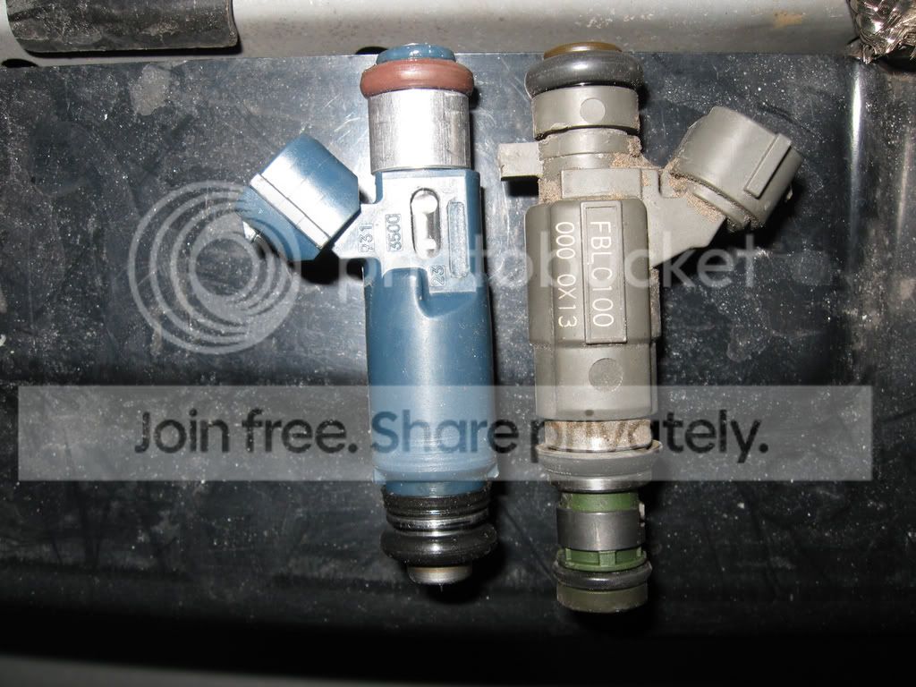

    So I got some new injectors from Deatschwerks a few months ago and finally got around to putting them in. Well, I ran into some problems. Below is a pic of them side by side...

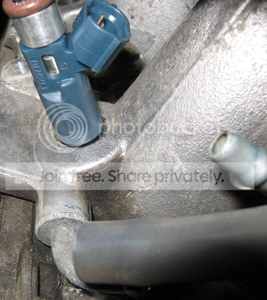

    :ugh: Notice the difference in length. Well, when I went to put them in, it only went this far...

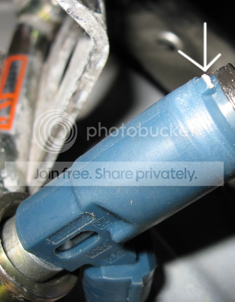

    :( I didn't feel it "pop" in, and it basically fell out when I went to pull it out. I looked around the opening to make sure I hadn't dropped something in there like an idiot. then I noticed this...
    :mad: It's a crappy little tab thing on both sides of the injector (180 degrees from each other). These tabs aren't on the stockers so I immediatly went to Deatschwerks' website to make sure I hadn't F***ed up royaly and ordered the wrong ones. I have the right ones according to the website....they even say, and I quote, "100% drop-in fitment - plug and play with no adaptors"...

    Those look like the WRX injectors that i got from them..
  3. mantismn
    mantismn New Member
    I went to the Subaru -> 2.5RS -> Impreza 2.5RS (99 and up) section....and that's what I got...
  4. Jackstand
    Jackstand Well-Known Member
    Im telling ya dude those look identical... do u have DOHC
  5. w_o_t_boy
    w_o_t_boy Well-Known Member
    Ya, those are the modded WRX injectors.
