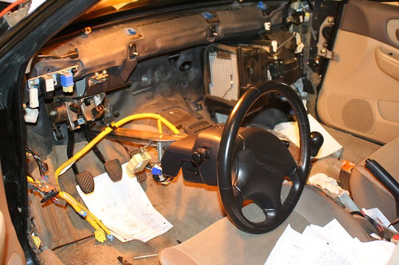

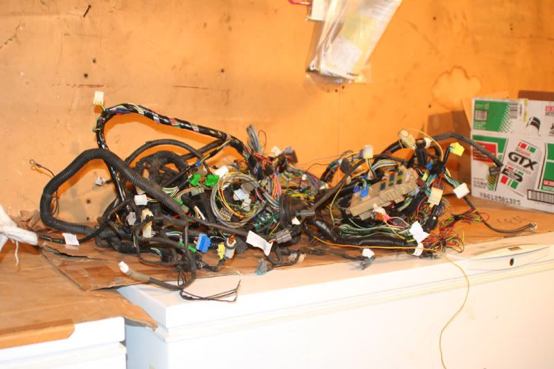

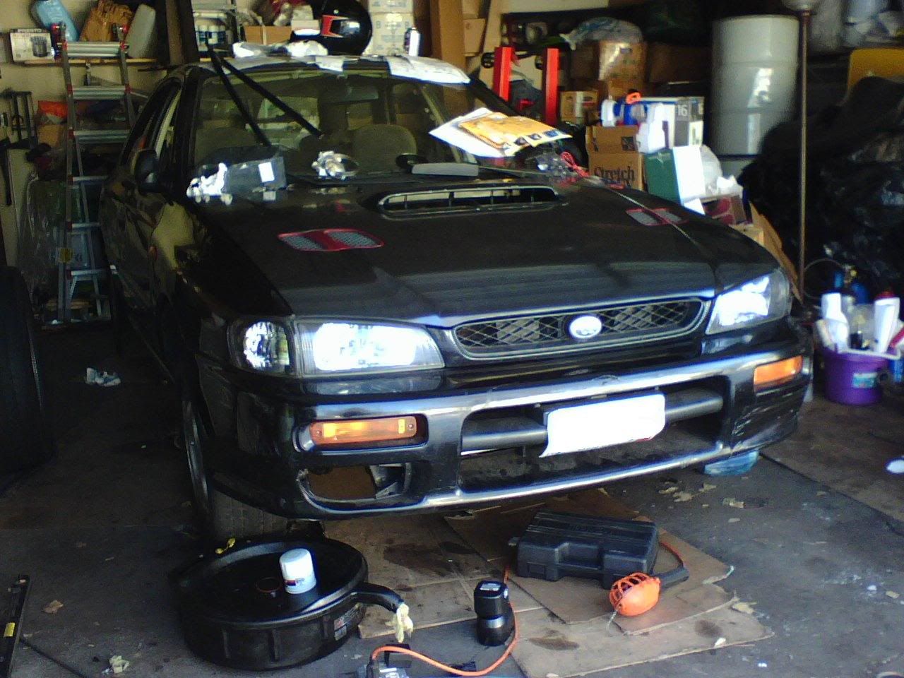

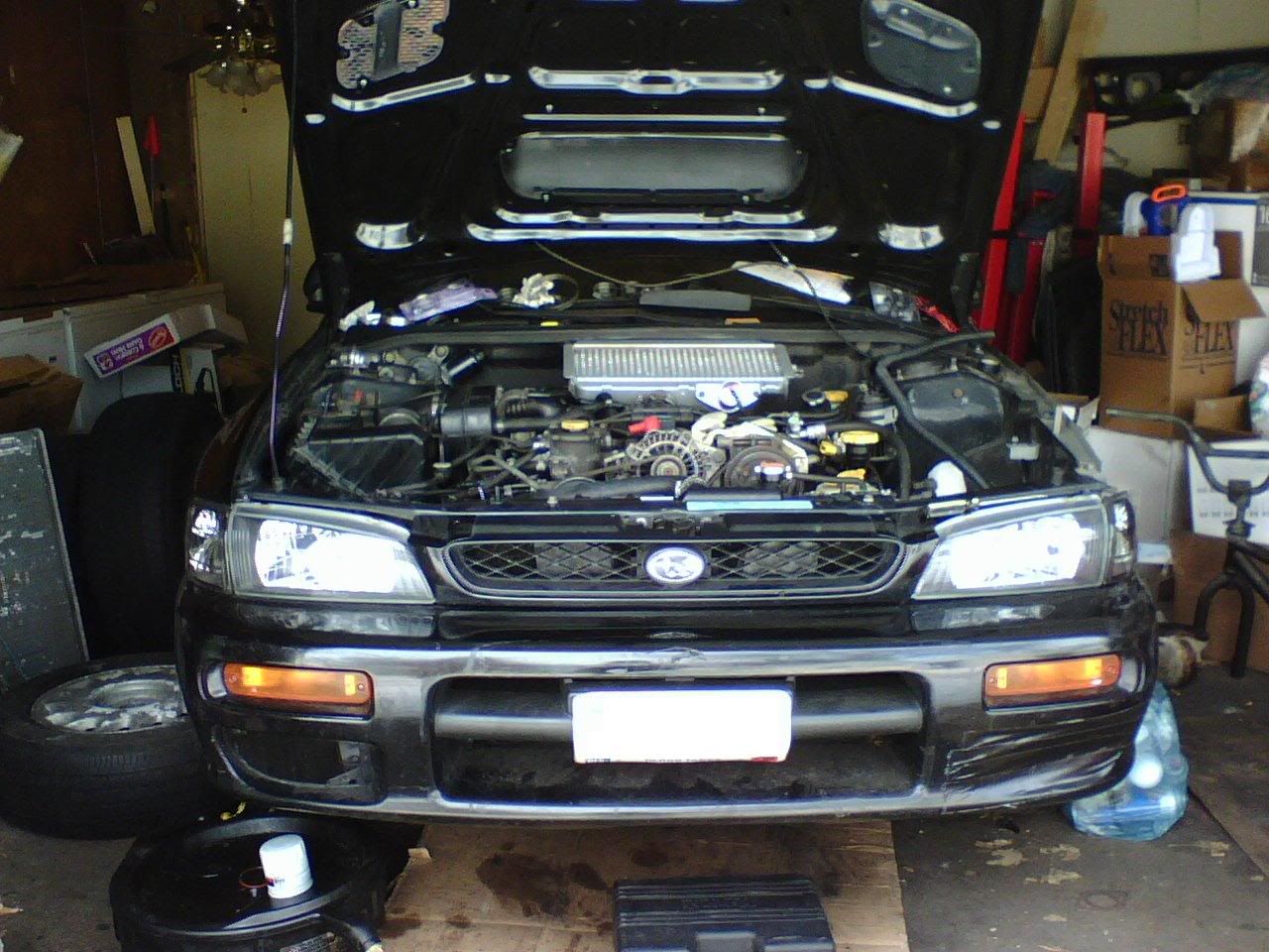

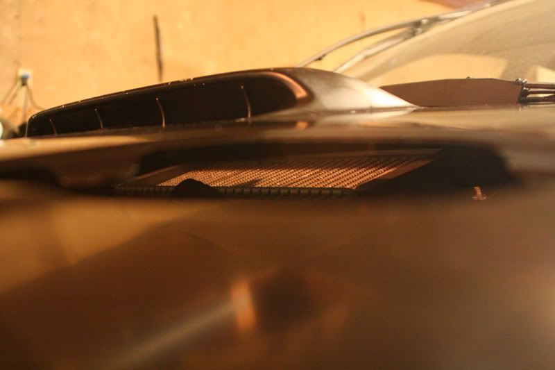

    SO here are some progress pics...lols
    it peeks from the ventless hood
    so I took out all the wires.....
    and it's all empty now.....
    I also dropped the headers and uppipe to get ready for the NEW headers w/ uppipe. POWER!! MUAHAHHAA

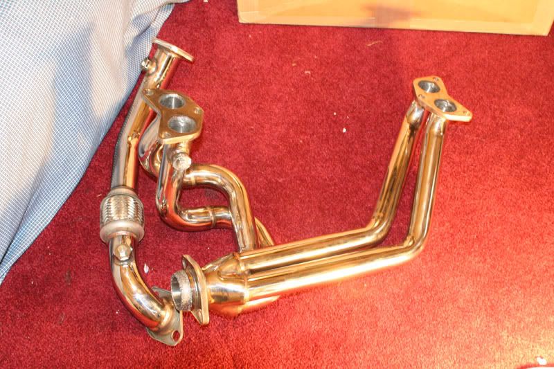

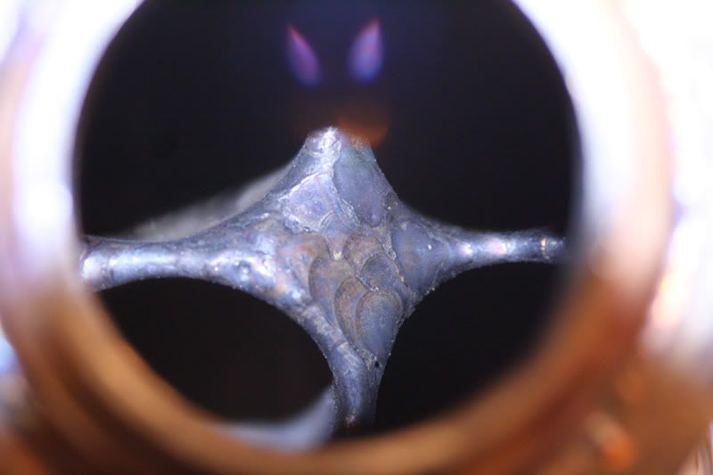

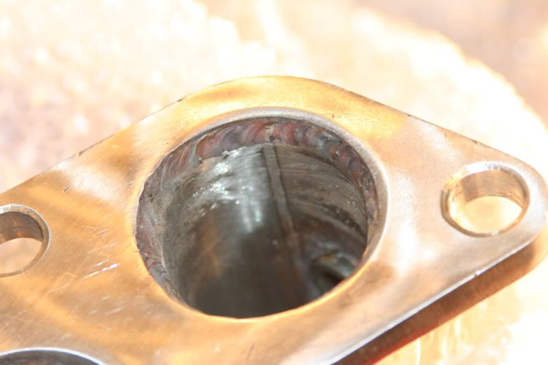

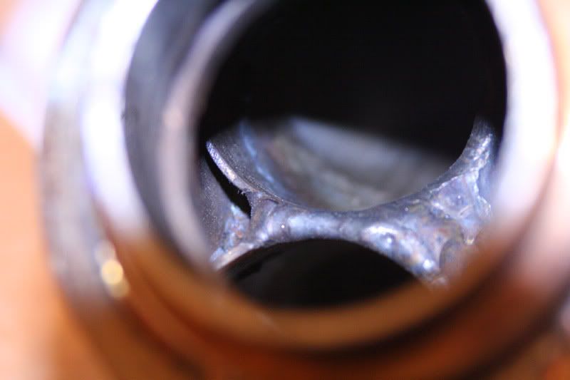

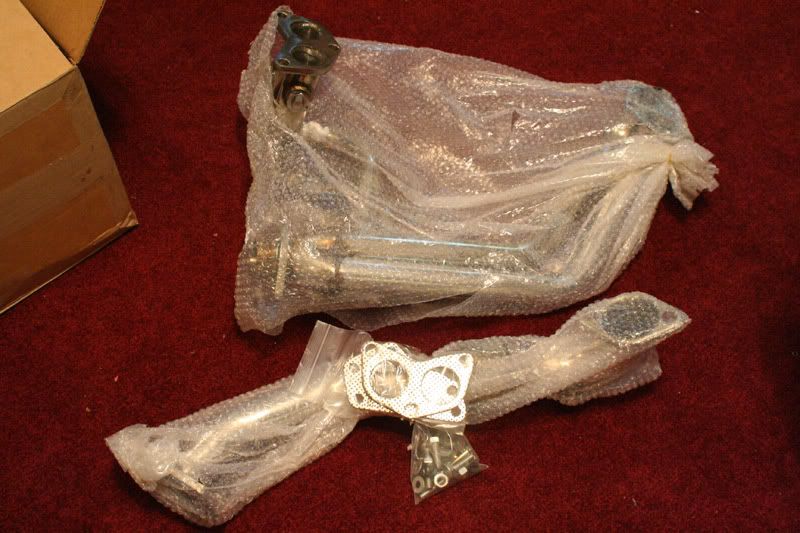

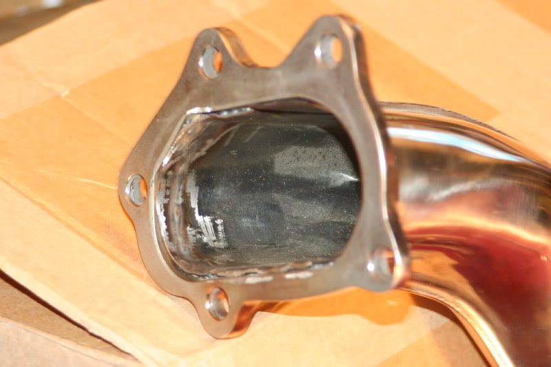

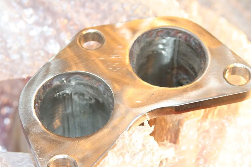

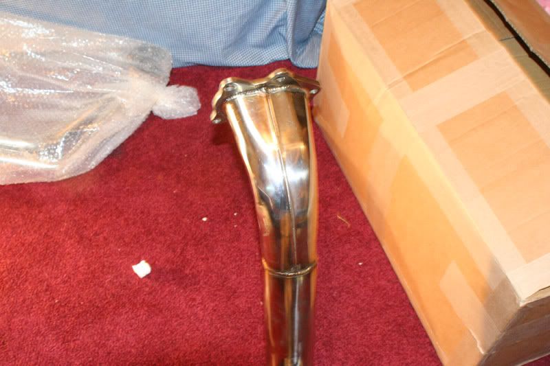

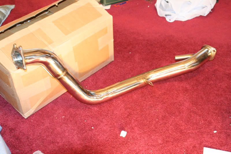

    The exhuast setup. 4-1 headers w/ uppipe, 3" bell mouth DP ALL getting ceramic coated.
    [​IMG][​IMG][​IMG]
    [​IMG][​IMG][​IMG]
    [​IMG][​IMG][​IMG]

    nice exhaust....now get it running so we can hear it...looks like they are equal length too..peace out boxer sound ;)

    it's not about piling up parts, because these are what's going to help my car run. I've sent my wires in. SO I took them OUT of my car, some progress there. SO I'm guessing by the end of Jan. maybe then it'll run. ALSO took off the stock headers and uppipe so the NEW ones can go in after the coating.
    Then when the wires return....I have to put them in.

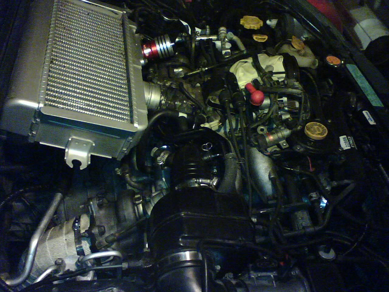

    taken with my cell phone...not the best quality....
    here's an update..... who cares? haha this is good for high 14's @ 7lbs
    [​IMG][​IMG][​IMG]
    [​IMG][​IMG][​IMG]
    We'll see how QUICK it is at 7psi wastegate pressure
    XSPOWER (Stone Racing/SSAutochrome) header/uppipe; 4-1 header coated/wrapped
    3" bellmouth downpipe (x3Racing) coated/wrapped
    Freshly rebuilt TD04L
    '02 WRX TMIC

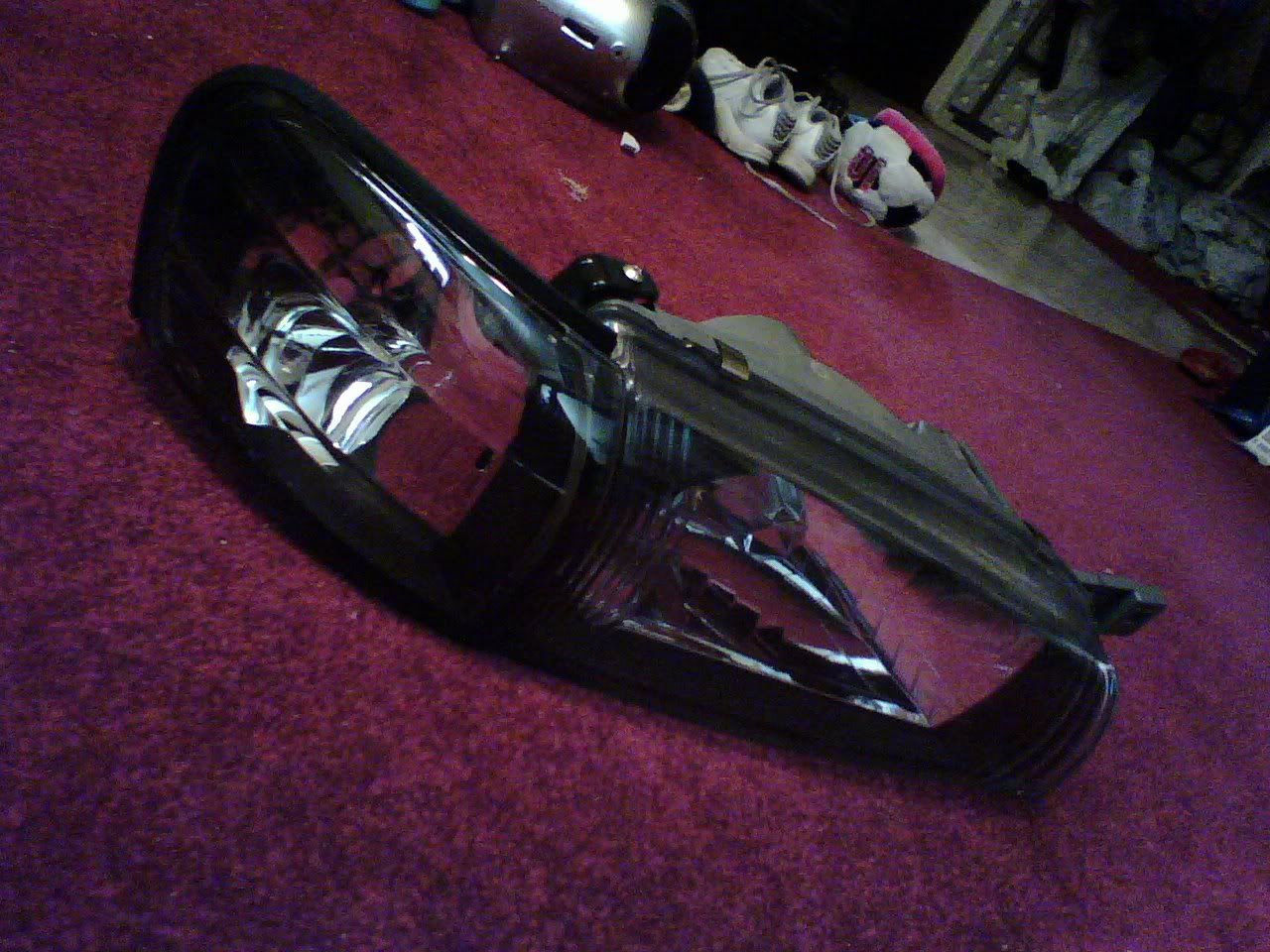

    Headlights STOCK modified. Took apart and painted. The corner lamps are purchased from ScoobyWorld in UK (some $117ish total or so). Slight weather stripping not sticking onto the housing but fixed that with weather stripping glue. Corner lamps TOO NEW, makes my headlights look duller because of the pits in the lens.
