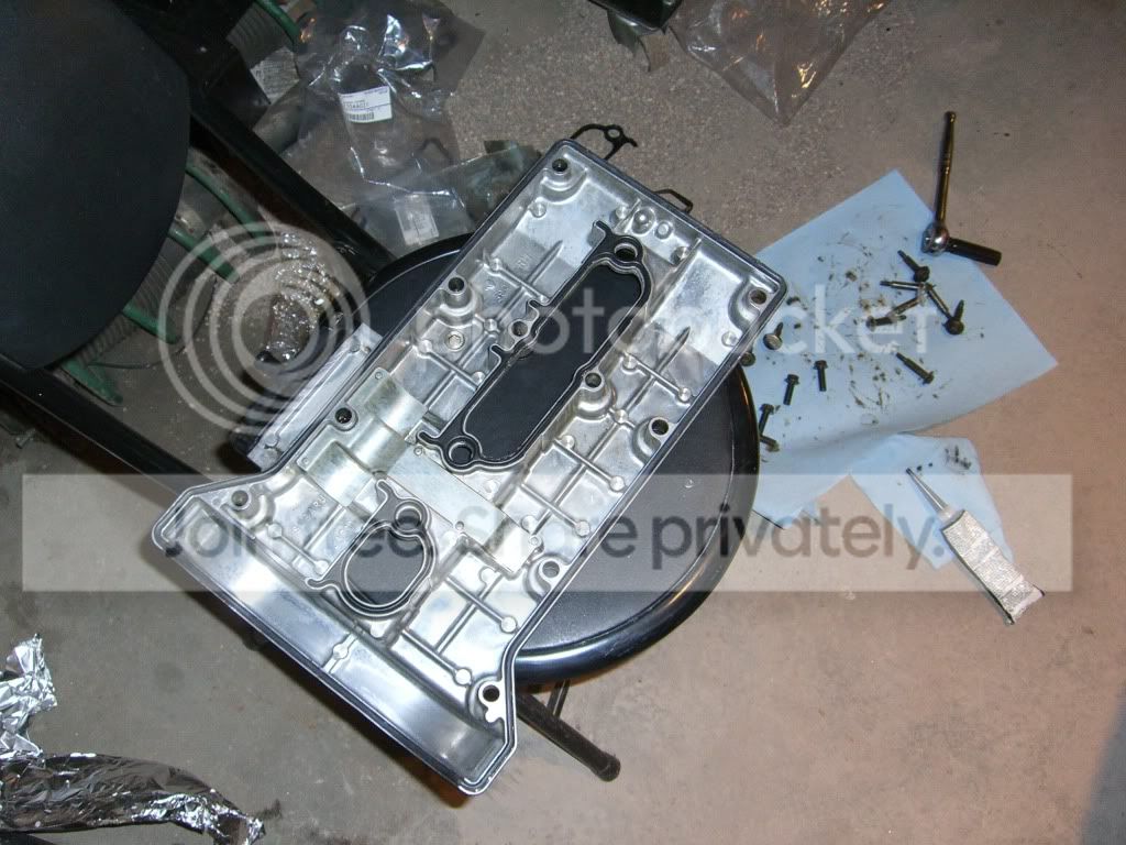

    Found some time to clean up the valve covers and bolt them back on.
    Then I spent some time looking for my STI motor mounts... stopped soon after starting to lol at the boxes of parts overflowing out of the attic and taking over the garage and spare bedroom.

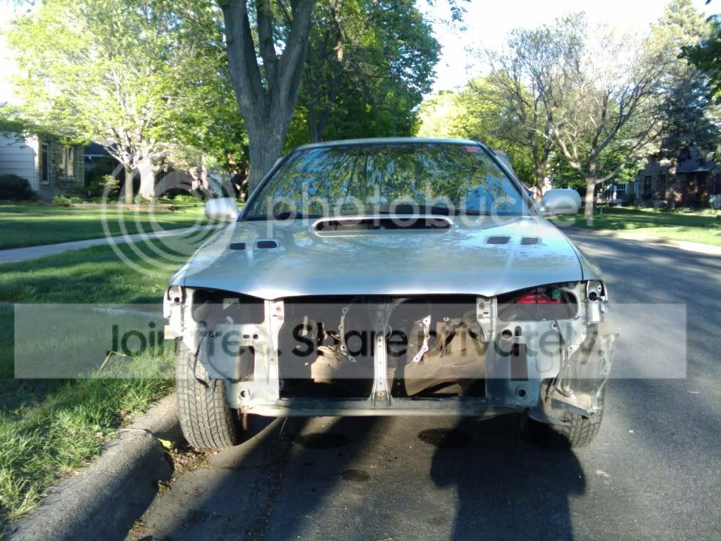

    Installed the merged harness, heater core, and upper dash. Chux quickly fabbed up an ecu mounting bracket by hacking up the svx bracket and using it with the RS X bracket.
    Pulled apart the front and and took out the motor and exhaust:

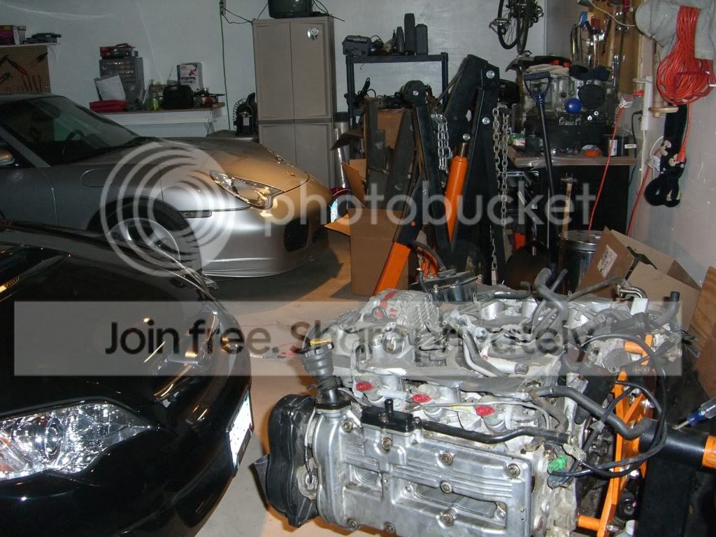

    Swapped the motor with a Chux:
    Measured for the radiator and started cutting... I'm gonna need a plasma cutter lol:
    Got hungry and parked it. Reminds me of an evo x:

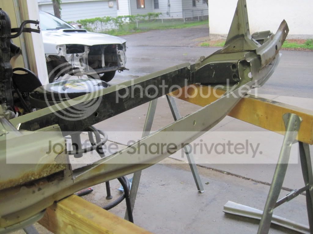

    how much do you need to cut out of the beam? maybe it would be easier to make a new beam (ask martin about the "beam" we did on the rally car)

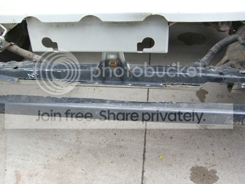

    Met Martin for burgers tonight and he mentioned that. There's not a whole lot to cut out, it's just really thick steel and a real pain in the ass with a 35gal compressor.
    The oem beam looks like it will be perfect for mounting the svx rad. I probably won't even need to weld brackets or anything. Just drill 2 holes for the lower mounts, spin the upper mounts 180 degrees and tap new holes for them... maybe notch the upper support for hose clearance. It's 1000x easier than people make it out to be. Otherwise a 15" tall 27" wide 3.5" deep or smaller core will work. Looks like I'll even be able to fit a small AC condenser with push type fans or no AC and 8" pull type fans.

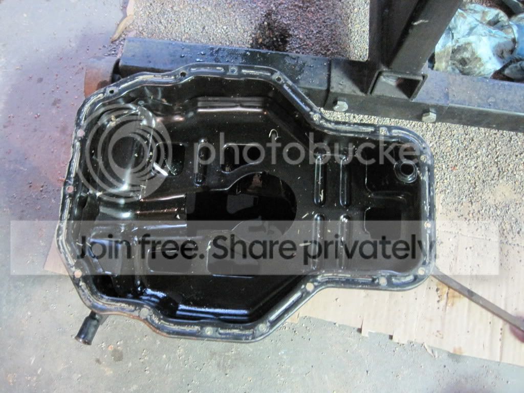

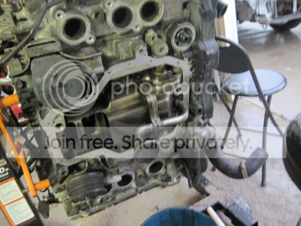

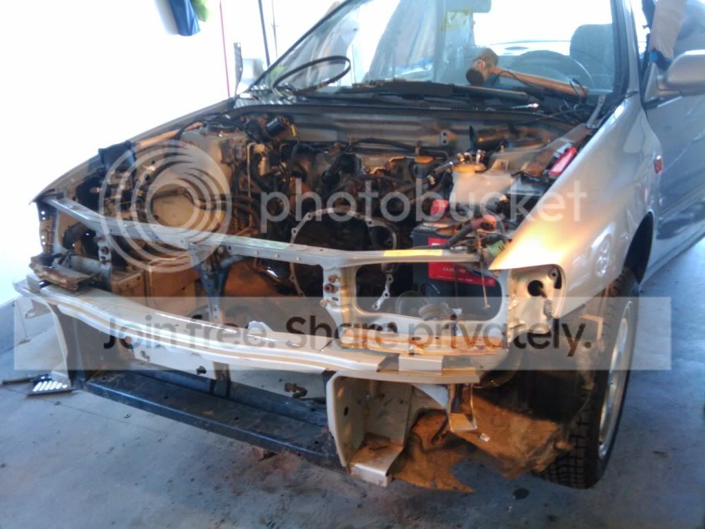

    It's been really difficult lately finding even an hour or 2 of free time. Did make some progress tho. Big thanks to thunderdan for motivating me and helping. Pulled the oil pan and inspected the valve seats, cylinder walls and bearings. Previous owner made a mess of the pan (sloppy rtv job) so we spent a good amount of time cleaning out the pan and pick-up screen. Bumper beam is pretty much good to go too.
    Here's a progress pic of the bumper beam/rad support. We cut out the black part and trimmed it up a little more than what this pic shows. I'm sure Dan will post up finished pics for those thinking of mounting the radiator this way:

    FYI, a wire brush on the end of a drill makes quick work of the silicone on the pan. The groove on the pan makes scraping a futile attempt at cleaning it.
  26. idget
    For sure, I need to take the wire wheel to the outside since it needs some rust treatment anyway. Pressure washer should take care a lot of it too lol

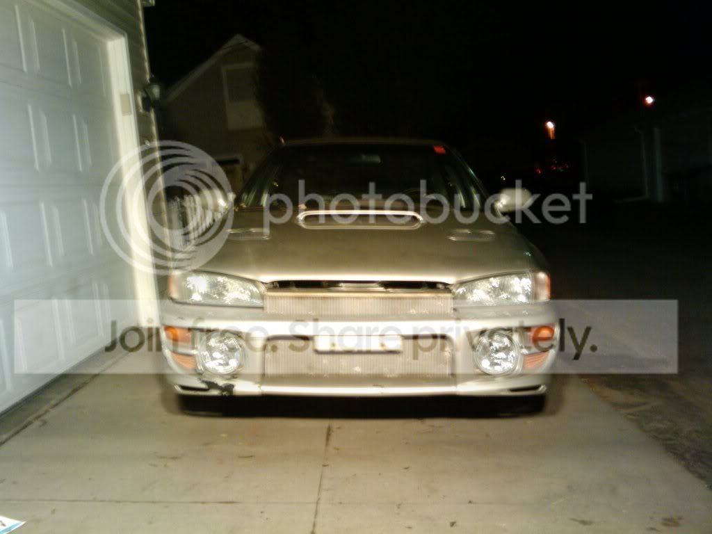

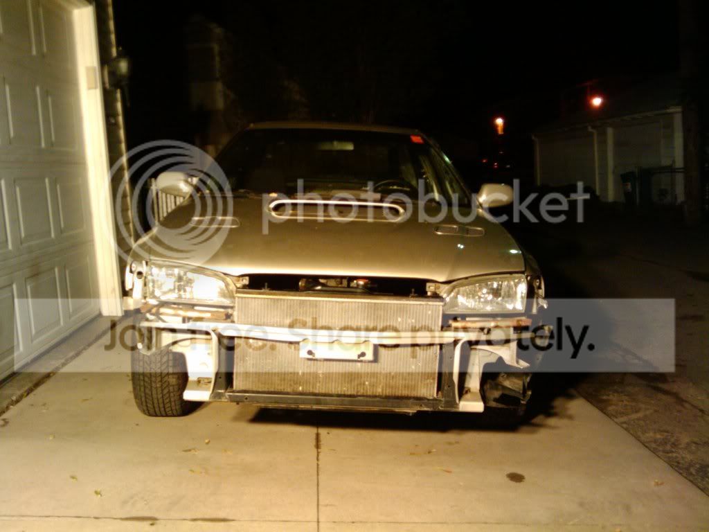

    Did some test fitting... pretty close, but it's gonna need some more trimming before I can fab lower mounts and bolt everything back up:
    Also installed the new steering wheel and hub. Mounted the cruise control to the column but still need to wire it in... need to wire the horn in too.
  32. thunderdan1313
    thunderdan1313 New Member
  33. idget

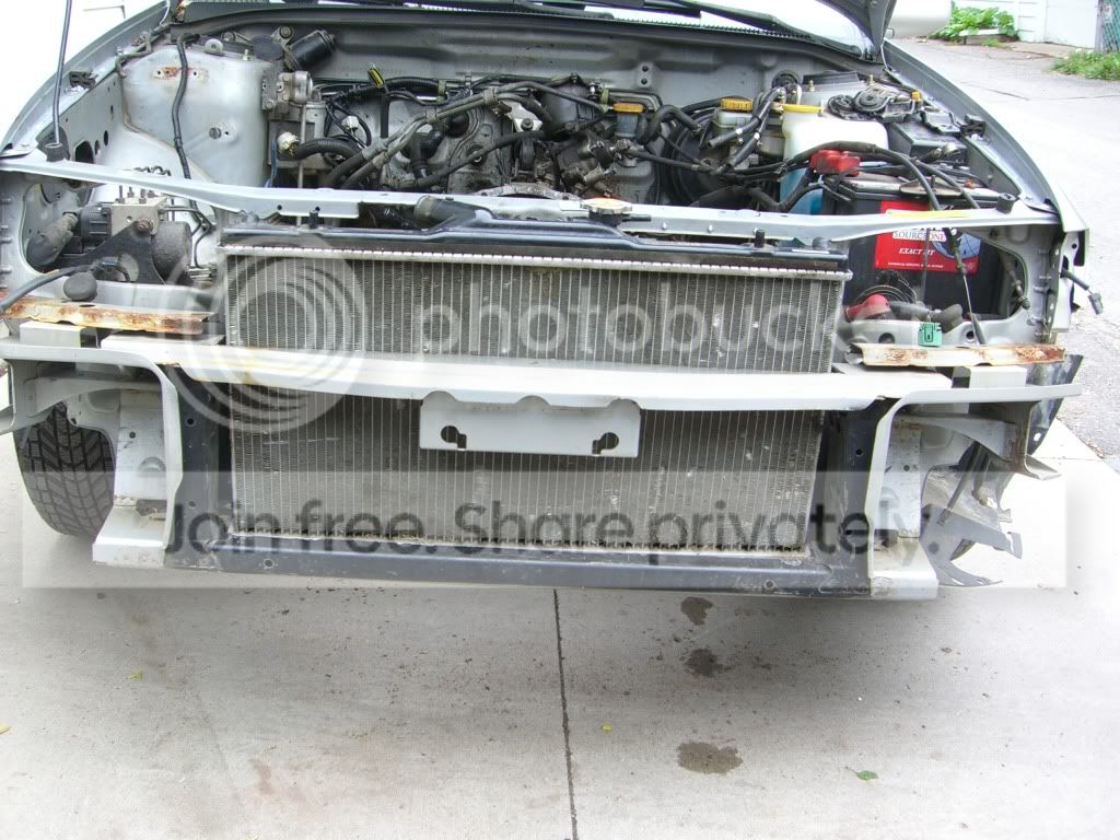

    Getting closer!
    Plan to reassemble the motor tomorrow and test fit the bumper/grill. I'll go with a shorter, narrower aluminum radiator eventually. Need to fix some engine bay rust before dropping the motor in.
  34. piddster
    Are sure that radiator is big enough? lol
  35. idget
    lol, it looks huge when it's not hiding behind all the other stuff, huh?
    It's the stock svx radiator and is acually the same length as the stock impreza radiator only slightly wider and actually shorter... either way it's gonna melt my headlights lol

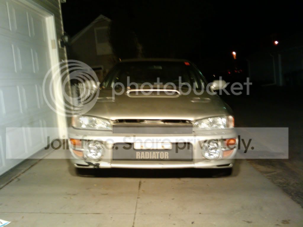

    lol I'll make a stencil tomorrow and work on this:
    and get plates that say "nottrbo"
  42. piddster
    I think it should be "RADIATOR, PUNK"
