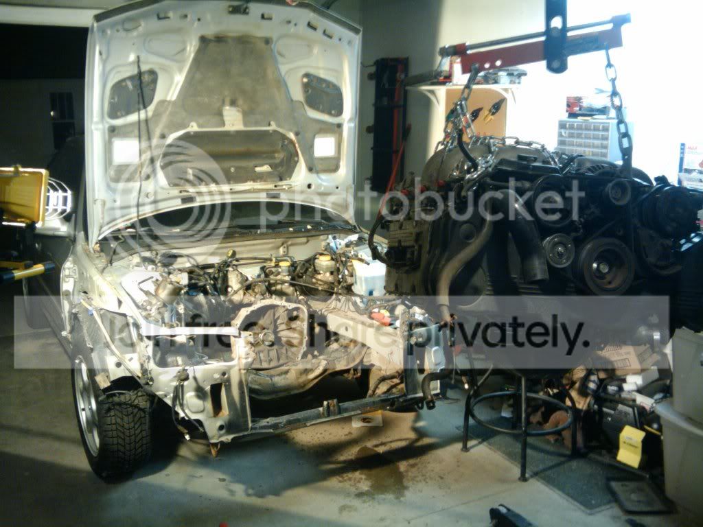

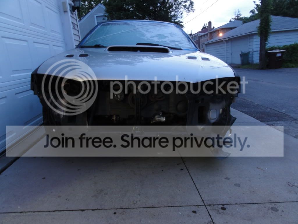

    Well, the grill is "slightly" off :laugh:
    I suppose I could fiberglass the top and sides... or I could flat black the whole car... \
    At least the radiator is slightly less obnoxious now:

    It's looking good, that sure is a tight squeze!
  3. idget
    Thanks Michael!
    I could have went 3-4" further back, but I want to leave room behind the radiator for pull fans or possibly an intercooler in the future... possibly.
    I also wanted to retain the hood latch.

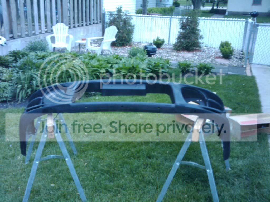

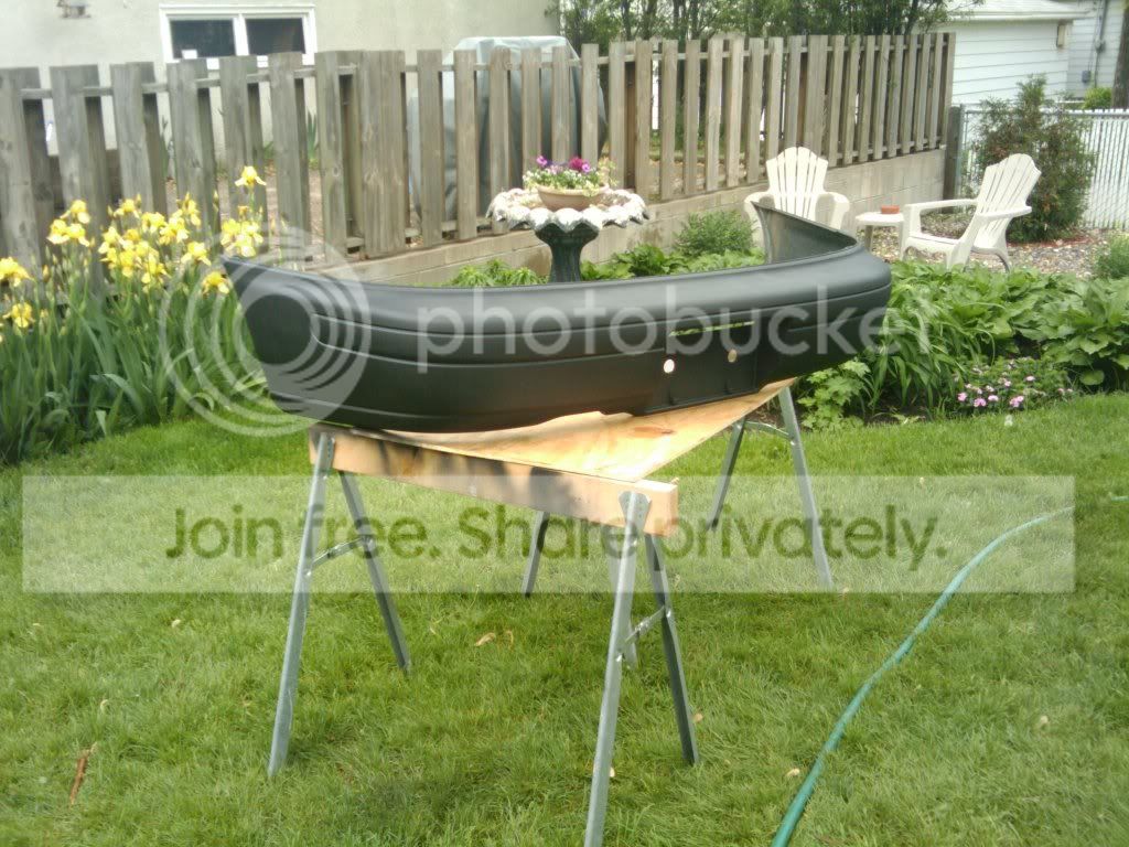

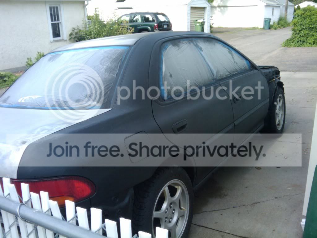

    In the meantime, started painting. Like the one masked off fog light? Someone at some point decided to replace the stock bolts with round machine screws :rolleyes:
    front bumper is going to need to be sanded and repainted eventually. Rear bumper turned out better:
    Trunk, wing, and fenders are next. Then rear quarters up through the a-pillars. Then pull the doors and do the doors and jambs. Since it's 1 piece 1 weekend at a time as if time allows... I'd be surprised if it's done within a month lol

    Are you repainting it flat black or is that just the primer? There's a flat black RS I see in Maple Grove and it looks awesome
  9. idget
    Flat black.
    If it turns out too streaky I'll grab a few cans of 3m underbody coating and make it "textured flat black" :laugh:

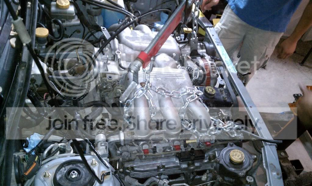

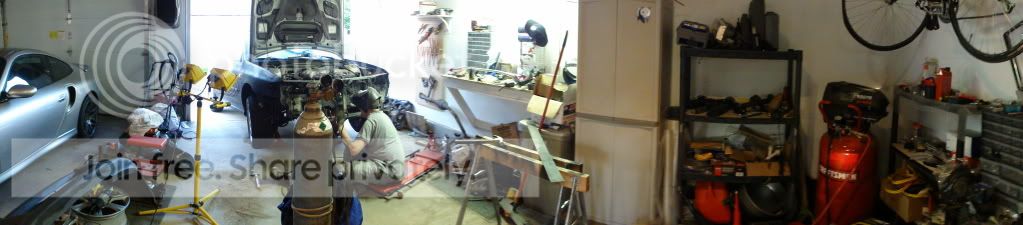

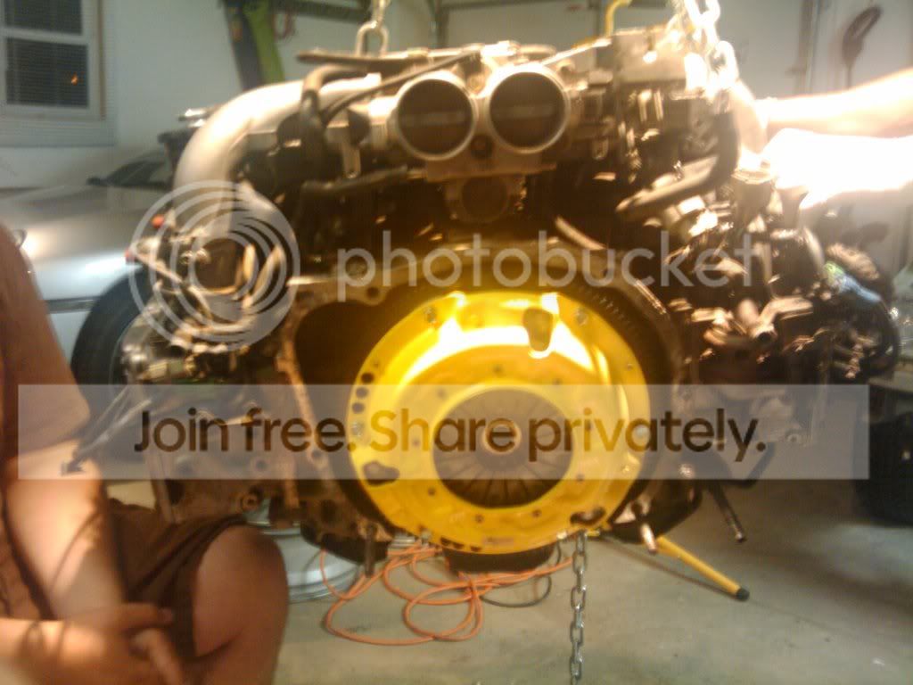

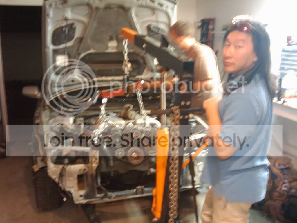

    4 hours of very productive work tonight with a great deal of help from Fuji and Thunderdan. We worked at a pretty good pace considering how tired I was after a full work day and a Twins game. We even stopped to run over to Fuji's to pick up an alignment pin and almost appeared in an episode of cops.
    Got the plugs and coilpacks installed, installed the pretty new flywheel/clutch/pressure plate, cut some more parts that will need to be reinforced later, and got the motor in.
    Oooh, shiny! Can't believe I spent more on this than I did on the motor/ecu/harness:
    OMNOMNOM
    This part would have been a pain in the ass without Master Fuji's wisdom. I decided to cut rather than drop the trans. I need to reinforce the lower support anyway, so now I have an excuse to redo and beef up the whole front end.
    Jackie Chan approves this message:
    Great Success!
    Bonus video footage to come.

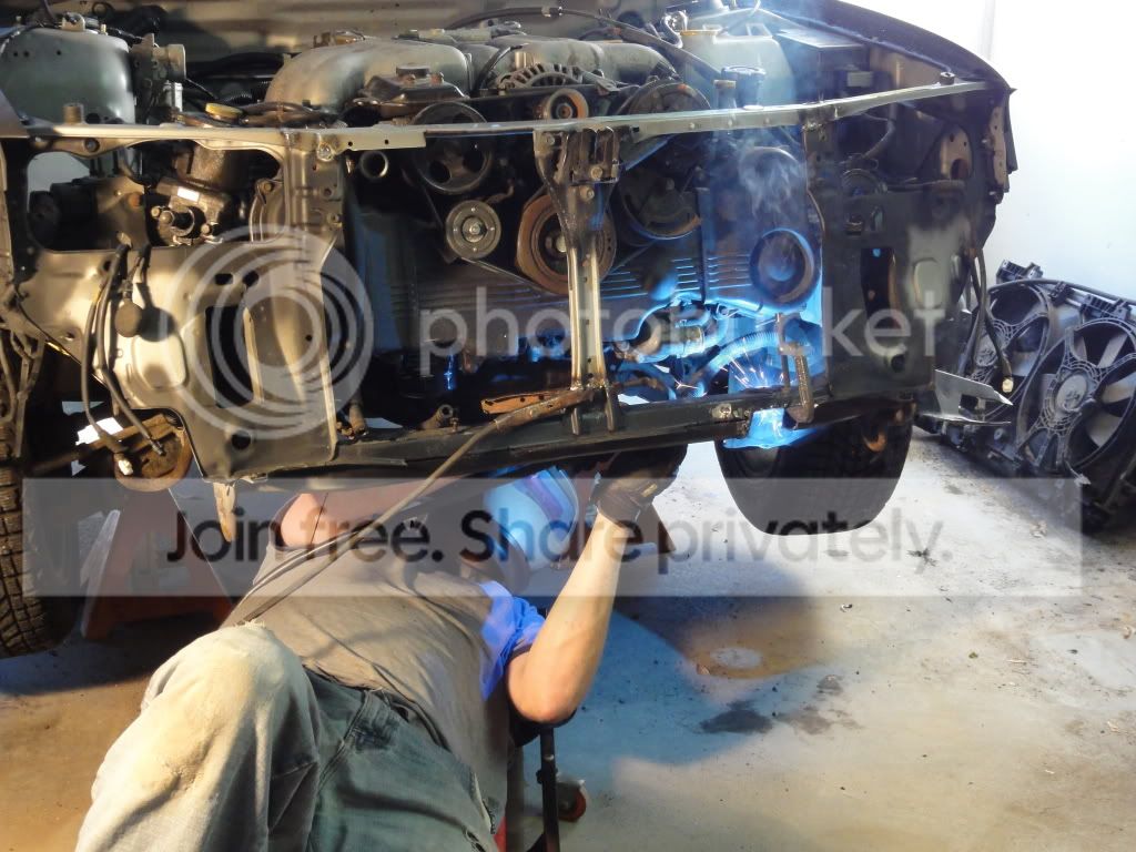

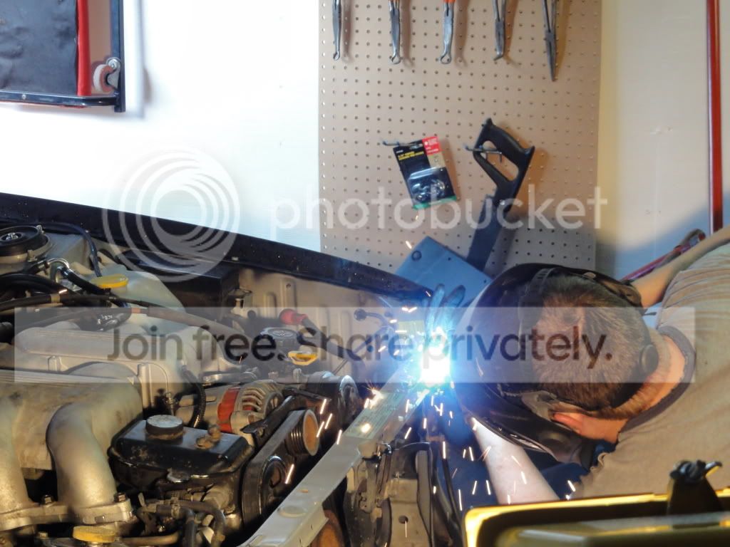

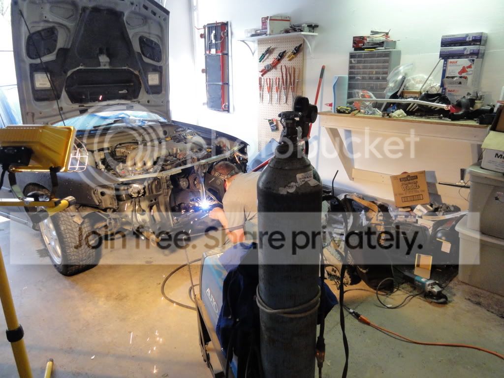

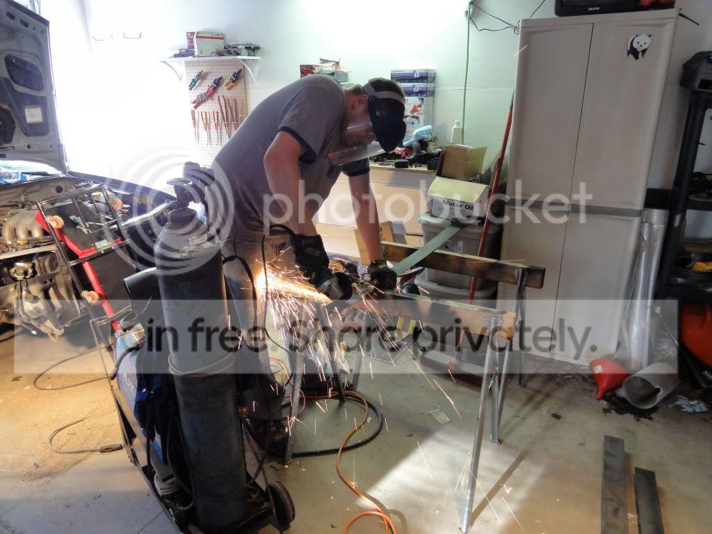

    Got some CRITICAL work done today thanks to TSTRBOY2004!
    Not only did he leave the fort and drive all the way up from the middle of nowhere, but I'm convinced he made the front end of the car stronger than it was from the factory :biggrin:. I wouldn't know anything about it, but I can't imagine welding 3 different thickness metals together is an easy task!
    The best thing about having someone with skills work on your car is you get to see how bad you are how much room you have to grow. I'm amazed that he can cut 3 complex pieces in the time it takes me to make 2 simple cuts :laugh:
    We decided to box the lower frame support that I had to cut for clearance for the lower radiator hose. I'm really happy with the way it turned out. I had my doubts as soon as I started cutting it a couple weeks ago.
    Somehow everything is still lining up! Let's hope I can keep it that way:hsugh:
    If the weather holds up, more to come tomorrow.
  43. TSTRBOY2004
    man those welds look like Fobia's old ones ha ha ha ha ah.. lets just say it is tough to weld on such thin metal, that has paint, rust and even thinner due to grinding ha ha.. hey.. but it works... and thats why we have grinding wheels and paint... ;) (sad thing it doesnt reflect my 9mths of weld schooling ah ah ha)
    My ballsack really enjoyed the weld blob too FYI
    cant wait to see this thing running and go for a ride.. after the porsche of course
  44. piddster
    Story of my life with my project. Welder settings are everything. Still doesn't account for contamination due to paint you can't get at.
