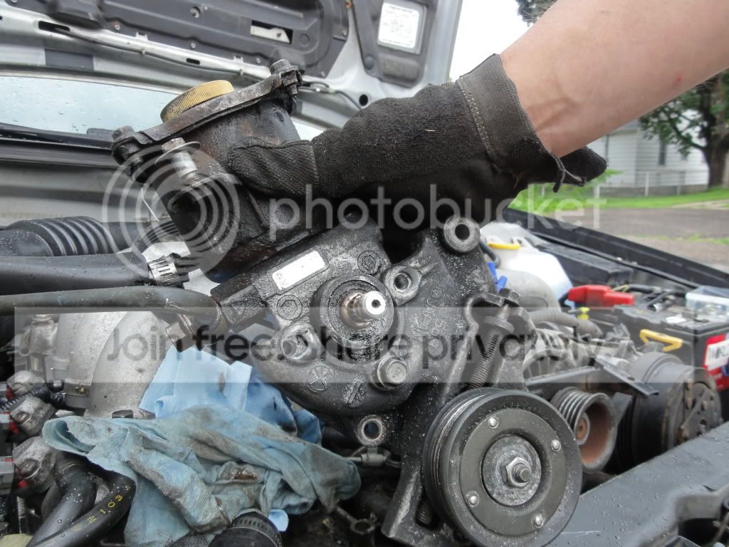

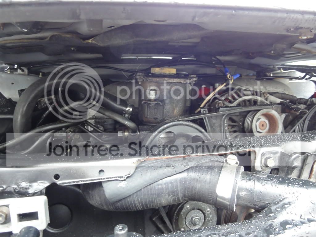

    Well got 2 steps forward and only 1 step back today lolz
    Fixed the starter with a hammer :dunno: hasn't been acting up for the last 5-6 starts.

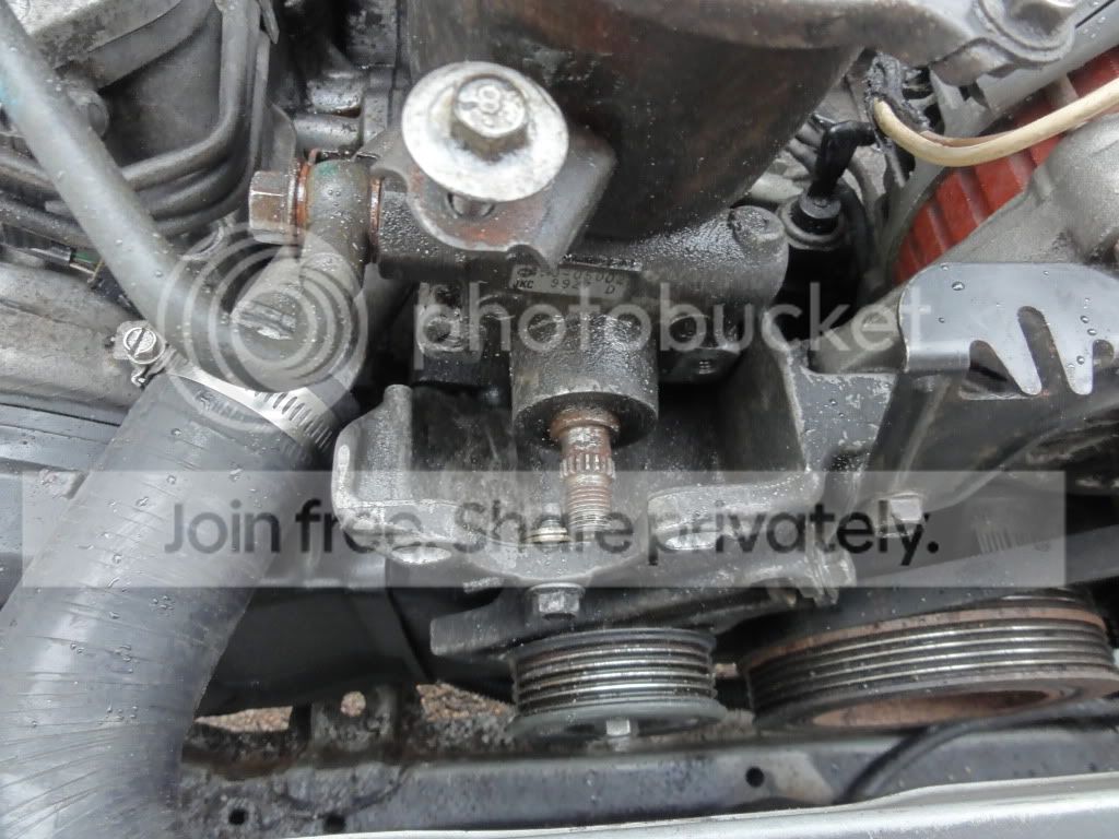

    Decided to hook up the taller and wider RS ps pump rather than get custom lines cut. Hopefully this will help someone else out in the future. I couldn't find any decent info on this issue so here goes!
    The RS pump and reservoir fit! kinda... ok, maybe not... at all:
    Don't mind the upper rad hose, that'll be fixed next.
    The three front bolts are spaced differently, so I ovaled out the SVX mounting bracket to accept the RS pump:
    The pulley is off a little too, it sits too far forward, so washers between the mounting bracket and pump to move the pulley back towards the block will have to do:

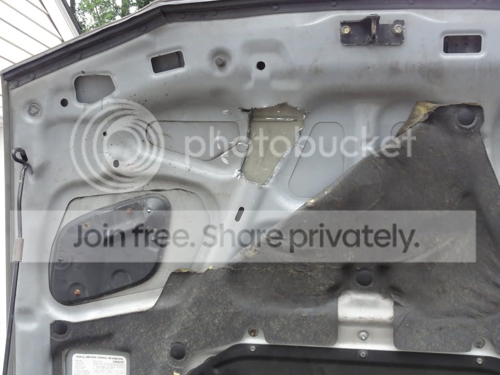

    Of course the hood needs to be modified:
    But hey it works!
    The hood does have a slightly tougher time closing now, so I'll be working on that and possibly going with pins.

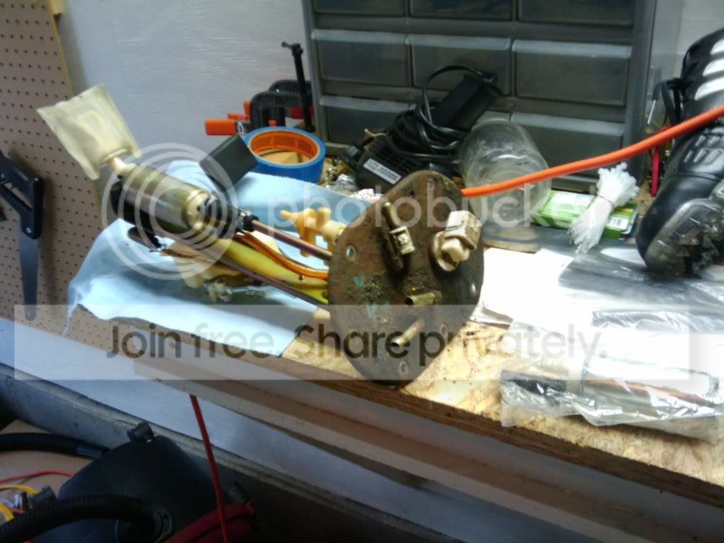

    I think I need a new fuel pump and I definitely need to connect the egr valve from the block to the manifold. I think I have an sti fuel pump laying around somewhere... maybe I'll work on that Friday.

    20 minute fuel pump install. Runs better but still idles low. Gonna call it a night but plan to get the egr system hooked up and the idle raised this weekend. Hopefully get the signal modulator from Chuxticles soon and call it good for now :)

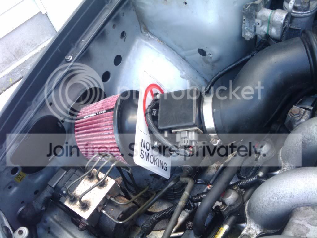

    Got the egr system hooked up... mostly. Enough that it runs smoothly and isn't too ridiculously loud now. Re-routed some vacuum hoses. Raised the idle with a ziptie.
    Also made an intake adapter lol
    Fired it up and took it around the block a few times. Drives great and sounds angry. Water temp shot way up a block from the house so I'll have to dig into that tomorrow. I'm guessing stuck tstat or water pump but I suppose it could be the lack of fans... I wouldn't expect the temps to get that high in a quarter mile although it was a lot of stop and go and under 30mph :dunno:

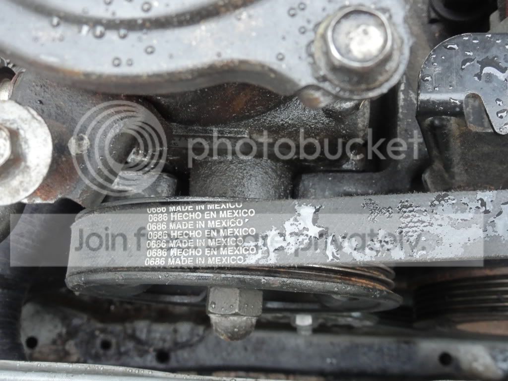

  10. piddster
    Can you use washers to straiten out the PS pump? You'll tear it up eventually.
    I like how the belt says made in mexico all over it, lol.

  12. idget
    Yeah, the washers I have in there now get it pretty darn close. I could probably get it a bit closer but I'm not too worried. If it pops I'll get the stock feed line modified to fit the svx pump (like I should have from the beginning lol).

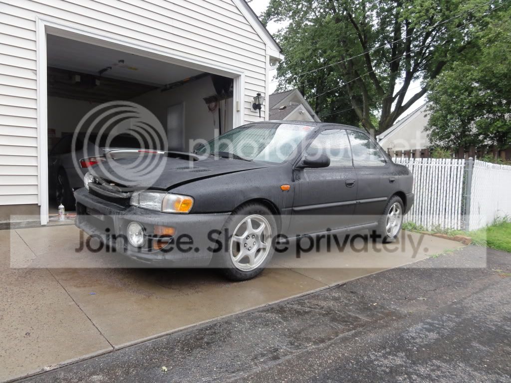

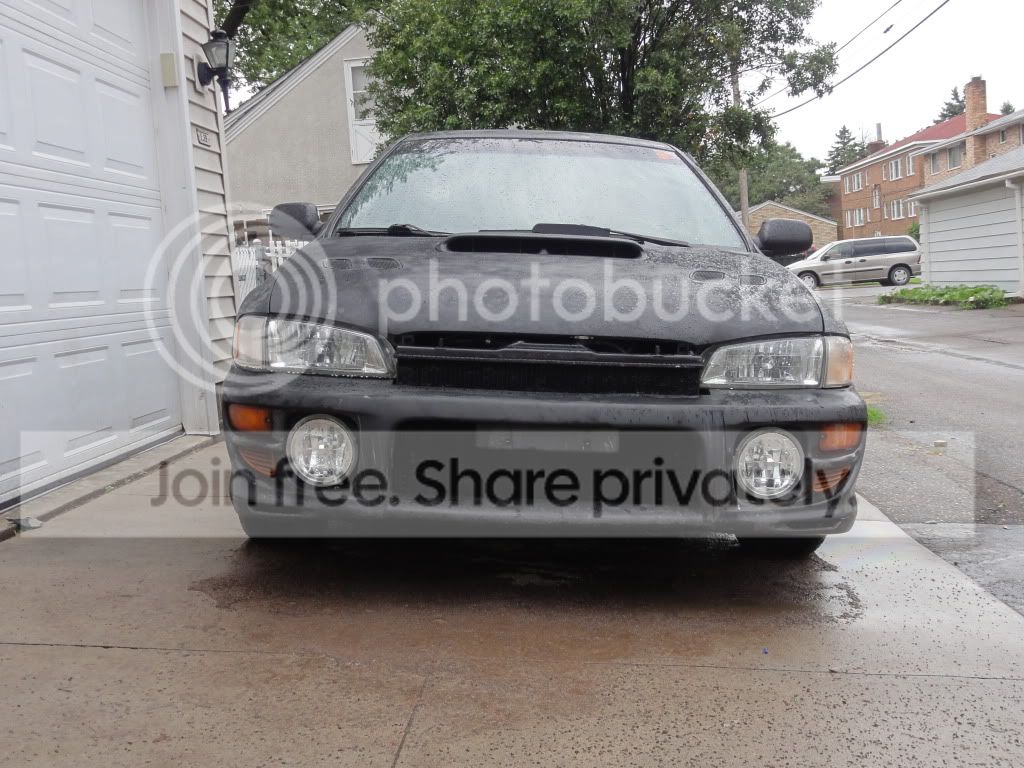

    The RS should have come stock like this... 3.3 H6, gold BBS, 245/40/17 re-01r's! Dents and overflush radiator as a dealer installed option.
    Thanks for letting me borrow the wheels/tires Tall Dan!

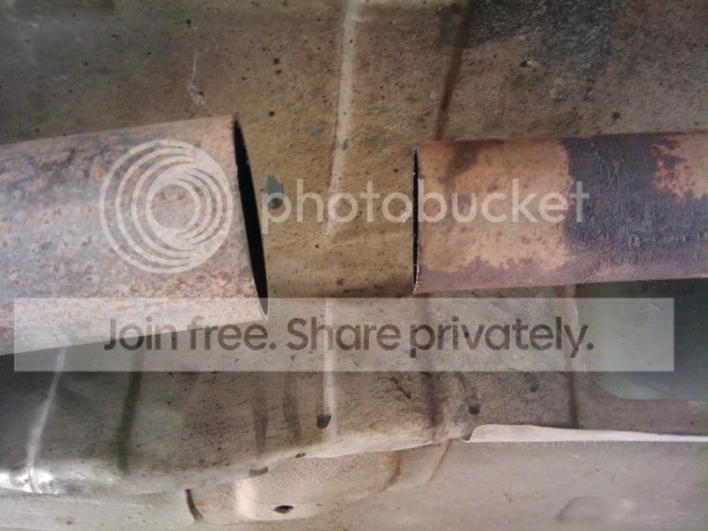

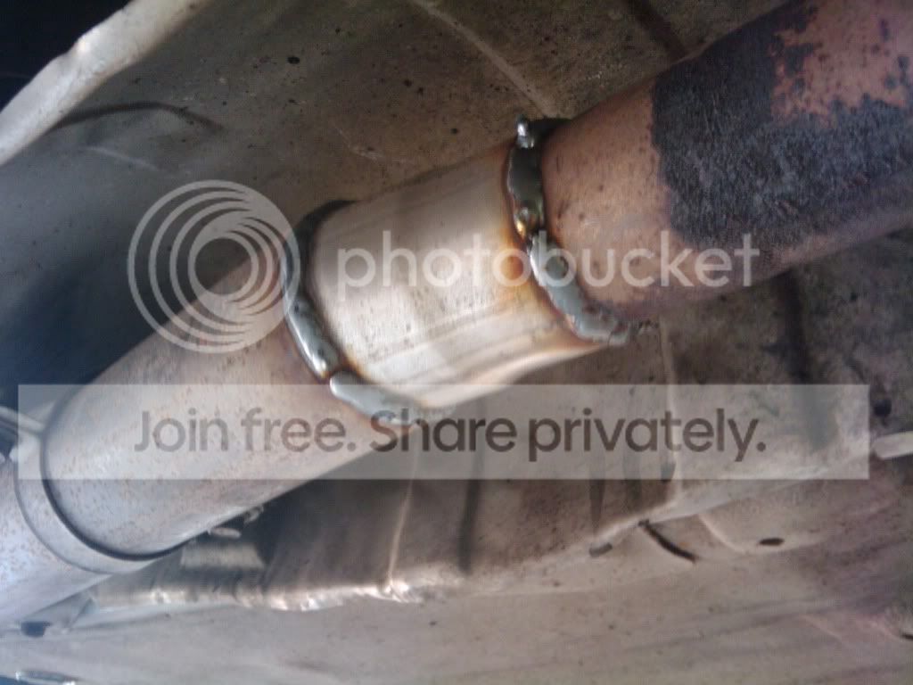

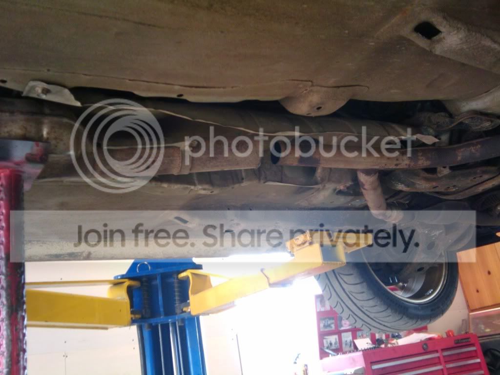

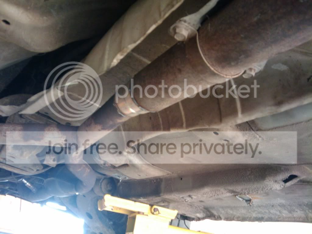

    So I drove out to the middle of nowhere and had Nate work his magic again. He had a wrx/wti midpipe laying around so he connected that to the svx y-pipe on one end and my gutted STi axleback (from here http://mnsubaru.com/forums/showthread.php/31071-DIY-gutted-STi-axleback?highlight=diy+gutted) on the other...
    slight mismatch:
    but close enough to work:
    and work WELL I might add! Sounds fantastic! Quiet at idle and cruise and just plain angry at WOT. I little raspy, but nothing I can't live with. No drone at 70mph (3100rpm) either.
    I'll see if I can get another short 1st-3rd clip together tonight.

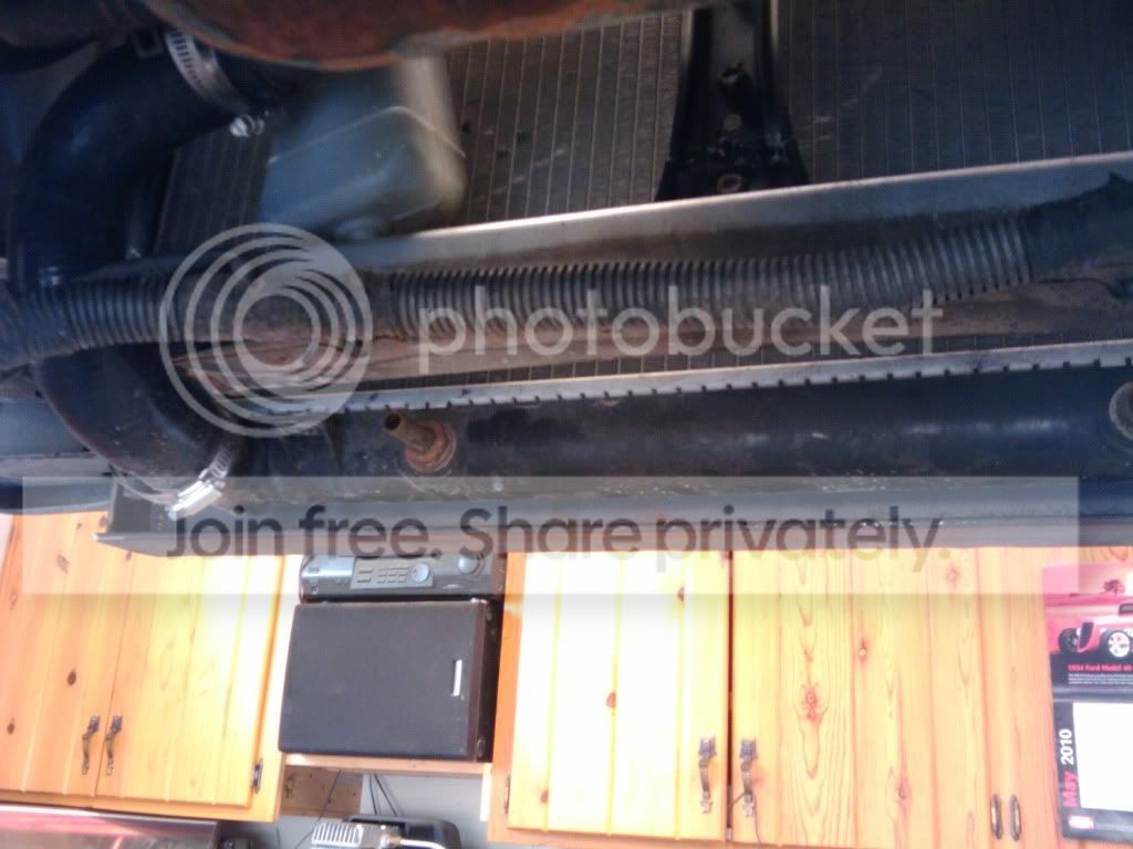

    Nate also welded up a little bash guard for my radiator that sticks an inch below the bumper beam.

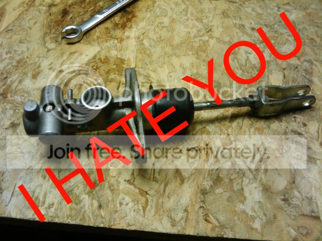

    Now all I have to do is figure out if it's my clutch slave, master, or line that's borked. I'll probably end up overnighting them (from Japan) so I can have the car ready for (racewars) next weekend.

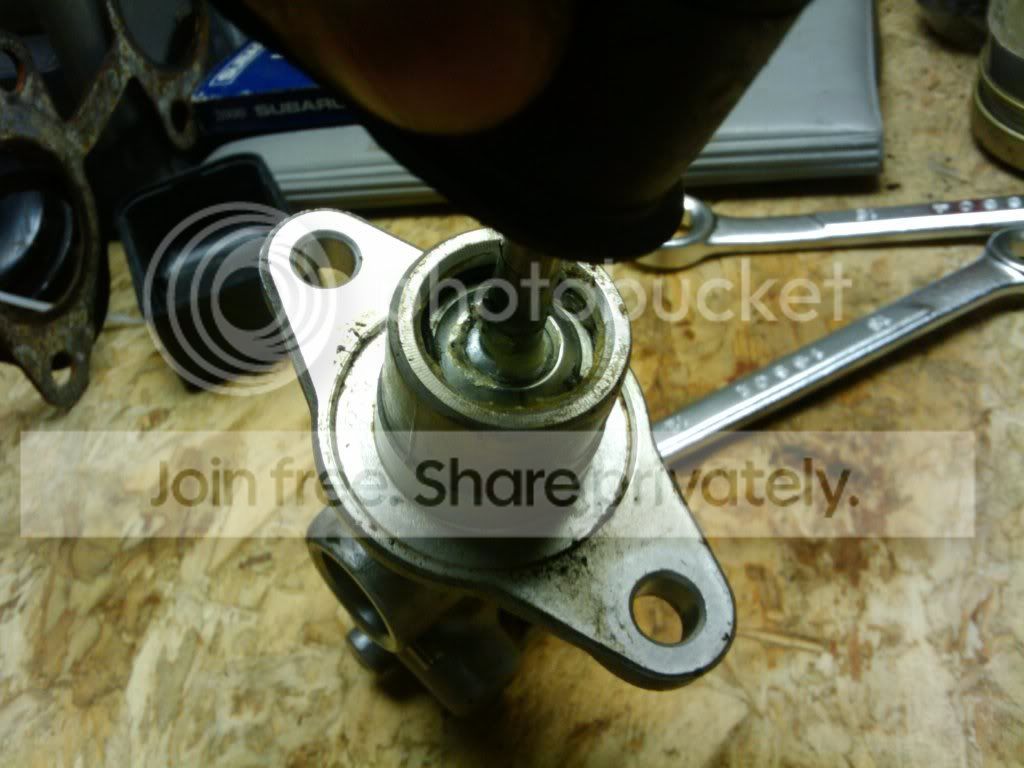

    Huh, well I don't know how I came out of that one alive... between almost shocking myself to death while grounding out the starter, almost catching myself on fire with a propane torch, almost igniting a puddle of brake fluid, and almost shooting myself after struggling with a flare nut for 15 minutes, I somehow got a new clutch master cylinder installed.
    If this is what the outer seal looks like, I can't imagine how chewed up the inner is.
    I'll eventually install the new clutch slave and lines as well (thanks Brian and 3rik!), but that's enough dinking around for now.

    Did you get to realign the pulleys so the belt doesn't scream? I remember that the most about your car on friday :)
  44. idget
    Nope, haven't had the motivation to do that yet lol.
    I can't imagine it taking more than an hour and a few tries to bore out the back bracket and assemble the right set of washers tho... maybe tomorrow night if I skip the rallyfest fiasco.
