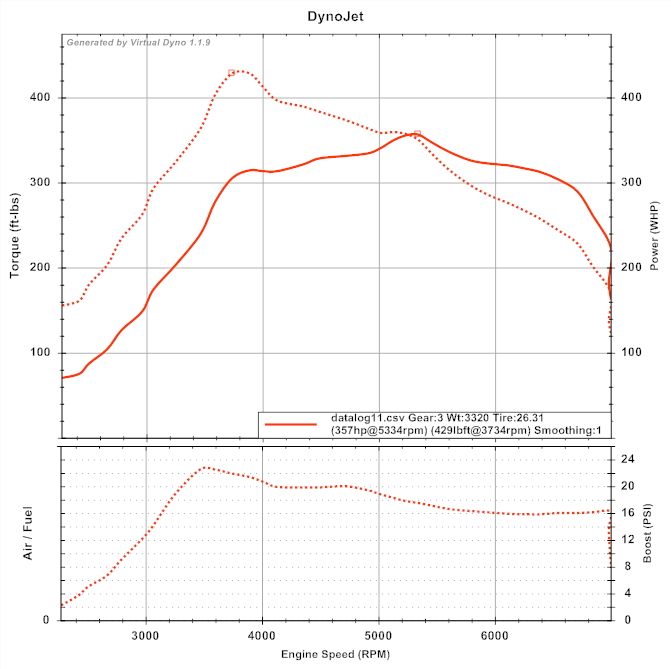

    Well....I missed Dyno Days, had a couple blown tires, but in the mean time I dug out an old data log and produced this Virtual Dyno graph...
    E85, VF39, 850cc Five-O's, other good stuff:
    If that's even close to reality with an Accessport data log and Virtual Dyno, I'm :D + :uhhuh: + :bounce:
  25. xluben
    3,937
    What fuel are you on? On a really peaky graph like that, you need to turn the smoothing all the way up. If you want to compare to what you would see at RS, you probably want to use the "Virtual Dyno" correction setting (CF=1). Or possibly the "Mustang" setting. The Mustang setting would make sense (because RS has a Mustang dyno), but I've found that setting on VD to read pretty low.

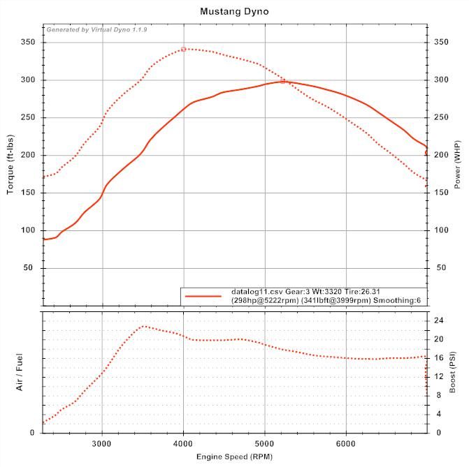

    Mustang Setting (smoothing at 6):

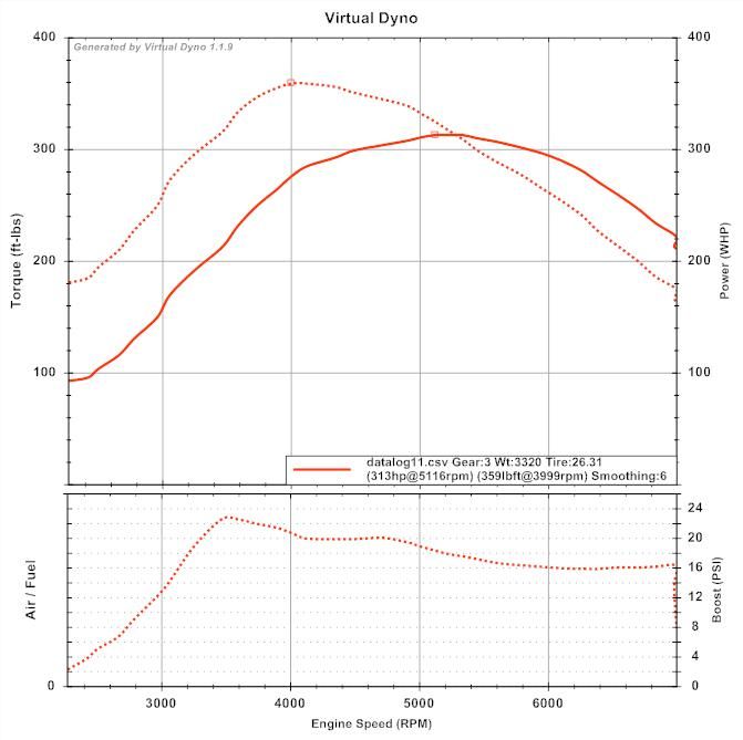

    Virtual Dyno Setting CF = 1 (smoothing at 6):

    Somewhere around 300WHP sounds about right for the stock turbo and your mods. That top end looks a little weird though. It is nice to have these logs as you move forward and want to compare to where you've been :)
