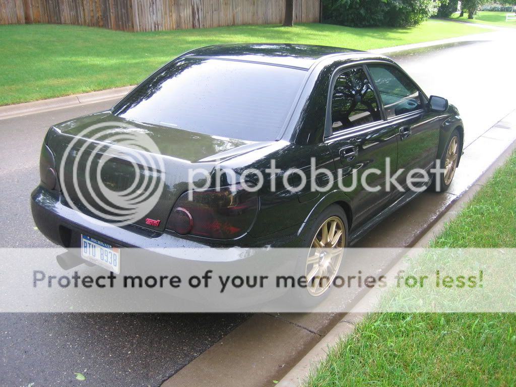

    Took a couple pictures for my brother today, figured I'd share.
