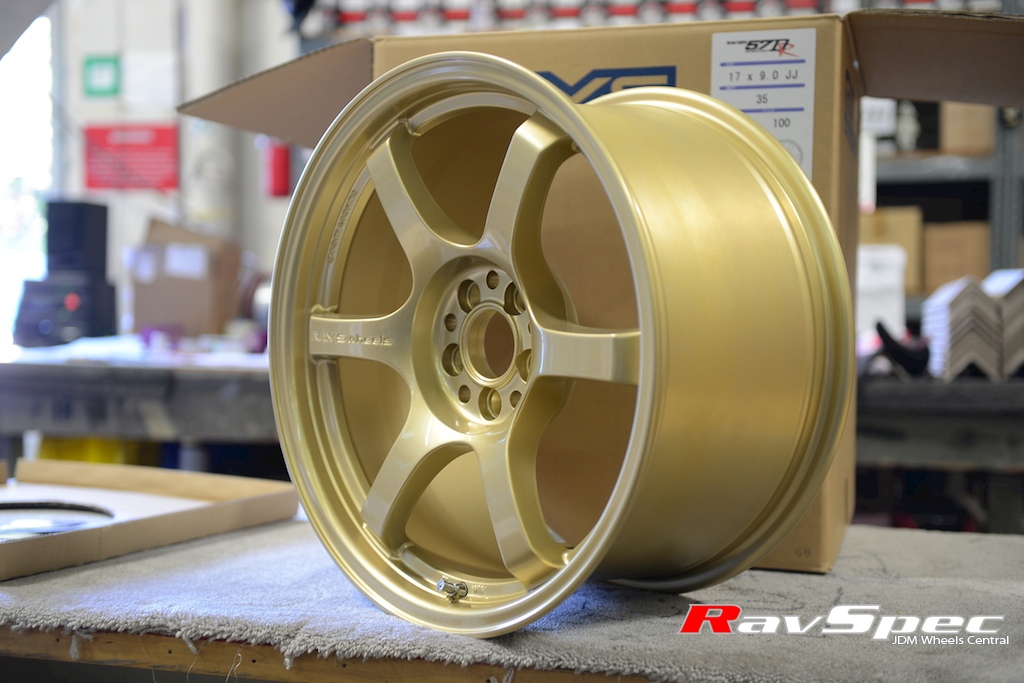

    RavSpec is setting up a group buy for me! I'm waiting to see the thread on NASIOC vendor classifieds...
    The previous group buy was for 5x100's, and apparently the offset to clear our brembos is custom, as is "Subaru Gold". Rays will make these 17x9's in 5x114 if they have 20 rims (5 sets) committed to. RavSpec said they'll stock 2 sets, I have one set claimed, so we just need two more. Hit em up if you're interested, a PM on NASIOC should do.
  7. Tash
    Tash Well-Known Member
    775
    They only doing gold? How much for a set?
  8. Juks
    Juks Well-Known Member
    87
    They have black in stock, but the +38 offset won't clear brembo's. He said if you used a 3mm spacer it would be ok. The customs runs are for +35. I'm assuming the GB will be for the same price, but I haven't seen the thread yet.
    He quoted me 1399+ 150 shipping for the black 17x9 +38's they had in stock.
  9. Juks
    87
    Group Buy:
    RAYS Gramslight 57DR - 17x9.0 +35mm 5x114 (Aggressive Face)
    $1399.0 + Shipping
    (1) Clear Brembo Caliper, no spacers required. Original spec was 38mm and we custom these to 35mm for clearance.
    (2) Concave Face
    (3) Custom Color - SUBARU[​IMG] GOLD color (from factory)
    Quote:
    This particular spec are custom offset made specifically to clear Brembo[​IMG] caliper and fits on 5x114 STI. Original spec was 38mm and will not clear Brembo. Don't miss a chance to own an exclusive set of wheel !! Only limited sets available.
    http://forums.nasioc.com/forums/showthread.php?t=2414793
    Hit em up!

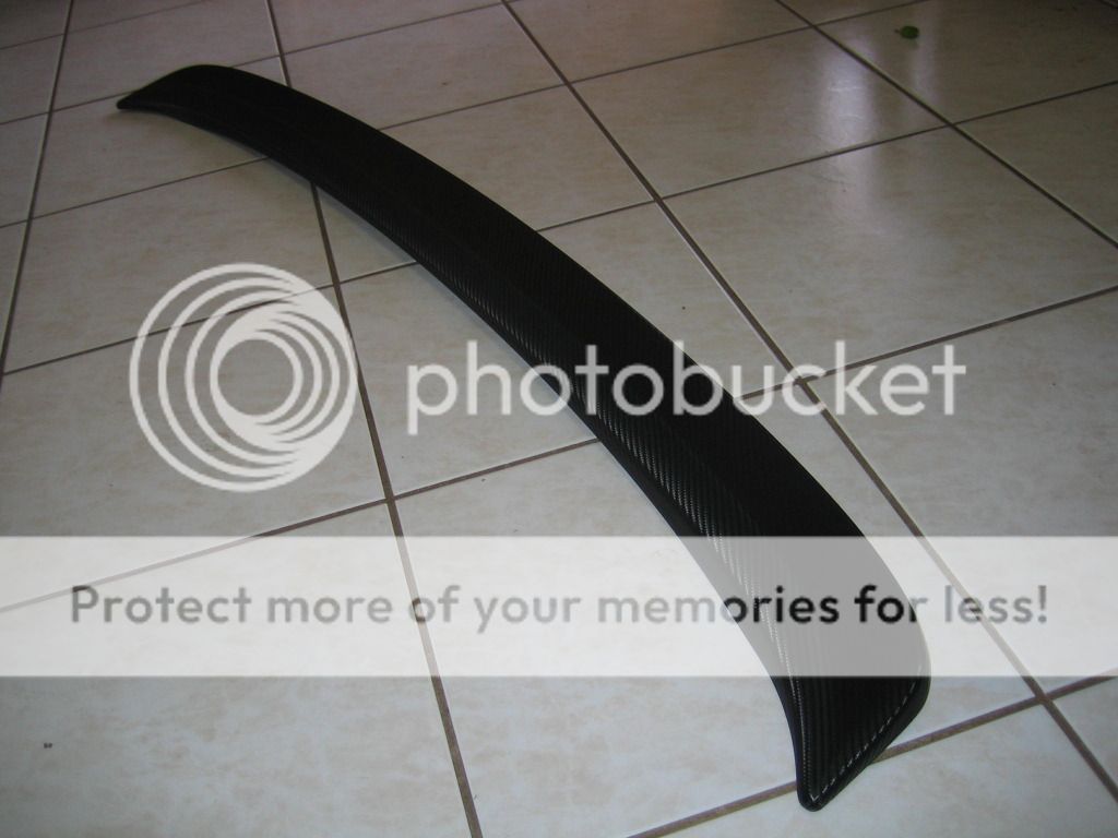

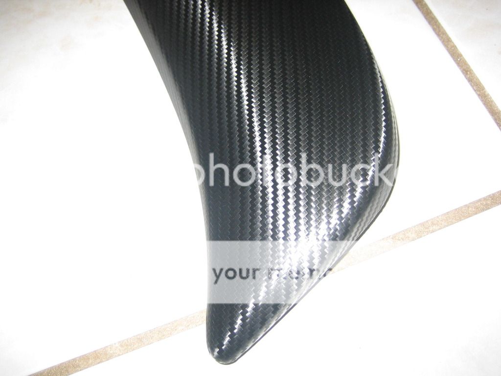

    I thought this was kind of cool. I wanted to get it to match my Seibon trunk, but seeing as it's a couple years old, it's got some fade. Needless to say, they don't match :( Maybe I'll get the trunk lid wrapped the same...
  12. Tash
    775
    Or you could sell it ;)

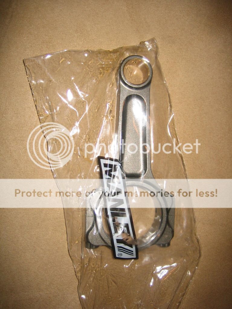

    Beefy!
  14. xluben
  15. Juks
    87
    Hopefully they can take a beating, cause that's what they're gonna get ;)
  16. Nuke

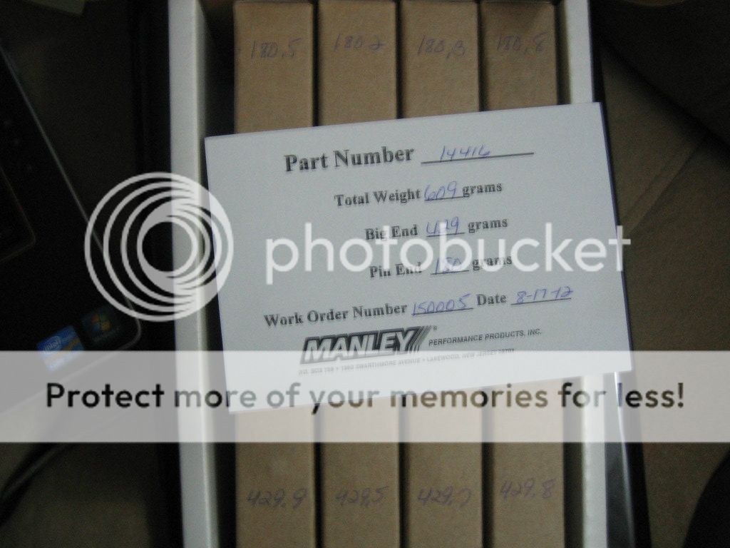

    can u weigh them for me.
  17. FuJi K
    My +2mm Pauters weigh 591g
  18. Juks
    87
    Total weight 609 grams. Big end 429, pin end 180.

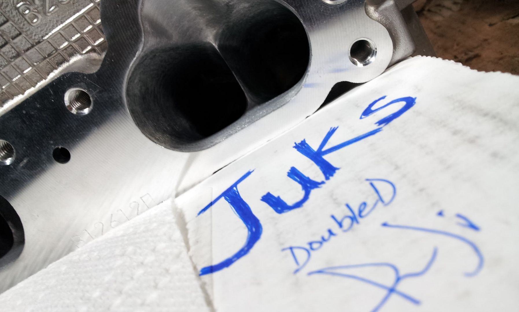

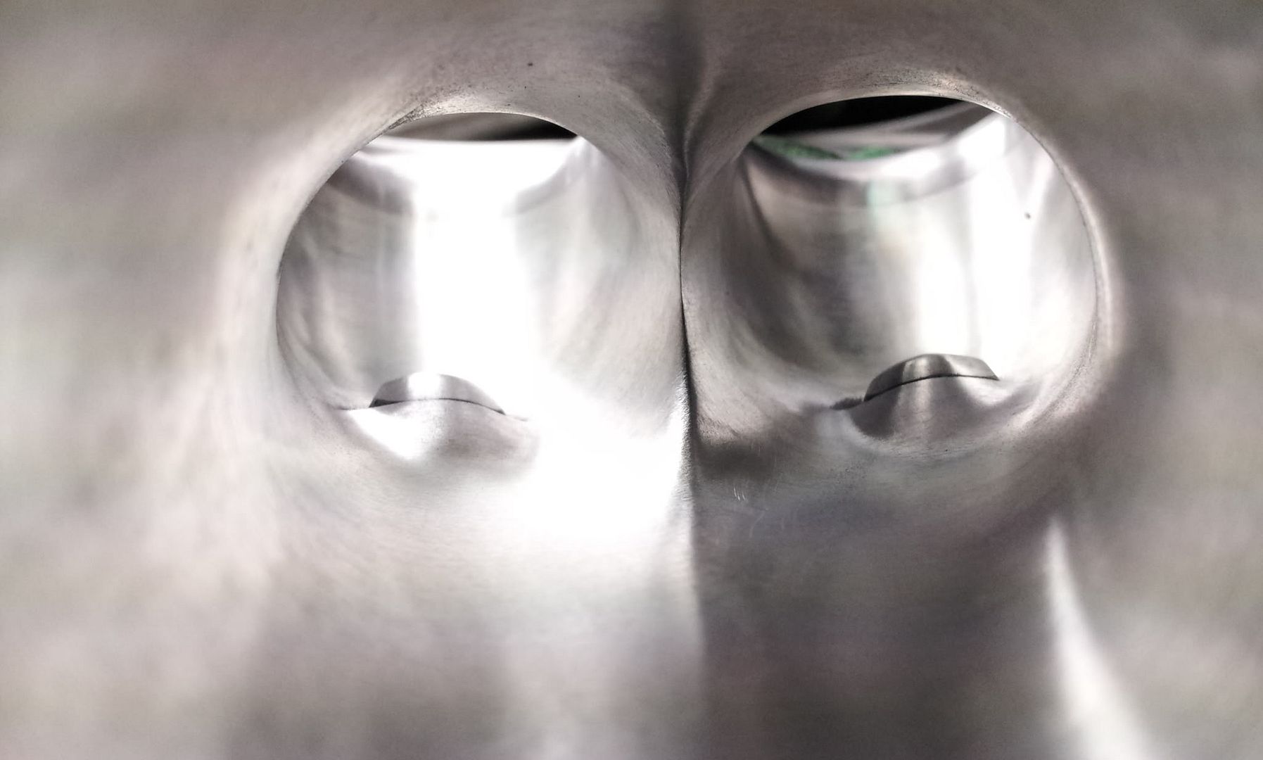

    Progress!
  21. FuJi K
    We gon rev!
    Juks likes this.
  22. Juks
    87
    :devil::devil::devil:
    Amazing work you got there Fuji! Can't wait!
    Block should be at MPS on Tuesday.
  23. Juks
    87
    Borrowed these pics from Fuji. Also, word back from MPS the other day: "yes. I spoke with him a few days ago. He is working on yours. " I'll post those pics as soon as I get the block back.

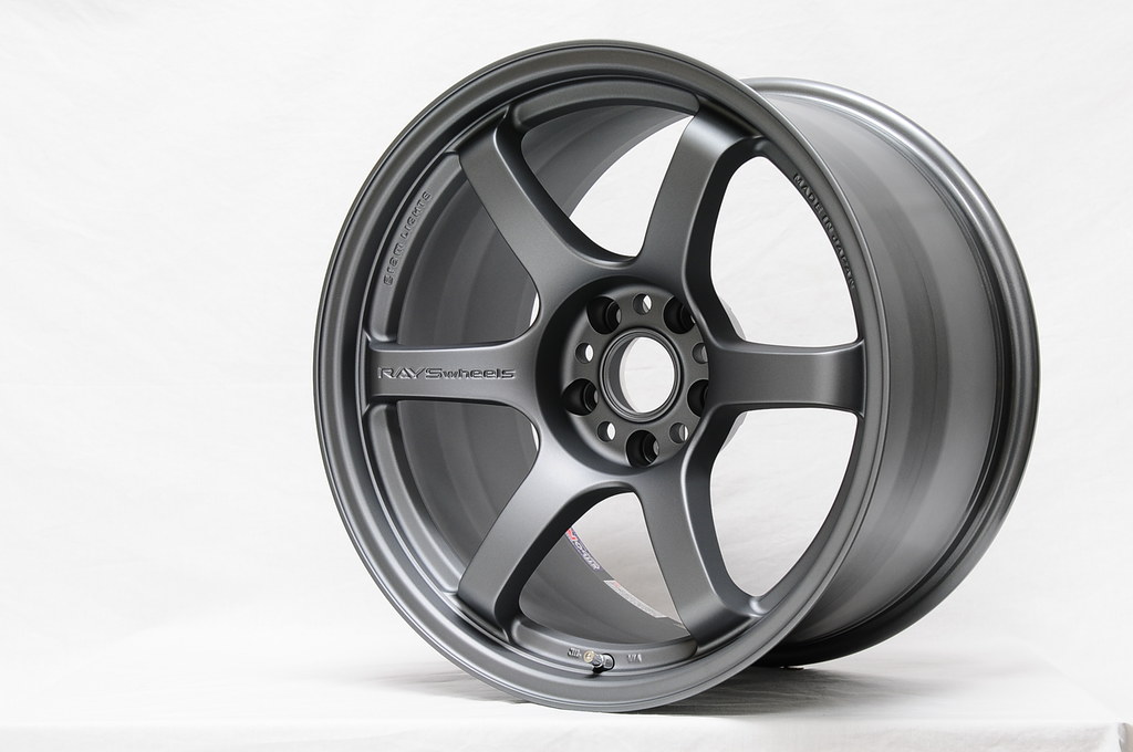

    Here goes nothing: http://t3hclap.com/archives/49
    I need to fit 265's under there with a +38 offset. Goal is only -1 camber for the street since I'll be running pretty soft rubber. I've seen what excessive camber will do to a soft tire... I'll post pics of the carnage for you guys, hopefully I won't have to go too far.
    btw, group buy isn't looking good so I'm going with these in 18x9.5: (+22 shown, I'll have +38)
    Thinking R888's and hoping they last until my "vacation" this summer. I need to get at least one road course day in and one visit to cedar falls or similar as well before I take off.
    FuJi K likes this.
  25. xluben
    I always liked hose those looked! Good luck with the modification.
    FYI - I ran Star Specs at -2.5 deg camber all last season and there wasn't any excessive camber wear. I know the R888's are softer, but it's just a point of reference. I wouldn't be too worried about going a little more than -1 to make them fit.

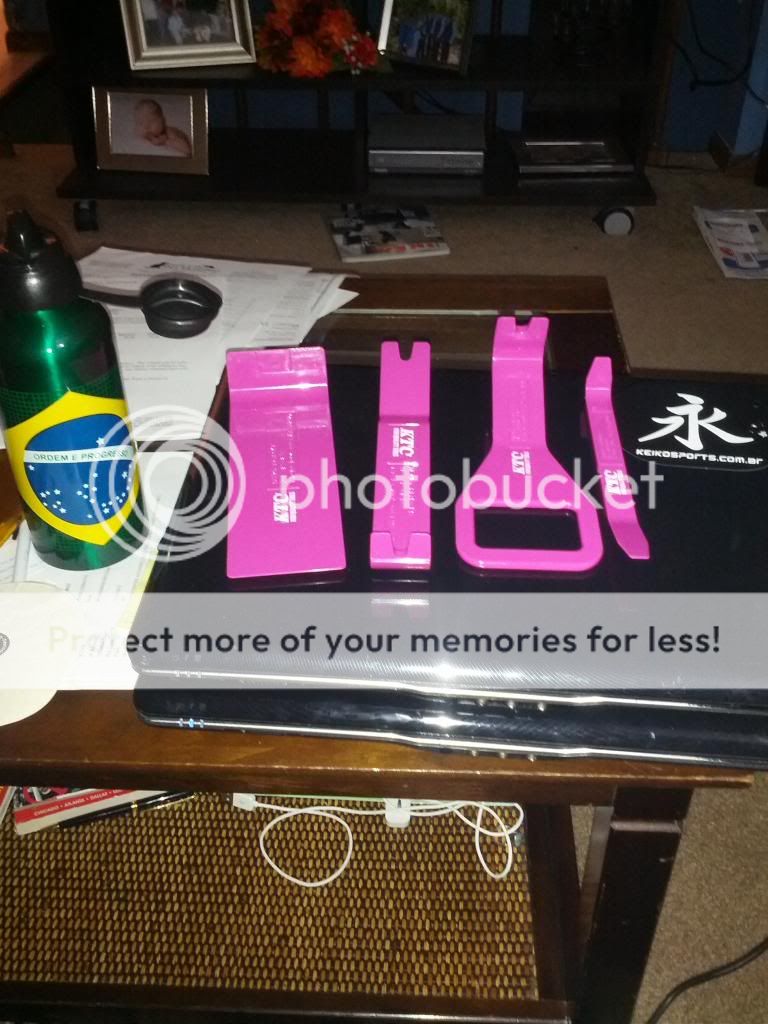

    My first pink tool set...
    Musashi and ofspunk7 like this.
  33. Musashi
    Oh boy and you're in the military lol
    I make bad joke :facepalm:

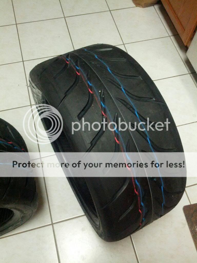

    Damn!
  36. ofspunk7

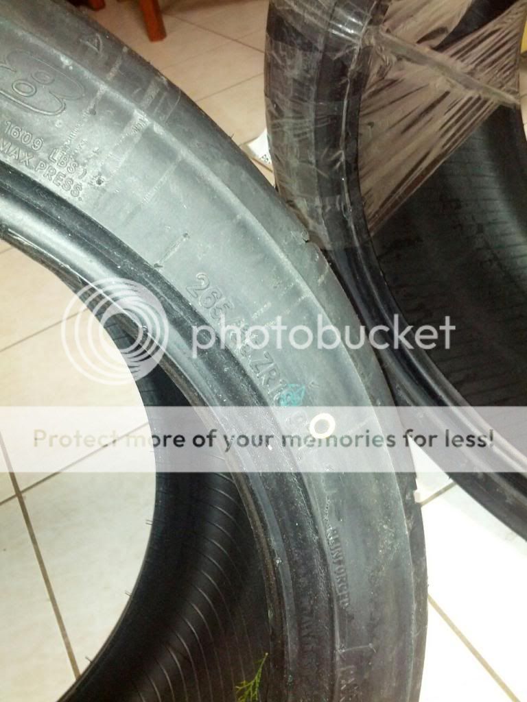

    9.5 or 10?
  37. Juks
    87
    9.5, hopefully this isn't too much of a beast to get under the fenders.

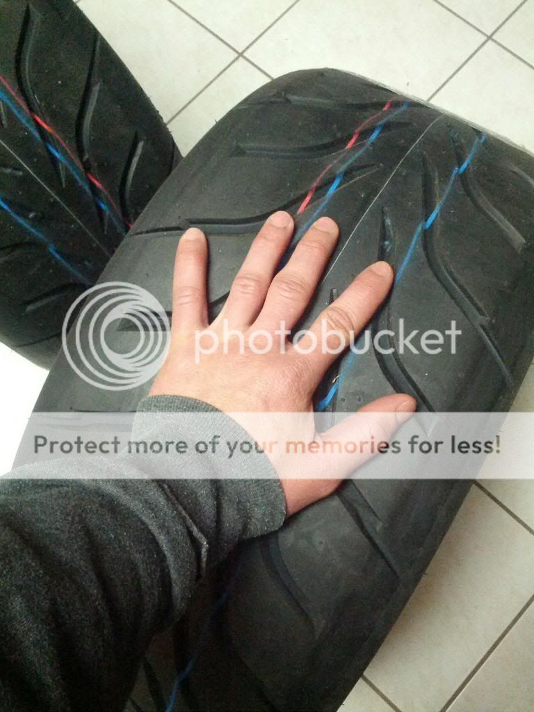

  38. Musashi
    Those are no NBA hands are they lol
    Now you can dump the clutch, load the power and expect less wheel spin, so she thinks lol
  39. Juks
    87
    Almost 10.5" of rubber! That's a lot of meat!
    (that's what she said)
    Yeah I have a feeling I'm going to learn quickly that no matter what tire you use, it still all comes down to driving.

    I stand corrected, tape measure shows a full 11" width for the 265 r888's. Here's what it looks like when I push the tire all the way against the coilover:
    Looks like I have some work to do. I'm not quite sure how much travel I get in the suspension, but that would definitely suck to have the fender tee off on the tire...and hopefully a +38 offset will be enough to keep these things off my coilovers.

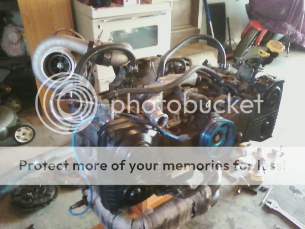

    Here we go!
  43. GiMp
    GiMp Well-Known Member
    297
    168
    Nice can't wait to get mine back
  44. Nuke
    Pimp!
  45. xluben
    Dang, that looks nice.
    I want my car to be fast like this some day!
