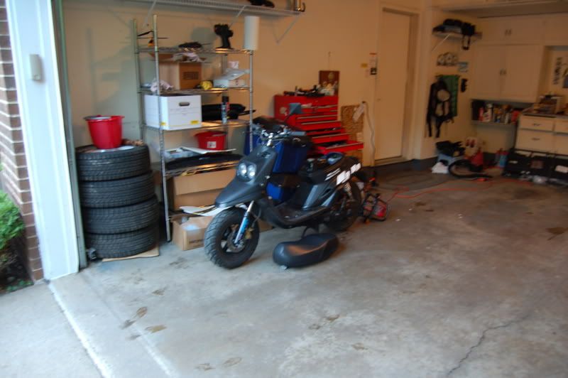

    Zuma Fighter stage one completed (somewhat)
    Apparently the stage one performance stuff is going to be here by friday. Polini 70cc big bore kit, 17.5 mm cab, variator, clutch and Polini super street exhaust. Cant wait to get it all going. I am thinking i am just going to put the pipe and see how much the pipe gives and then i will put the carb and see how that feels. Just to know what each thing does.
  23. Taras
    Taras BANNED
    got all the parts for the scooter! Just put the pipe and the carb with a jet and the thing rips like crazy! Takes off like mad, if i sit a little closer to the back it wheelies! now it goes up to 40 or so and gets there super quick. I still need to put speed variator and the clutch springs and THE BIG BORE KIT!!

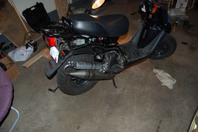

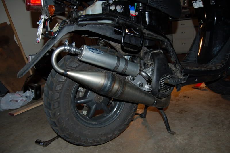

    project zuma fighter is finished( stage número 2) just finished installing the 70cc kit!! I can say it was easier that the turbo inlet hose. All in all it took me a few hours. Here is what is already on the scoot: Polini corsa 70cc kit, polini super sport(not street) exhaust( pretty sure its titanium), 17.5mm carb and jets, speed variator and weights, carbon fiber reeds. Result: amazing speed and crazy acceleration. Now it really pops wheelie like mad, I did not go full speed on it cause i want to break it in first, but I did go past 40 which is the top speed on the spedo.
    Things to come soon: straight cut gears, polini cone filter, set of weights for the variator, motocross steering bar adaptor and the bar!

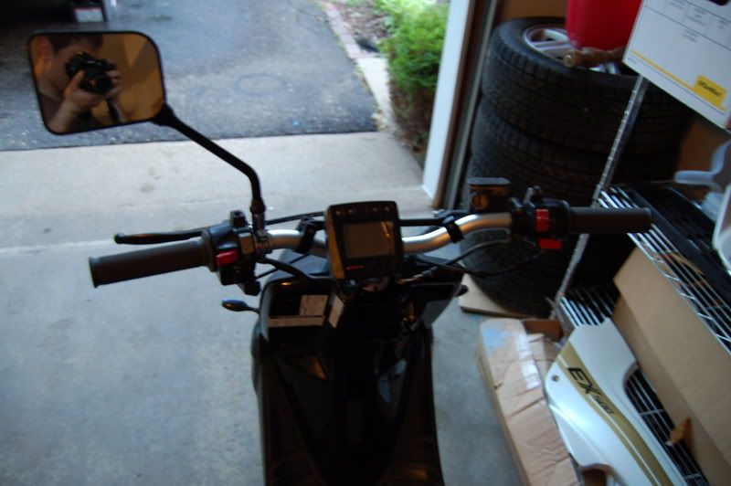

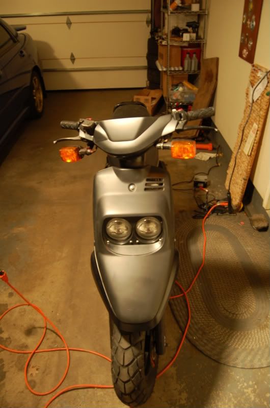

    A little update. So i got a new filter and had to drill out the main jet so i did not have to pull out the choke on wot. Another thing i got was a motorcross steering bar and an adaptor so i got rid of the stock dash and all the rest of the stuff. So the front is even lighter now. Its hard to keep this little thing on the ground when taking of the line.
    Here are a couple crappy pics. It does go 55 and get there very quickly.
    Mods so far:
    Polini 70cc kit
    Polini Pipe
    Polini 17.5mm carb
    Polini Intake filter
    TNT Motocross bar and adapter
    hight and preload adjustable gas filled rear shock
    Koso Dash
    Tuned for low end variator
    Jetted carb
    Led front turn signals and night rider stile rear led bar for taillight and brake.
