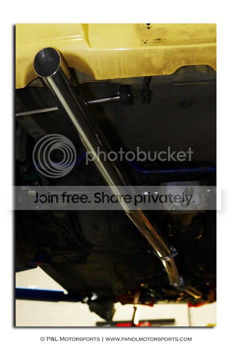

    word, this one is quite sexy:
    Jason, come out to Firestone in the Spring and listen to a few different set-ups both in car and out. Short of being an idiot and buying half a dozen different set-ups (like me), there really isn't a good way to gauge this kind of thing except for in person.
