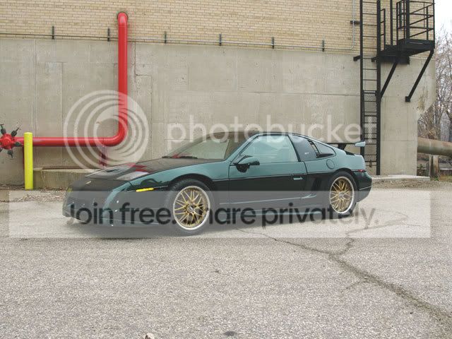

    If this is who I think it is, welcome, and hurry up and get your Fiero out. I love that thing. :biggrin:

    I'll have the Fiero out soon enough... although I think I broke a couple of vacuum lines last fall (it likes to die at stop signs now) that'll have to be taken care of along with replacing one of the quarter window scoops that was destroyed on the road last year (came off & was run over down on Hwy 52). Also, I'm hoping to get the V8 swap started (at least get the engine torn down & rebuilt) this year... but my wife's daily-driver is definitely going to be a priority for at least a little while longer.
