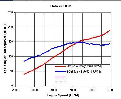

    Well I got my stage 1 tune from Bullwinkle today, and here is my dyno sheet. We were both curious to see comparisons to a Dyno Dynamics, (AKA Heart Breaker dyno)

    Nate's Road dyno:
    I'll be updating this first post with more info eventually

    I also think something is off with his road dyno posted above. The pull started a little early on my usual tuning spot, so the first 500-600 RPM were more uphill then flat, so this probably brought torque down a bit.
    Although admittedly, the logic was just added to do AT's on the road dyno (uses vehicle speed and gear ratios to calc torque), so I didn't have many numbers to compare to. I did use quite a bit of smoothing to keep the top end in check, so that maybe removed the mid-range torque spike usually associated with AT's. Anyway, peak HP is about right what I expected, though.

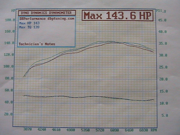

    Well I put down 143 HP and 139 TQ on the Dyno Dynamics yesterday. I will put up my charts as soon as I get a chance

    Yikes, quite the heartbreaker for sure. I guess I'll see when you post up the run, but did he rev it out all the way to 7000?

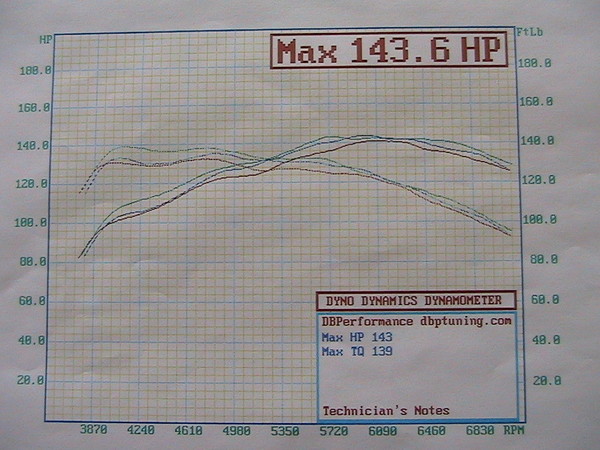

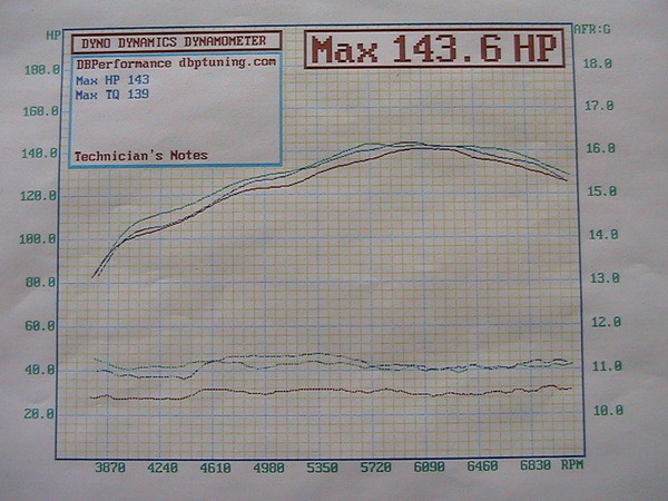

    Ok, the cable guy just left and I got my intronets back.
    Here it is...:(

    Curves look good, numbers...not so much :(.
    Looks like the road dyno is a little skewed on the top end, upping peak HP significantly.

    Auto subies give really weird numbers on dyno's. My RS made 112 whp but it keeps up with other NA subies that dyno around 130.
    I'd say nates graph is more accurate and that your tranny is just playing tricks on the dyno.

    Yeah, the auto really robs power. That specific road dyno run is obviously off on the top end (as you can kind of tell with HP peaking at redline).
    The midrange torque really wasn't there, and it was down on power from what I kind of expected. His BCS and wastegate was also only holding around ~14 PSI of boost throughout the range, which limited power and torque significantly. And yeah, so does stock exhaust.
