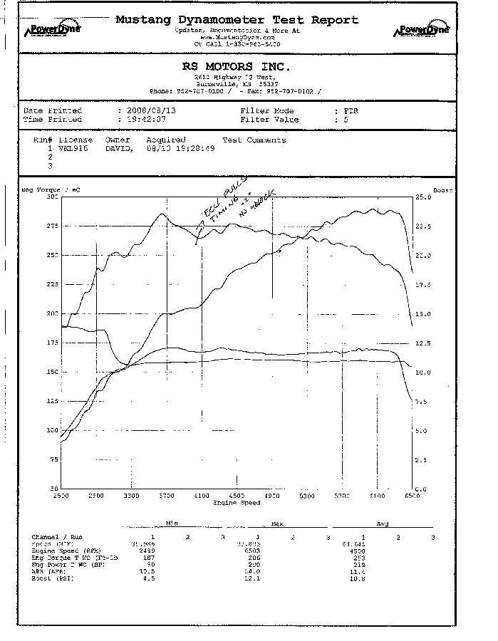

    WELL, I scanned a copy of the graph....
    but I can't get it on here in jpeg format, only pdf.... cause I'm so good at that stuff....

    so what you are saying is that since it would taper off anywho, the only real benifit of going for higher boost on a vf39 is the mid range powers?
    So this is why my graph seems so peaky on the hp side?
    So this is why it seems so flat on the tq side?
    and you are saying that it is possable?
  25. Bullwinkle
    Bullwinkle Well-Known Member
    Well, to an extent. Torque and HP are related. If you have more torque in the midrange, you have more HP at that spot in the RPM band. Thus, the higher your torque is throughout the RPM band, the faster the car will be, as it is accelerating faster throughout the RPM band.
    Not sure what you mean by this. HP always looks similar to your graph. Aside from that mess at 3.5k, your torque curve is relatively flat, so that means your HP curve will be fairly close to linear.
    Your torque is flat because your boost is flat. On our cars, the torque curve typically mimicks the boost curve.
  26. Bullwinkle
    Yeah, looks like there's certainly had some trouble at peak torque there.
    Ronnie, how much timing were you running through that area?
  27. putz
    putz Well-Known Member
    do you think that might be over boost? If the target boost was 12 psi... then it could be?
    it looks like that is also where I peak for boost.

  32. aspiringRexer
    aspiringRexer Member
    +1. Bullwinkle here tuned me to 1.0 IAM across the board, car adding 6 degrees every place it could, and I'm boosting to 20psi at 3.4k on 92 octane. With those mods, I'm surprised you're not hitting 20+ and holding it until at least 4.5k before you taper to 18 and then ~14.
    btw, Bullwinkle, your tune is genius.
    If you're holding 12psi at 8k on a 2.5l, that'd easily be 290+whp. What he's missing is the insane 330+ torques that the VF39 can blow at 3.5k.
    I'd say we're even at whp (I think RomRaider pegged me at 285), but with all that boost left on the table (me at 20psi, you at ~13) I'm running 70-80 more torques than you in the midrange. And torque is what you feel, the fun stuff.
    And this is with stock fueling system (+walbro), stock UP, stock STi catback, STi TMIC. I'm running far far less mods and yet have a super-safe tune. "What gives?" is my question.
    In regards to the 3200 timing pull: I'm sure mine would do something similar if I was at that load at that RPM, but because I'm +5 psi, I'm running waay less timing due to more boost and therefore have the ECU pulling no timing. Perhaps increasing the boost will cure all your timing issues???omg??

  36. Scuba Steve
    Quick newb question here, but why is your AFR at 14:1 @ 6500? SHould it be in the 11 range?
  37. webcrawlr
    webcrawlr Well-Known Member
    The graph cuts out before 6500. ;)
