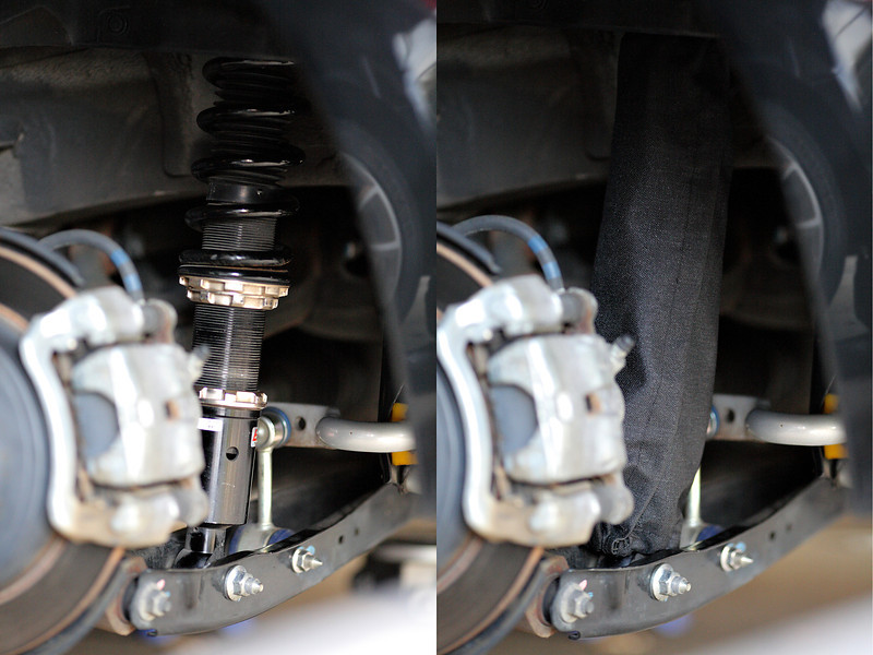

  20. xluben
    3,937
    Here's a shot of the covers that my mom made me :)
    They were some kind of waterproof, tear resistant fabric. Held on with zip ties at the top and bottom and velcro down the side. I only used them in the winter. They did a great job keeping dirt/salt off the coilovers. They looked completely clean when I took them off.

    What kind of fabric? That's exactly what I'm envisioning.
  24. xluben
    3,937
    I'm not sure. My mom bought it online. It is waterproof and seems very strong.
  25. idget
    9,508
    falcon heights
    It's a mix of carbon kevlar, unobtainium, and cotton.
    No, there are a lot of durable waterproof fabrics out there. I imagine a canvas material with a poly coat would work well for this application (like an outdoor car cover or rag top material used on many convertibles).

  26. qstarin
    qstarin Well-Known Member
    1,913
    Uptown Mpls
    Thanks, I'm trying to figure out what to send the ol' lady looking for in the fabric shop. ;)
