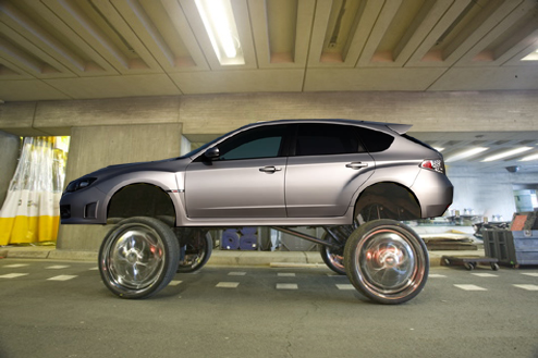

    damn, paint looks good! Can't wait to see it in person. I bet I have a flashback to 2001 when we first got a glimpse of an MBP bugeye. I also love the shaved keyhole.
    Also, this is the perfect opportunity to replace the rear glass with a giant outward facing lcd monitor, wire in a switch for a back-up camera, and confuse the hell out of tailgaters.
