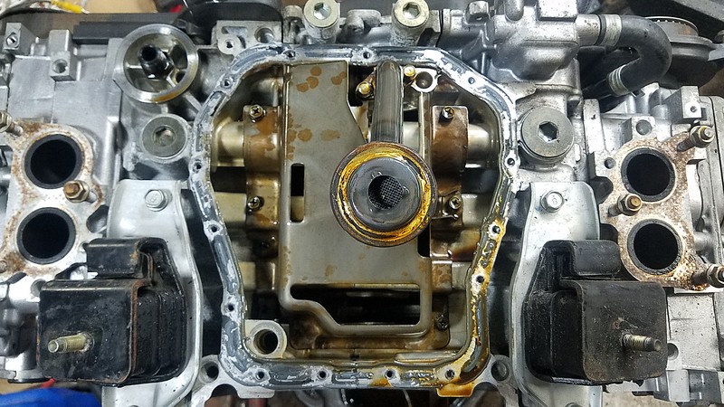

    JDM EJ20. A lot of parts have to be swapped over to use this, so I started the teardown last night. Internals are very clean, and no sign of head gasket seepage
    20210608_223013
    by Numbchux, on Flickr
    I have a new timing set, lots of engine gaskets, spark plugs, radiator, etc. to go in.

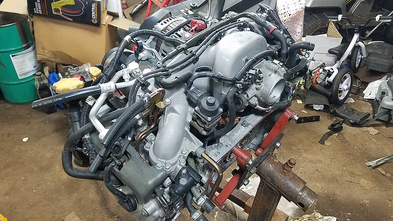

  8. Chux
    1,492
    A couple hours a night during the week last week got the intake and oil pans swapped, new plugs, valve cover gaskets, Mitsuboshi timing belt, NSK idlers and Aisin tensioner, swapped the crank and LH cam sprocket.
    Then, I spent most of yesterday in the garage. New transmission cooler hoses, new fuel filter, new radiator and hoses.
    Here's about where I ended.
    Not an inch of exhaust on it, which was super annoying, so I didn't run it very much. But I got out my testing kit and pressurized the cooling system, to find the bypass hose from the water pump to heater pipe has a nick in it, so I'll have to grab a new one.
    Started harvesting the exhaust off the '00, hoping to put that all together tonight. I need to get my mom's 2012 Impreza into the garage tomorrow to pull the valve body, so I can swap the Lock up Solenoid and she can return her rental Kia by Friday.

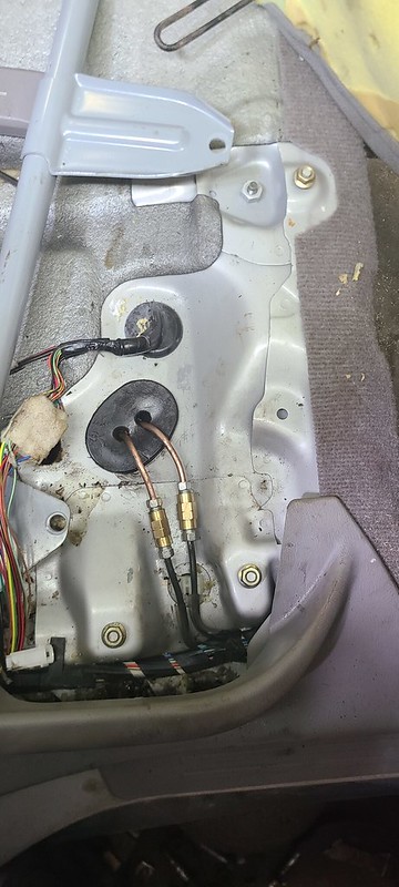

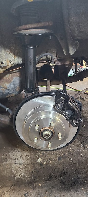

    After the last test drive, I noticed a leak in the RR corner. In replacing the struts, I moved the brake hoses around a little, and the steel line broke. And so....the snowball began to roll....
    The brakes were a complete rusty mess from sitting. So I decided to do the rear disc swap from the '00 that I've got. BUT, the parking brakes on it were locked on (I had to cut the rotors off), and THE BOLT in the rear suspension was seized. So I started ordering new parts. Dorman backing plates, Timken bearings, OEM seals, Dorman suspension bolt, Altrom lateral link bushings, etc. etc. Someone had been into the LR knuckle before, and put a new backing plate and bearing in it, but they left out the ABS tone ring! So, after a considerable fight with the rusty parts car, I managed to get that out. A couple chunks of NiCopp brake line, and I spliced those in where the lines were good under the rear seat, and used stainless flare nuts outside.
    [​IMG]20210805_221408 by Numbchux, on Flickr
    New Centric rotors. Donor car had good pads, and one good caliper, so I got another reman caliper, and painted both.
    So much better!
    [​IMG]20210808_115409 by Numbchux, on Flickr
    I need to pick up a new bleeder screw, and then I should be able to finish assembling, and start driving it!

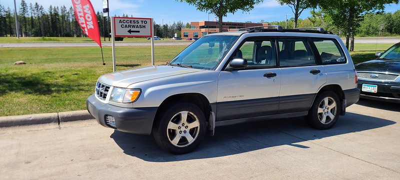

    Drove it to work today. Needs many small things, but it drives very nice. It's no hot rod, but the 2.0 does just fine.
    [​IMG]2021-08-25_02-19-59 by Numbchux, on Flickr

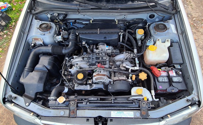

    Finally put the last piece in the engine bay (battery tie down) and took a picture the other day.
    2021-10-01_02-32-39

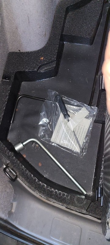

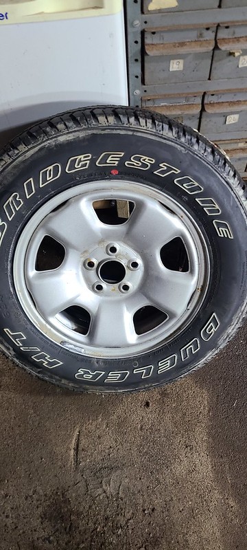

    Drove it out of town over the weekend, so I thought I'd check on the spare tire. F'n mint original spare (date coded mid-2000), lug wrench and unopened roof rack tool.
    [​IMG]20211001_191821 by Numbchux, on Flickr
    [​IMG]20211001_191937 by Numbchux, on Flickr

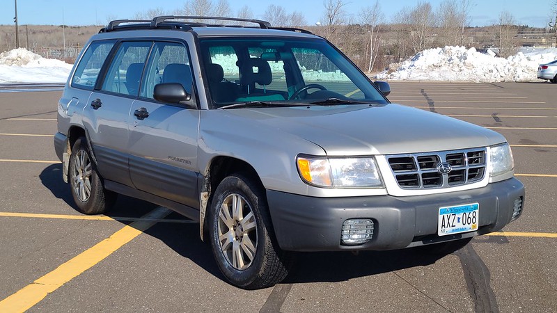

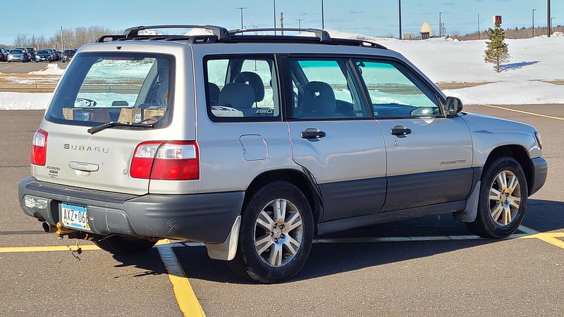

    I tried a couple times with this. But being that the Forester has air assisted injectors, I could not get the 2.0 injectors to fit and seal correctly. I ended up swapping back. So far, the code has not come back....
    It was on the back burner most of the winter. But one of my wife's coworkers asked to buy it, so I put some nicer tires on it, and cleaned it up.
    20220326_161411
    20220326_161537

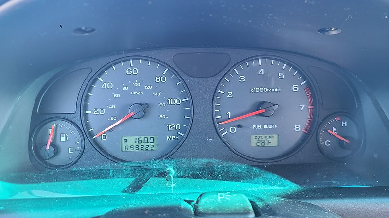

    Still has a "0" in the first digit. Crazy. And it drives so nicely. But it was a very good offer....
    20220326_161919
