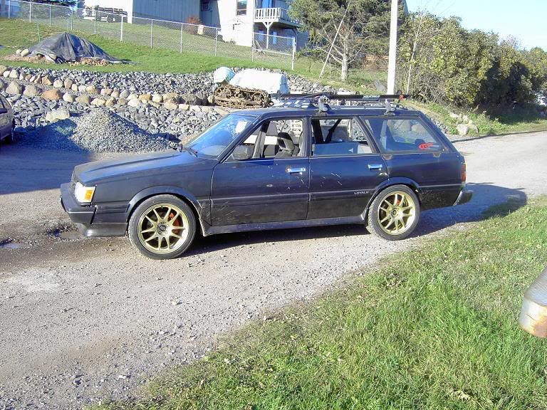

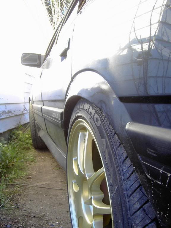

    w00t! 215/45r17 Kumho Ecsta's on 17x8 Gold Rota Torques:
    glad I didn't get the tires any wider!
  16. Dynapar
    ^ that last pic is hawt.
    It looks like the front wheels sit farther forward. (like the rear wheels on the blue wagon). eitherway it looks awesome. This thing is so awesome now. 17" goldies, uber stiff springs, and Borla headers.
    becareful not to curb those wheels now.
  17. Deride
    I STILL can't stop staring at those wheels. They look AMAZING on that car.
  18. TSTRBOY2004
    ^^^^ yeah... even more amazing is Chux adding bling factor... we may convert him a little yet... ha ha
    Looking good man...
  19. Grayguy
    Grayguy Well-Known Member
    I saw you twice last night, and they look absolutely badass! way to go chux!
