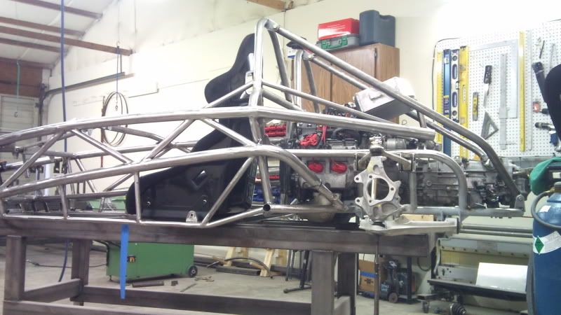

  21. thebionicman
    thebionicman Well-Known Member
    Been a little while since an update. My frame is on the build table with the Subaru motor. Got most of the parts secured for the conversion over to the WRX ECM, just need an ECM and harness.
    Prototype roller
    Getting the mounts for the Subaru motor
    Jigged up with the Subaru motor
    EricS likes this.

  25. thebionicman
    I have the locking sleeve from Bremer/Saker in my garage. This engine/transmission is from a Sti V5 RA, it has the front limited slip in it. We are definately on the same page!

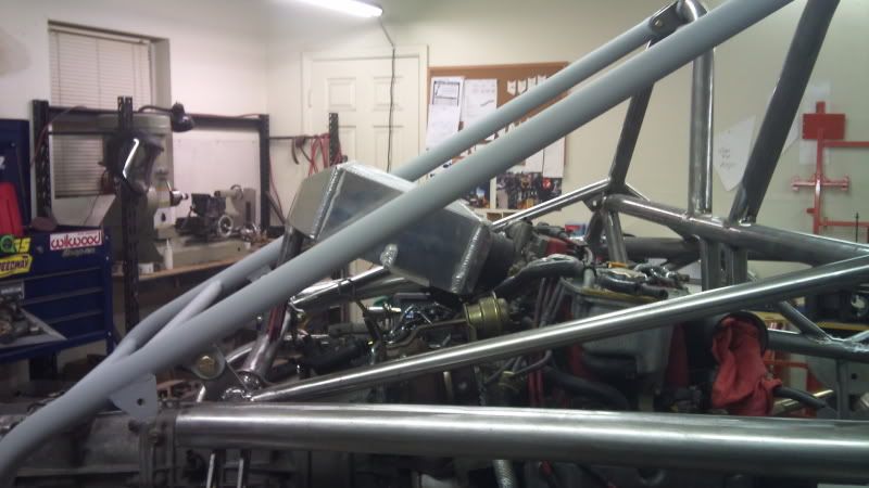

  44. thebionicman
    Builder had to adjust the down supports to fit the intercooler.
